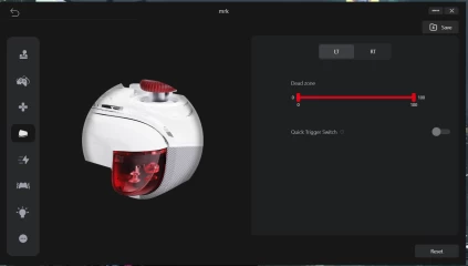

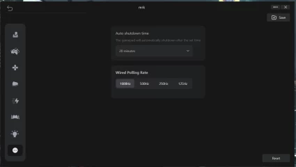

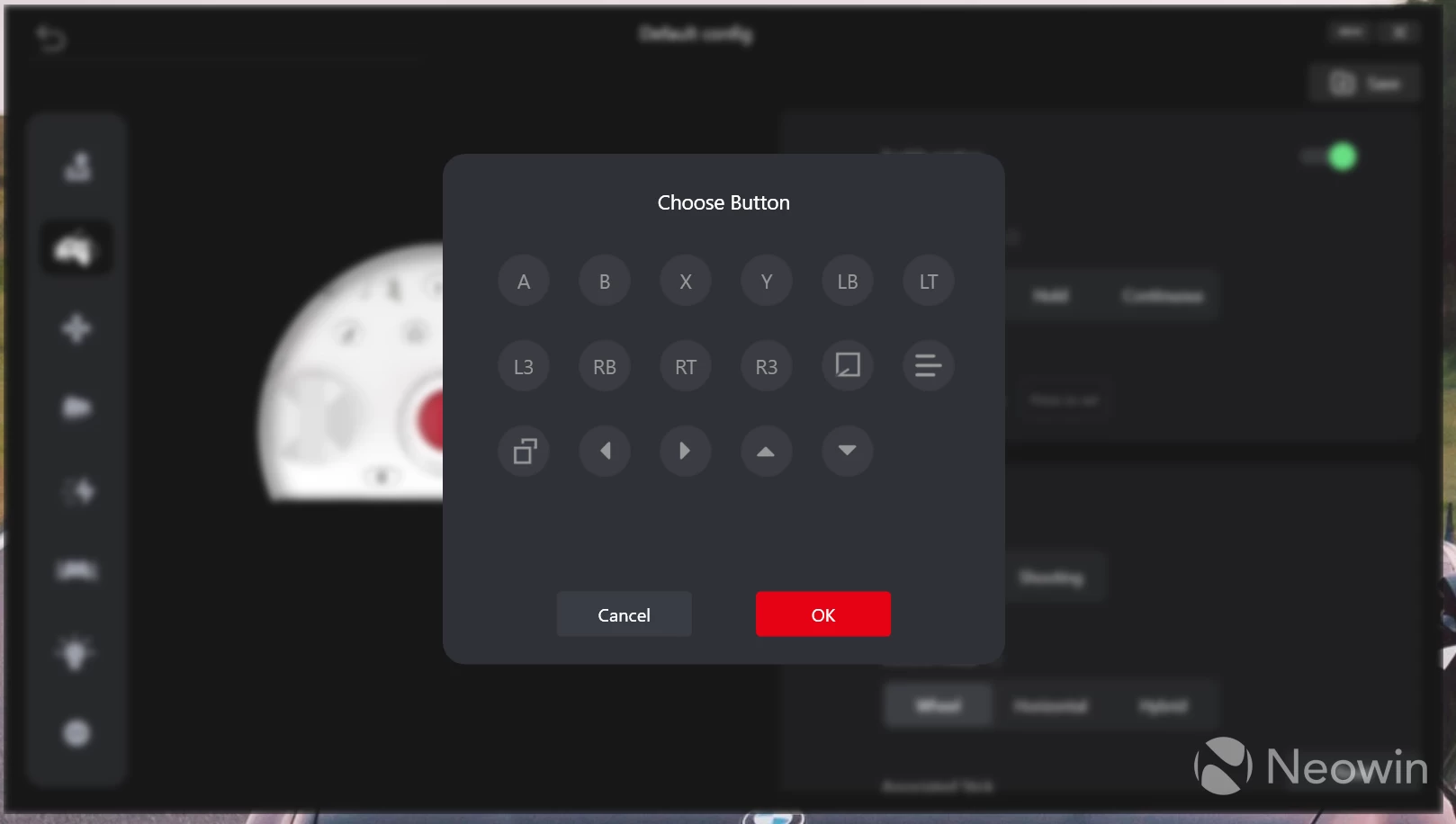

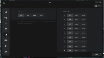

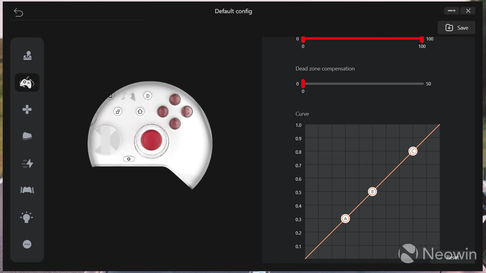

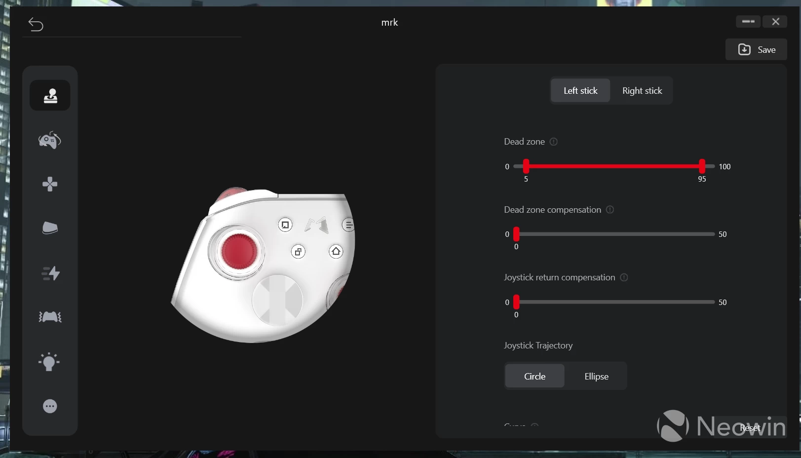

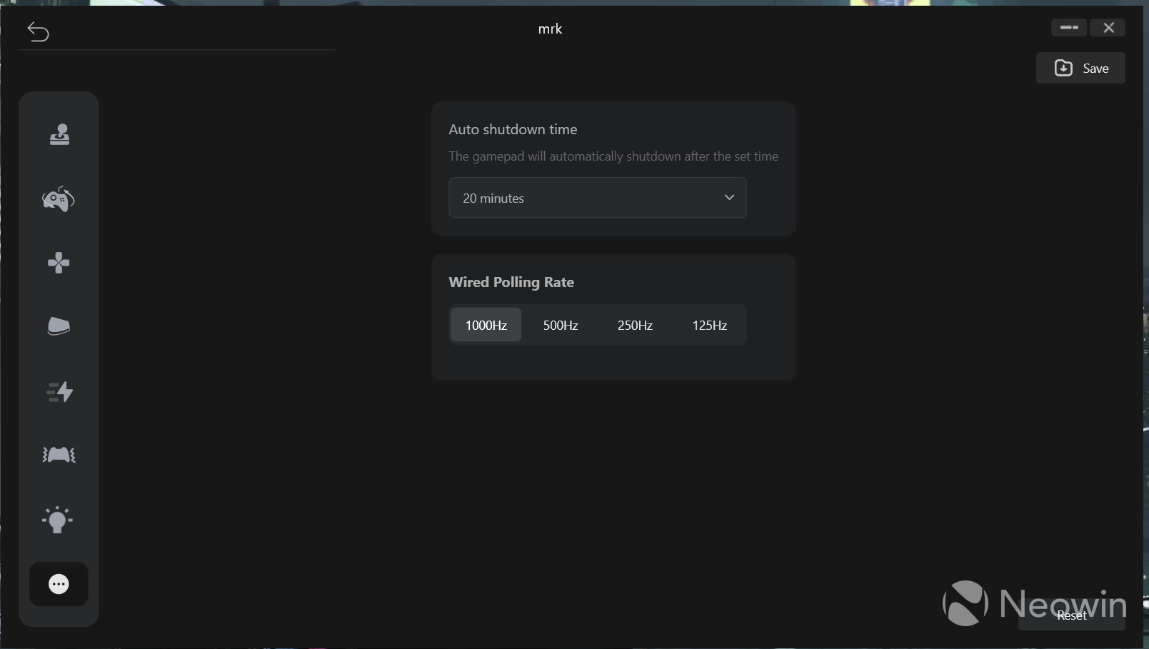

Software

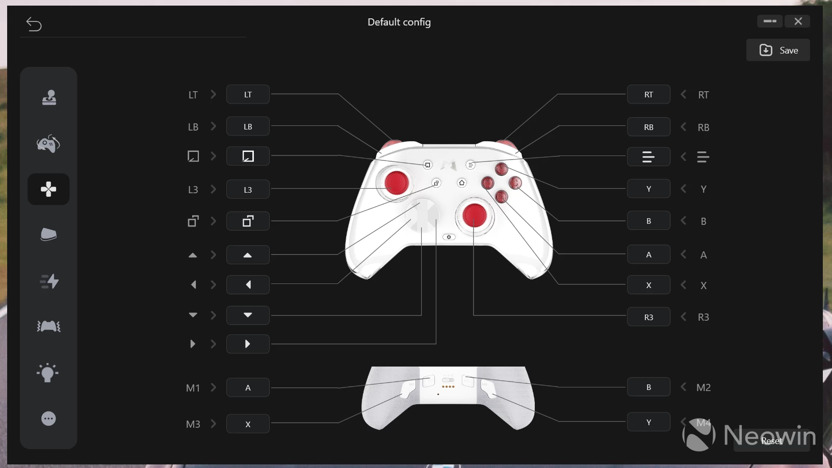

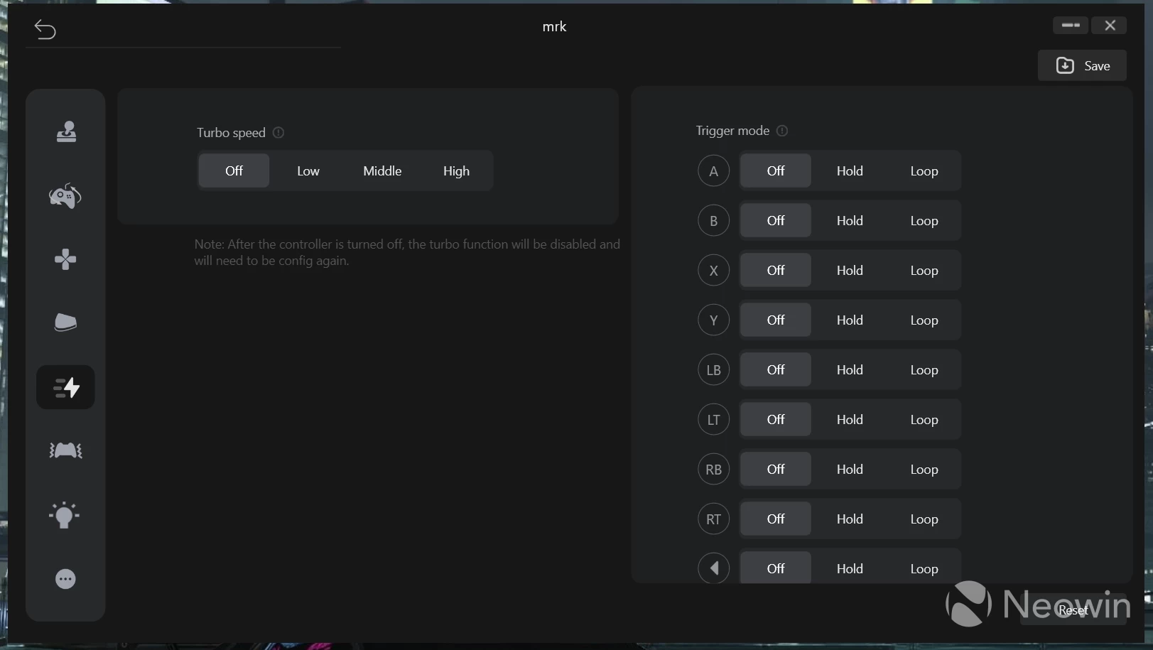

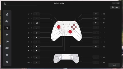

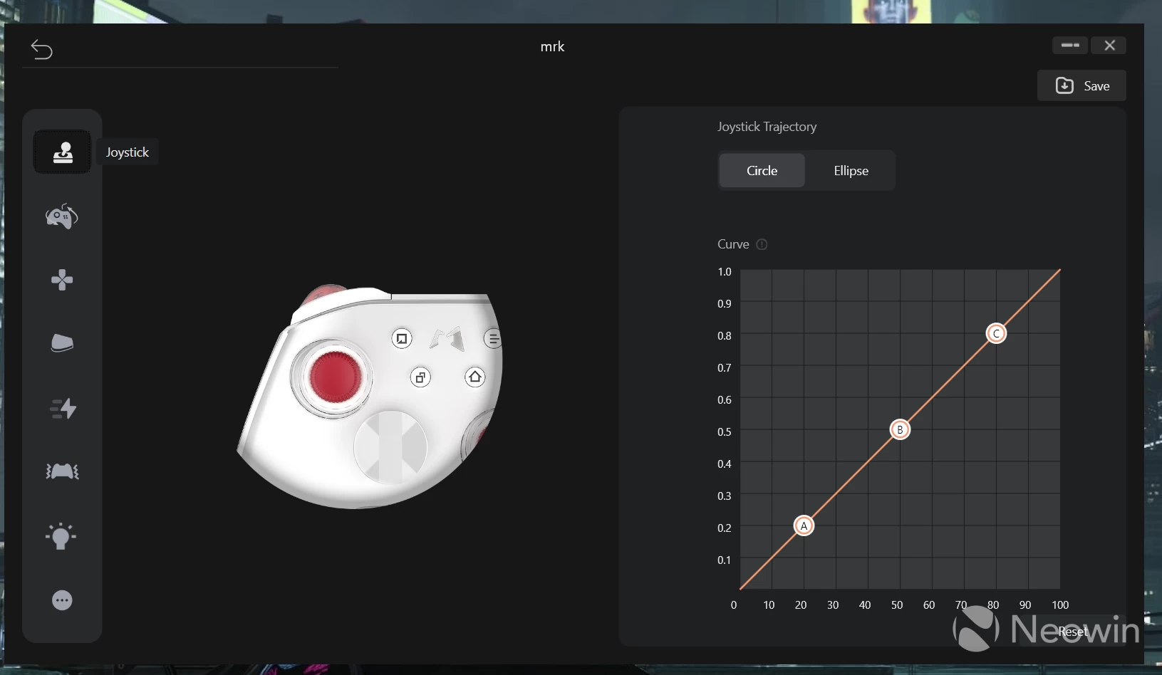

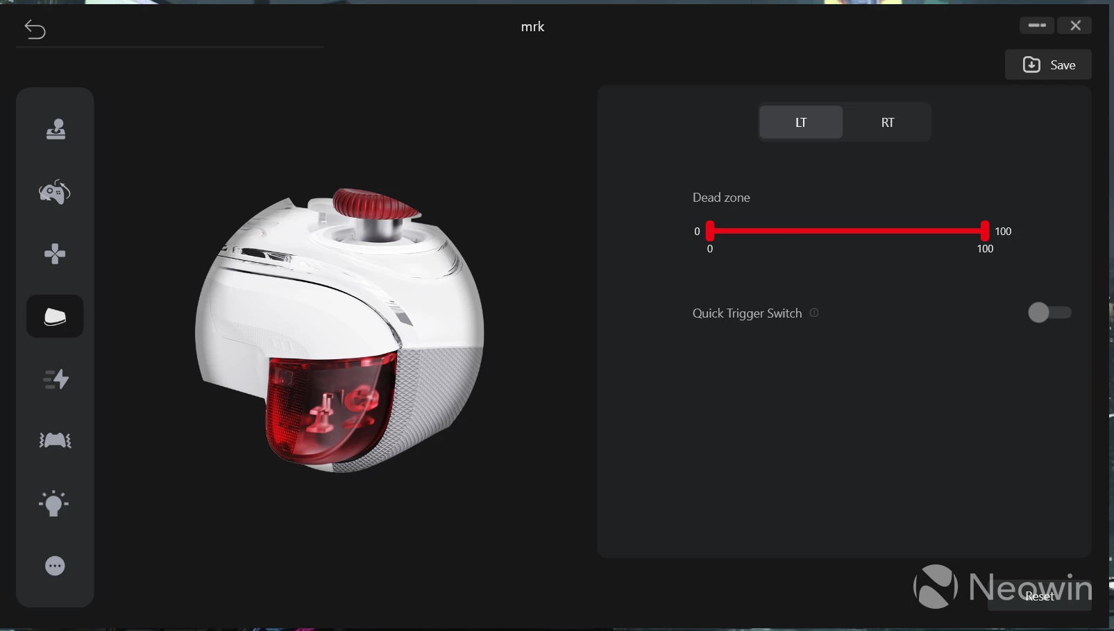

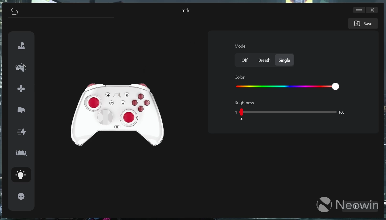

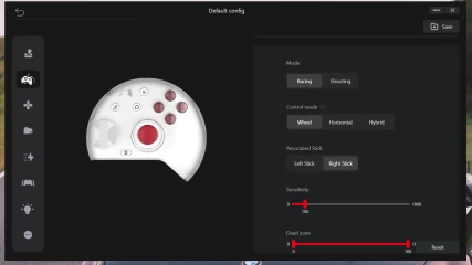

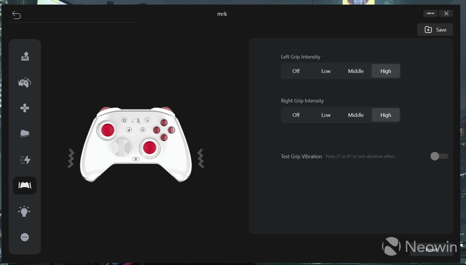

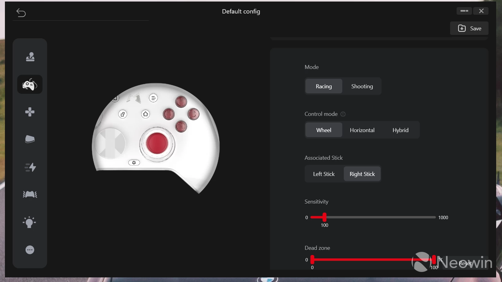

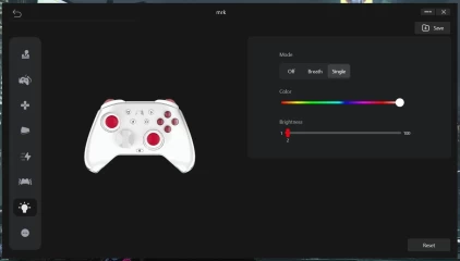

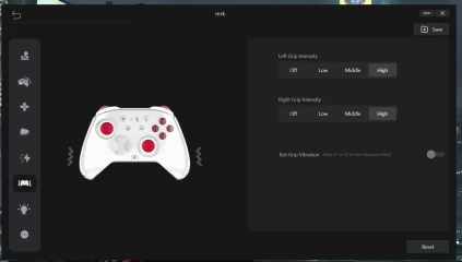

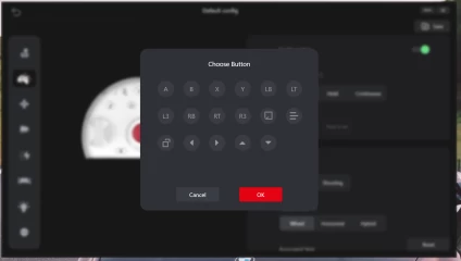

Configuration options are limited on the controller directly, so the phone or desktop app must be used to tweak things to preference. Mobapad's app is laid out nicely and I found no issues with connectivity, even over wireless on Windows.
Here is a look at all of the tabs within it:
The desktop app can be found on the Windows Store, or by searching Mobapad in your phone's app store.

It is a shame that the Huben2 cannot remap the back buttons to keyboard buttons on PC, GameSir allows this in all recent releases from the past year, customisations are saved directly onto the controller so remaps are usable on other computers.
The Huben2 only allows remapping the four back buttons to existing face buttons, and in my opinion, this is quite pointless. I never quite understood why this was so common with brands when these are PC controllers primarily.
