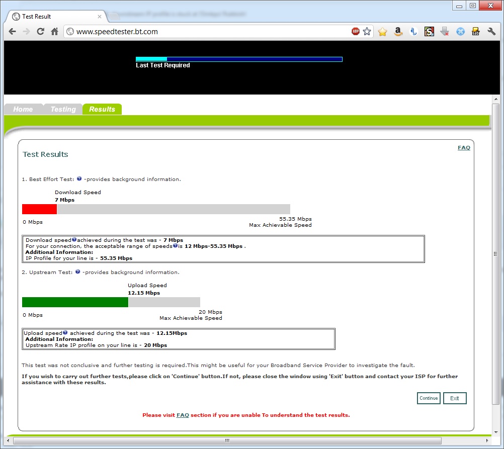

It gave me something like 40mbit down but the max ip profile is set at 55... that's lower than when I initially upgraded. I imagine it's something to do with dynamic line management and the fact my line is most likely made of aluminium - the max achievable speed that they've "determined" for my line is 55mbit.
Just checked again - ignore the download speed that's a load of rubbish. But you'll notice the line is capped off at 55:
post-33944-0-84782000-1335197033_thumb.j
Might call BT and query it... not sure if it'll do any good though.
