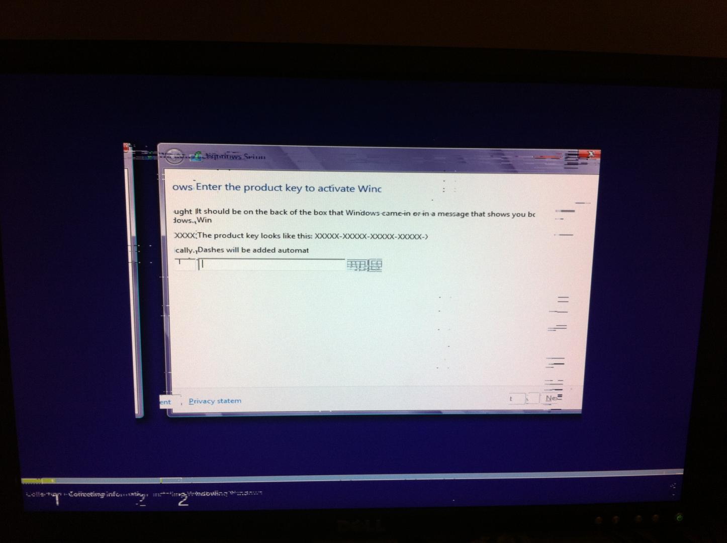

I'm trying to install RTM on my desktop and I'm running into graphical issues.
During the install there were graphical glitches.
post-25418-0-28568300-1347094238_thumb.j
I managed to work my way through the install however when the machine rebooted neither of my displays are switching on.

I doubt it's a hardware problem as I had Win 7 running with no problems about 30 minutes before I tried to install Win 8.
I could probably get into the advanced options but the screen corruption happens during setup making reading anything quite difficult.

I did wing it through the setup, I have it installed. Problem is when I try and start it, either normally or in safe mode the displays don't work so I can't get in to install the drivers.

Yeah, I have dual monitors. I'll try booting with only one in and see if that works.
If it doesn't, try reinstalling 8 with only 1 monitor plugged in, it could be that it has bugged out and sent the combined resolution to each display, or refresh rate is messed up etc

Tried installing with only one monitor in. Exactly the same as having two in. Graphic glitches during install and after the first reboot the screen goes blank after the windows symbol shows on the screen.

8 must be installing a driver that your card doesn't like, can't really think of a way around it unless you can make a custom 8 install disk with the new nVidia drivers in it, or get to the desktop and install the new drivers without using the monitor

Had a little Google, seems like Microsoft made a mistake with the RTM which affects some nVidia cards, guess I have one of those cards.
As my mobo doesn't have onboard graphics I've guess I'm out of luck for getting this installed.
