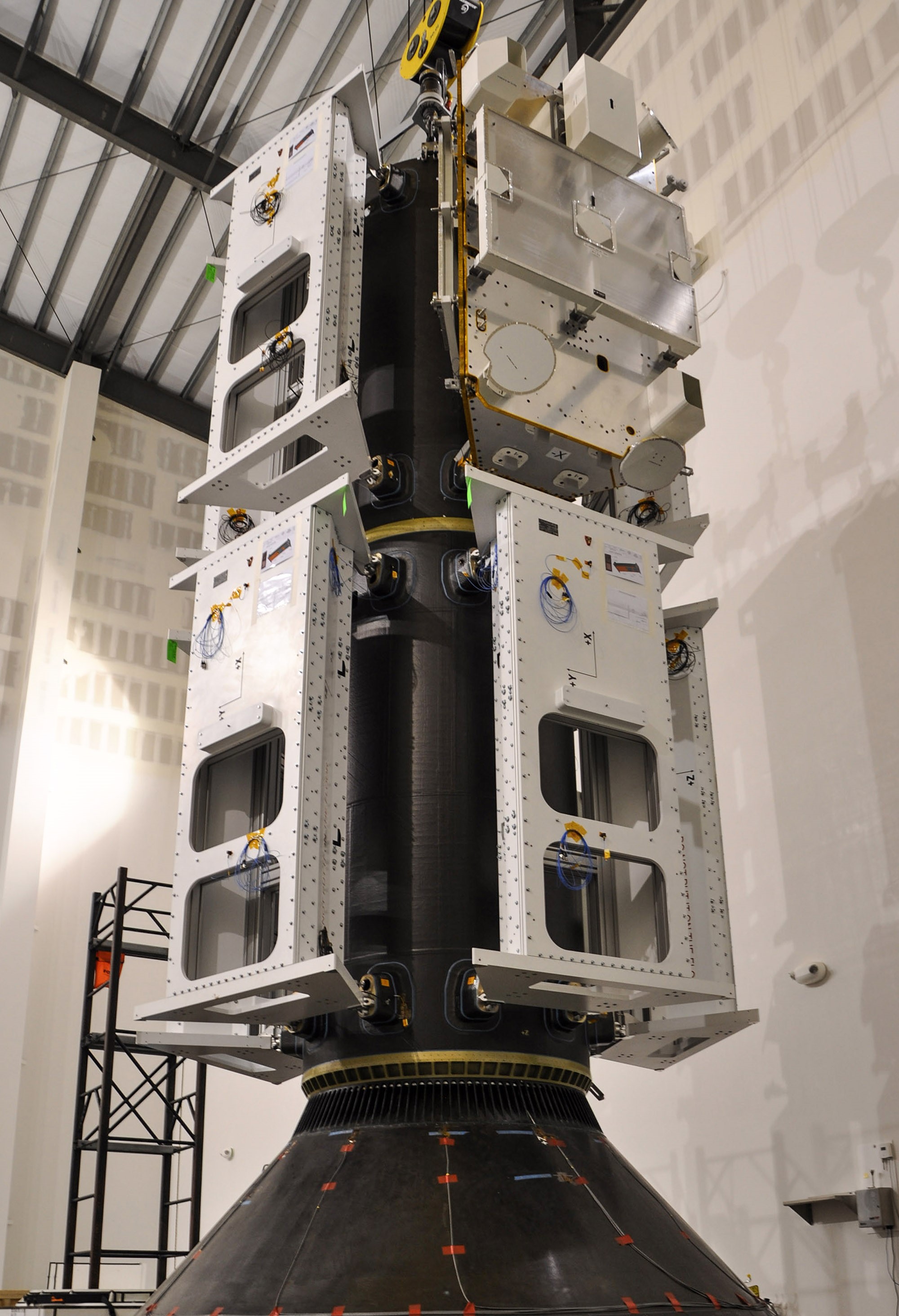

After them I believe Vandenberg is up with Iridium Next #1 (of 7 launches, 70 birds total) using SpaceX's all new multi-satellite dispenser. This dispenser will likely be used to launch the 4,000+ satellite SpaceX orbital internet backbone.
