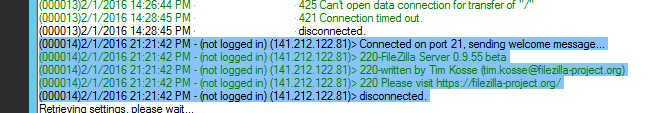

So, I recently setup an FTP Server on my home network. I'm doing some messing around with programming and working on a updater for a friends game server.
Well, this happened. Someone care to explain why the heck the University of Michigan is accessing my network?

I've editted out my IP Address / Login Credentials. But here's a log of it.
unauthorized_access_editted.thumb.png.d9
I'm way lost on this. Frankly, it bothers me a fair bit that it happened, I'm just not too sure how concerned I should be.

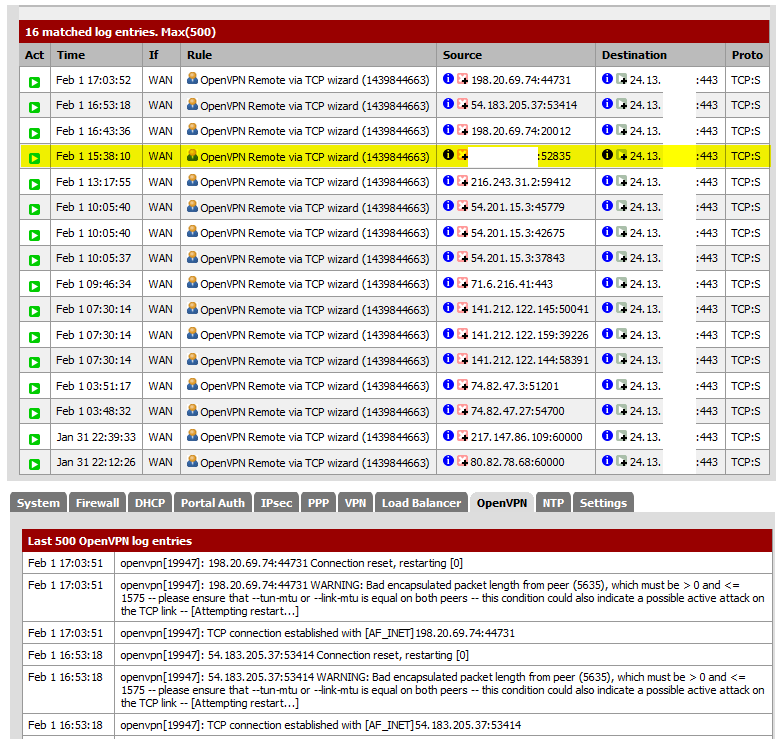

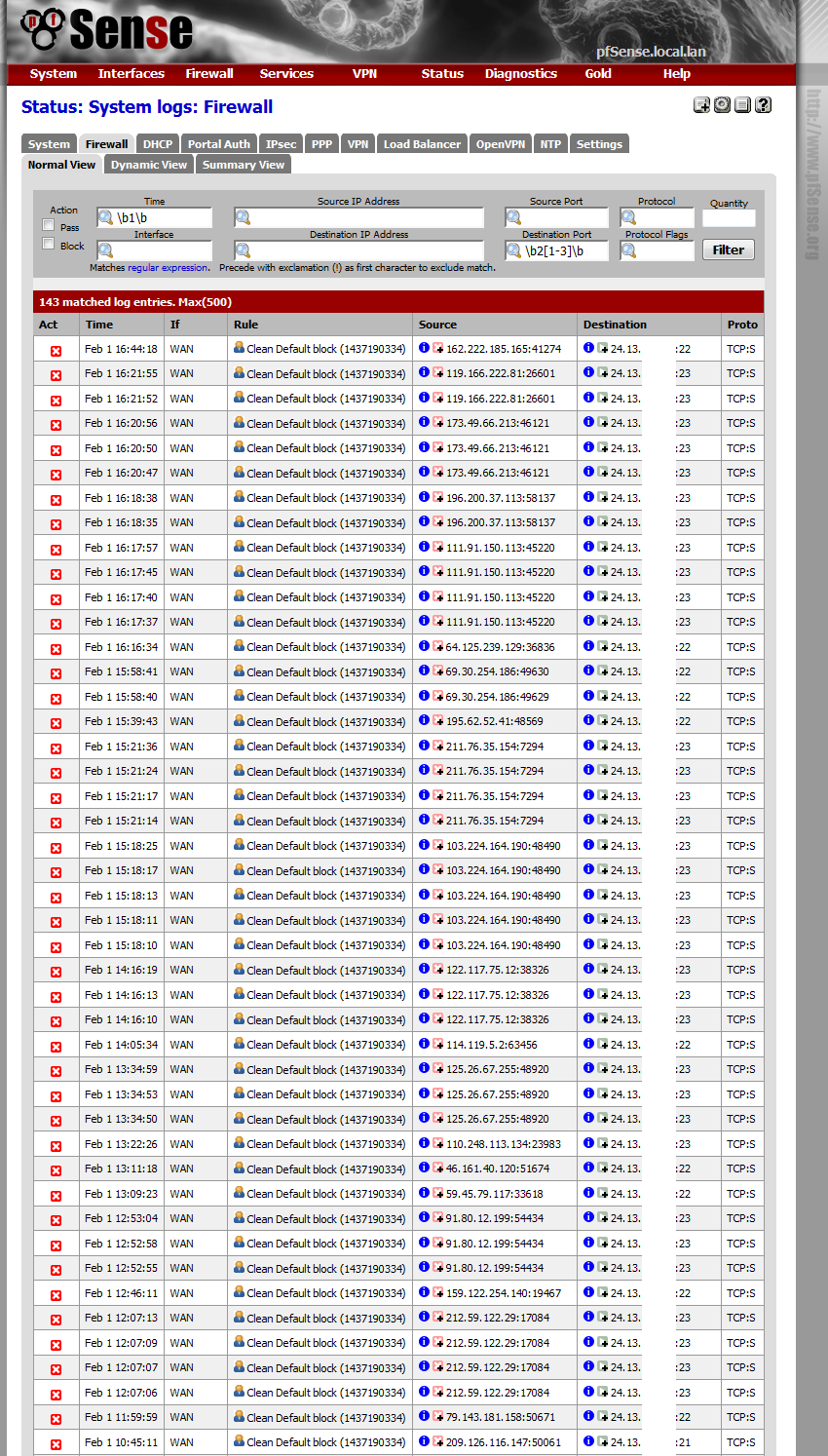

So could just block the whole /16, they might have more networks..  But you can for sure see from the whois that they do own the whole /16
As also mentioned your going to see lots of traffic to 21, 22 (ssh) and telnet (23) are other common ones.  So as you see lots noise.  Here just today for those 3 common ports I see 143 hits sofar today..  I snipped it, but you see from all over the place..  Just noise your firewall should just drop them.
noise.thumb.png.917143b62d18e340aabc6543
So when you open up a service like ftp that is so common, its best to filter who can hit it, since you have a known source - I would lock down the rule to your buddies IP.  Changing the ports not security, but could lower the log noise..  But lack of traffic in your logs might give you a false sense of security, as sc302 mentions obscurity is not security.  Depending on your firewall and ftp server software you can block IPs after so many failed attempts.

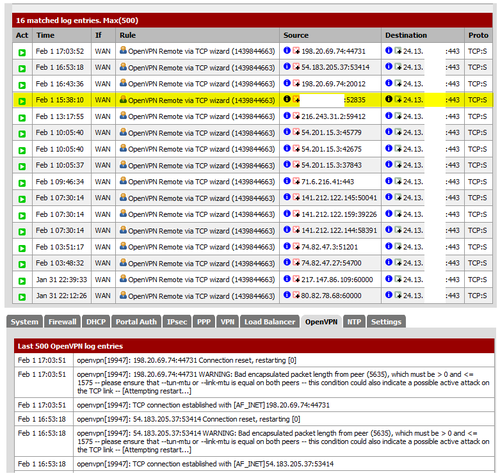

I don't allow anything into my network other than vpn, and serve up ntp to the pool.. But as you can see there are hits to my vpn port since I run it on 443 tcp so I know if there is internet where I am at I can get too it.  So you see firewall lets in all that traffic, but fails to work with vpn so they get nothing.  Openvpn doesn't even show any log in attempt so just someone look for a https server is all.  Noise ;)  The hit I highlighted that was allowed was me coming in from work.
vpn.thumb.png.2e83268930c966631620b5c478
If you run a service to the public there is going to be lots of noise, which is why you need to make sure what you allow the public to see is secured as best as possible.

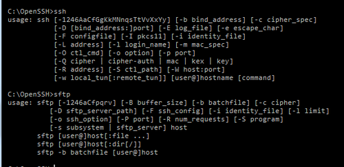

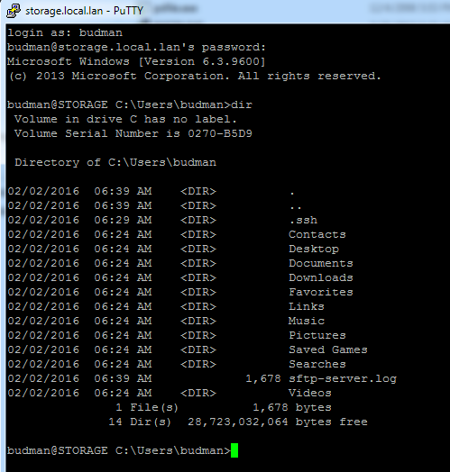

As to running sftp, what OS.. Linux its on any distro out of the box..  You would then lock that down to public key auth only vs password auth..
As to the vpn, its really clickity clickity if you run pfsense as your firewall.

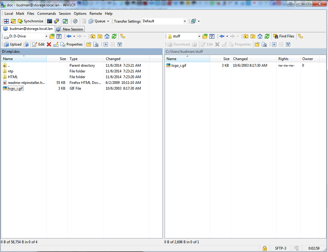

If you want to use ssh and sftp on a windows machine - pretty simple since they started releasing openssh port for windows
Grab your 32 or 64 bit flavor here https://github.com/PowerShell/Win32-OpenSSH/releases
There somewhat of a guide for setting up sftp
https://winscp.net/eng/docs/guide_windows_openssh_server
or you could use this version http://www.mls-software.com/opensshd.html
If you have any issues - just let me know and can throw together a simple walk through, takes all of a couple of minutes to setup
sshtowindows.thumb.png.34154824a44f5d207
Here is a sftp transfer, etc..
sftp.thumb.png.be021f36e196788fb25c85443
I did have some problems with kitty (fork of putty) and using filezilla as sftp client didn't like something it would connect but directly listing was not full and transfers didn't work.  Most likely both getting confused with the server type being sent back, etc.  But the port comes with both a ssh and sftp cmd line client you could use on windows that works for sure..  And didn't have any problems with actual putty or winscp in the 5 minutes of testing I did..  I normally don't use windows for this sort of stuff.
cmdlineclients.thumb.png.5e4d496950fba8a
note: be careful with winscp installer might like to install opencandy, I just use the portable version when needed..

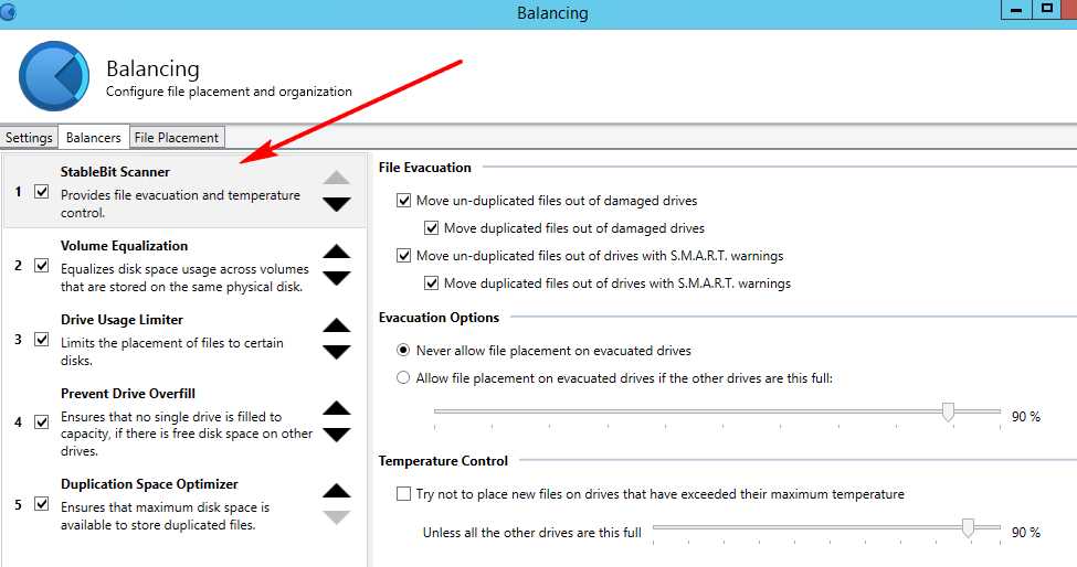

The scanner actually evacuated one of my drives for me recently, didn't loose a thing that I can tell.. Walked into my computer room and click click click.. Was like oh ###### what failed..  I didn't get any alerts or anything, until I popped the clicking disk.. Then my phone went off that one of my drives was missing ;)
I have to look closer into the alerts I have setup..  But was like ###### that sucks, but it was really old drive anyway..  Put it on a shelf, ordered a wd nas red 2tb to replace it - couple days later it showed up.  Popped it in added it to the pool.. The pool re-balanced.. Was like ok what did I loose..  I knew all my critical stuff (multiple backup even would of lost the whole pool) was there that was still there even after I pulled the disk since that was duplicated..  So I connected the old clicking drive to my pc if I could pull anything off of it..  It was toast, could read it.. Was showing up as 3.4GB or something..  But going through my library everything is there and fine..
I had seen it do this before,  But the drive didn't actually fail, and was like why was nothing on one of my disks in the pool.  But this time it seems it got the files off just before the failure.  Or maybe it had moved them off long time ago and I hadn't noticed?  But it doesn't seem to warn you if it does this??  Have to ask them about that.
evac.thumb.png.e299e2b3e8d5916acaf3f7028
Now that is what I call slick ;)  This software and support just rock!! And price is just fantastic to boot..  It just blows away spaces from every angle I can think of that is for sure..
If you have any questions on its use - just ask, happy to help been using it for few years now.. (Order date: May 23, 2012 6:52 AM CDT)  make sure you setup the alerting and the scanner!!  Keep meaning to play with the cloud piece, and thinking about adding a SSD to the pool as write cache to play with.  But I know that will just get me wanting to move to 10gig because the gig network is the bottleneck then.

Secure your server properly, always keep your software up to date, use strong passwords, and ensure that full write access is not available to anyone without passworded access. It's nothing to worry about as long as you take steps to keep yourself secure.
Yeah, I knew i'd eventually be port scanned, however I wasn't expecting to be hit from tons of addresses. Since I posted this, I've had nearly 100 hits from different IPs, the Michigan one has hit me, even though I blocked the parent /16 address, including the two it lists on its site. BudMan and I are discussing firewall options, as well as a switch upgrade.
Also, you guys asked why I needed a ridiculous amount of space, well here's another reason, my garage was broken into again. Third time within 9 months. Air Compressor, 4 Ton Jack, 4x 6 Ton Axle Stands, bunch of tools, they even took my snow blower, lawn mower, rototiller, and a bunch of other stuff. They backed a truck down our drive way, loaded it up, and took off. Around $5,000 or so gone.
