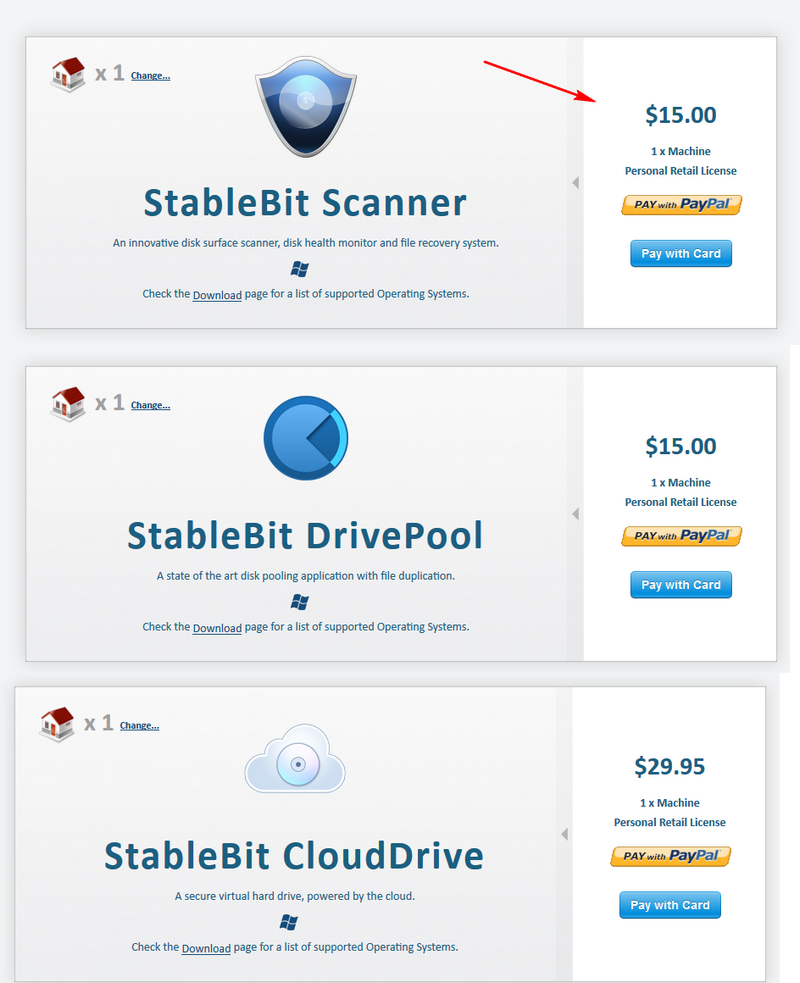

55??  Dude pool is $15, scanner is $15..  and Could is $30 if you have already bought something from them - see at the bottom existing customers, put in one of your activation codes and you get all discounted prices
discount.thumb.png.0f9ff8f9f877e1d3e96e6
if you don't like cloud then don't buy it it for your other machines - but you can pick up pool or scanner for $15 for another machine.  I have pool/scanner on my server and just scanner on my desktop.

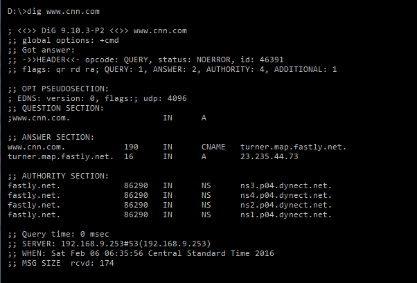

See how it came back as non-authoritative.. That is telling you it was from cache.. but with little else for info other than you see it got that info from my pfsense.
Now dig on the other hand give you WAY more info in the query.
digquery.thumb.png.6207181cd44488cde78a4
You can see what the actual ttl is left for those records, it also returned the actual authoritative NS for the record looked up.  Shows you how long my server took to respond, size of the total query, timestamp.  etc.. etc..  The dig tool provides way more info than your simple nslooup.  And is a much more rounded tool for troubleshooting dns with.   But without understanding basic concepts of how dns works - then its all just magic and could give you all the cmds in the world not going to help you find your problem if you don't actually understand what your doing or what the results tell you.

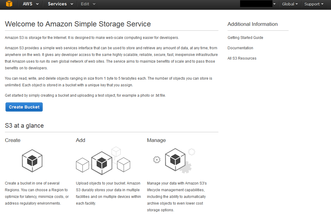

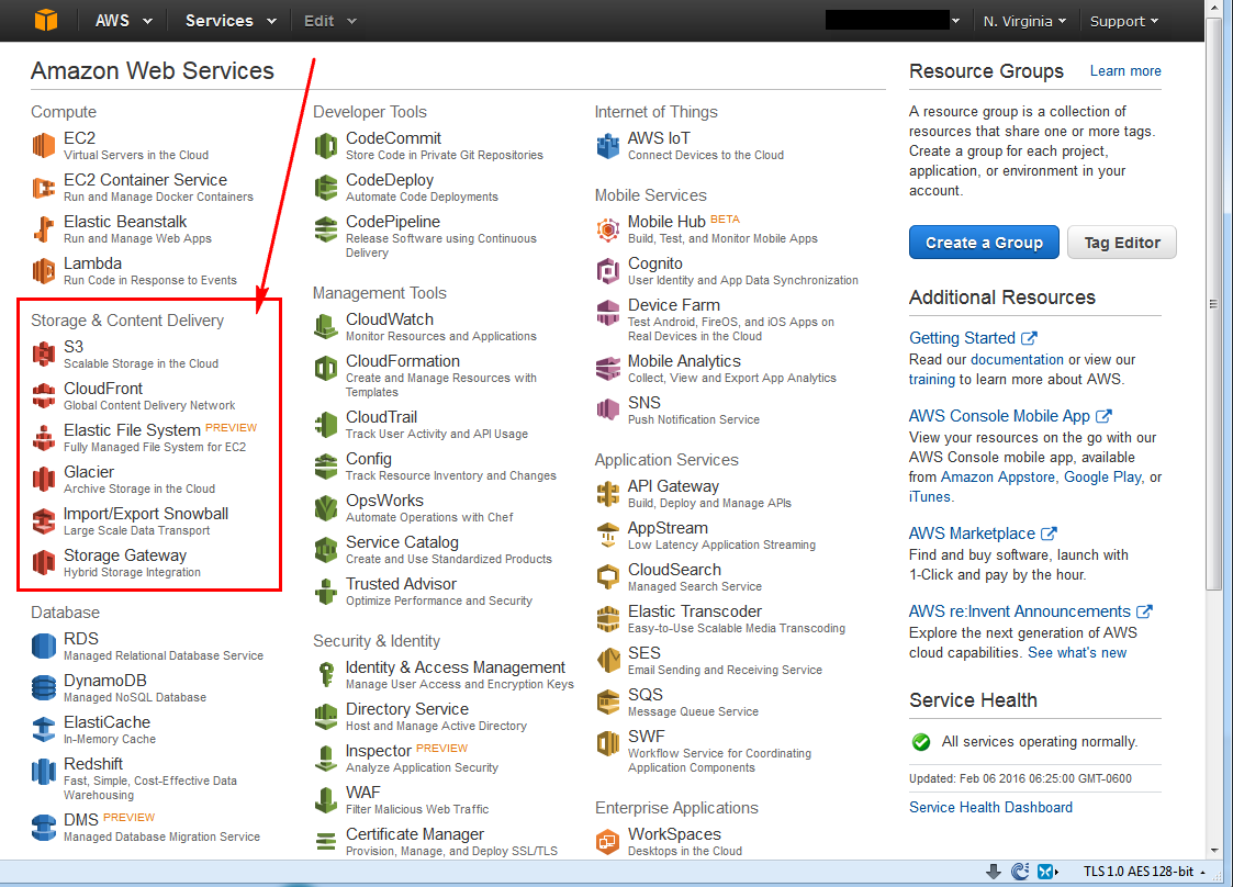

As to your amazon services..  You mean AWS console login??  As you can see they have lots of services - that are different then their home user products..
aws.thumb.png.27387f8149bc4e67fe5965e8ee

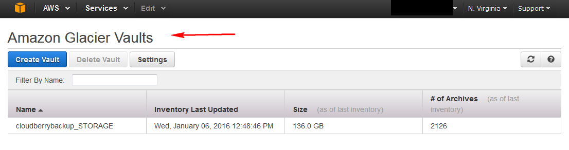

What exactly do you have a subscription too??  You do understand that amazon has many different products for storage..  See the box I highlighted above, I use glacier that is not S3 either..
glacier.thumb.png.0d9056f87621a91944c6d1
While I don't have anything setup in S3
S3.thumb.png.a42d737755b2143fbec15f82652
This is completely different than what you would get with your prime membership..  So what is it you exactly have access to for storage from amazon??  And I will download the trial of the cloud pool from stablebit and take a looky see to how to connect..

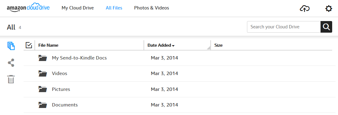

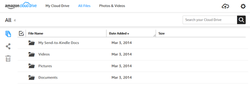

This is the cloud drive they support
clouddrive.thumb.png.f623bf0c0895406bfc5

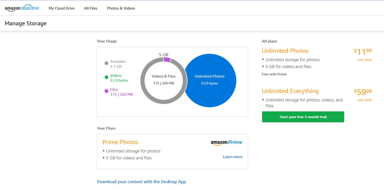

This is the free photo one you get with prime, but if you want to store more stuff then you need subscription for that.
clouddrivestorage.thumb.png.0b7cf5147a00

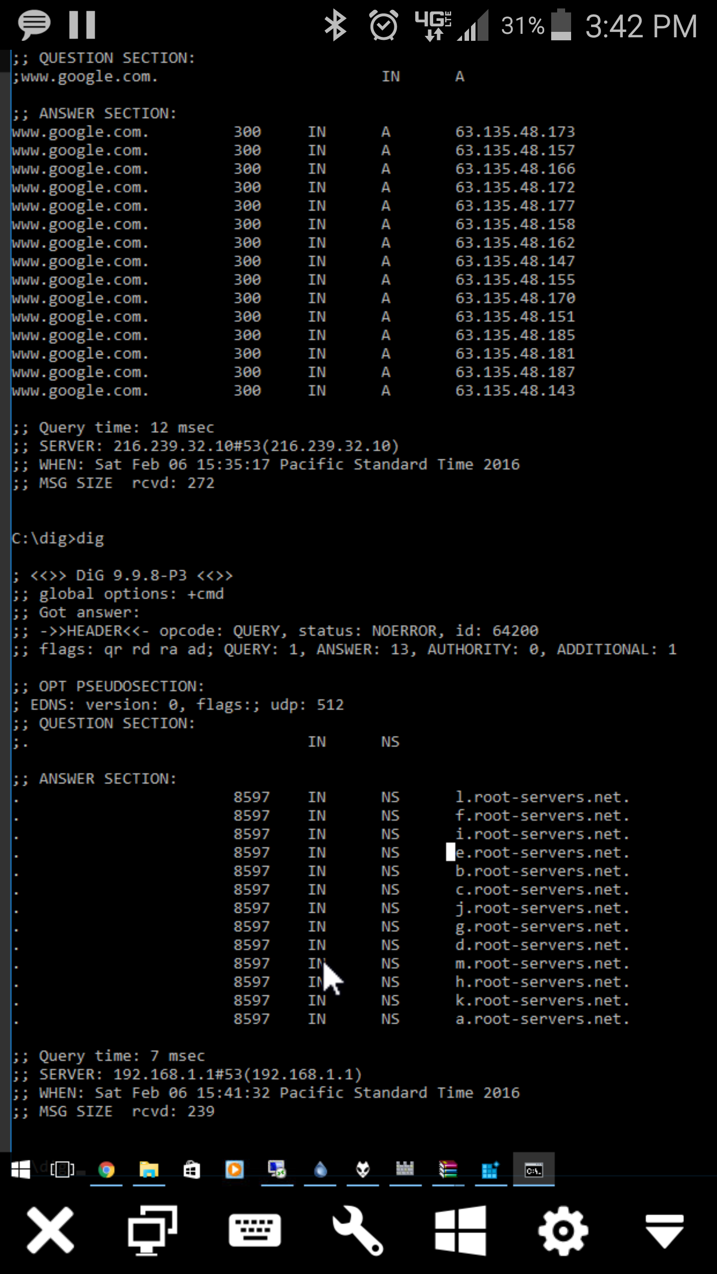

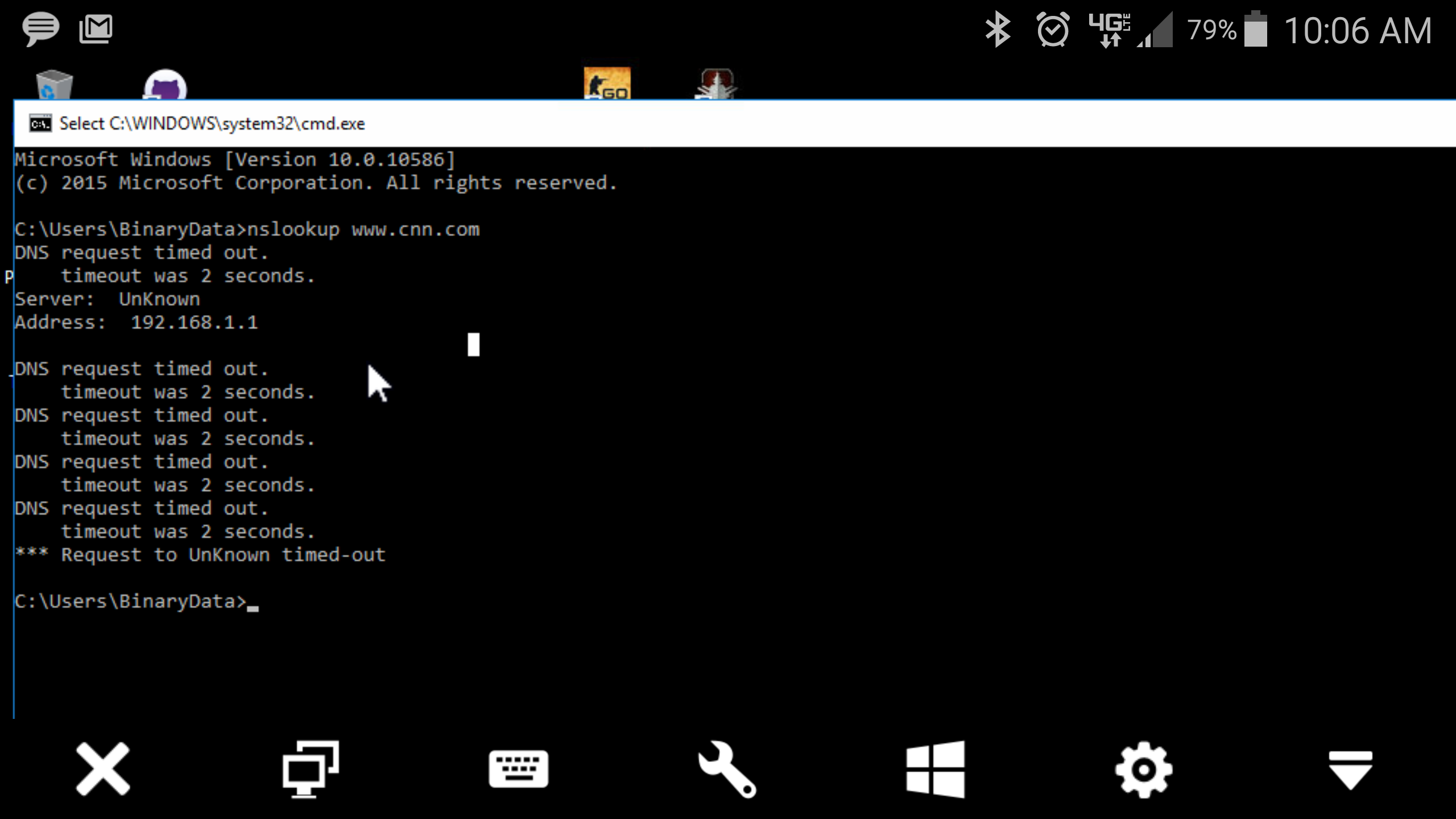

So, this is what I'm getting for my DNS.
Forgive me, I'm on my phone because my work won't allow RDC Programs. I screwed up my RDC when I re-installed Windows. So, this is what I'm stuck with using.
I'll try more stuff later. TeamViewer is being stupid on my phone.
so your client is pointing to more than 1 dns?  And 1 is not answering and 192.168.1.1 is not answering either..  And you don't have any reverse zone setup for 192.168.1.0/24 or since its down it is not resolving that. See how pfsense.local.lan is what it shows for my dns IP.

From what you posted your internet would be pretty much useless because you can not resolve anything.. What does you client have for dns?  Pointing to dns that doesn't have the same info is pointless..  Your local dns 192.168.1.1 should have all your local records, that say googledns is not going to have a clue about so if you want to resolve local stuff then all you should point to is your local dns.
Do a directed query to say google dns 8.8.8.8 or 8.8.4.4 or opendns or 4.2.2.2 always seems to answer - run by level3

So you did a directed query in the first one... Why did you do a query against ns1.google.com ??that is what 216.239.32.10 PTR says it is??
And your second one - yeah doing an empty query to your dns should return the root servers..

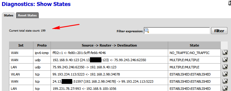

So Its 730 am in the morning here, I am not really doing anything on the net yet.  Just reading some stuff, wife is sleeping.  Nobody else here.. And currently 199 states open on my firewall. Its current size setting is 201000 of them.. So this is normally about 10% of the Ram on the firewall..  I have 2GB assigned to the VM so that makes sense.  Would depend exactly what firewall your running.  Every connection is going to normally have 2 states per connection..  So Currently I could have about 100,000 connections open before I would start to see trouble..
states.thumb.png.93294bc9db88fea51a63c1a
But you running a ftp server killed your router because of states??  I find that really really unlikely unless your got some real POS router??
There are some cheap off the shelf routers that could choke on a p2p connection... You running p2p as well?? Which can ramp up the number of connections for sure..  What is your router??  Here is a chart of number of connections of different off the shelf routers tested..
http://www.smallnetbuilder.com/tools/charts/router/bar/77-max-simul-conn
If you scroll way down there are some that have like 4096 connection limit...  You could prob eat that up with a couple of torrents running for sure..  But the many of them are over the 40K connections, which you would think would be more than plenty for any home sort of connection..  Can you even view how many your router has in its state table?

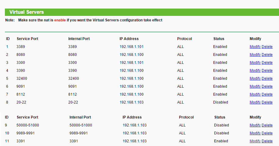

Well, the FTP in passive mode wouldn't take anything less than 1,000 ports. I could've configured it wrong, but I had 50,000 - 51,000 open specifically for that. I've disabled it, nothing changed from that.
Like I've stated before, I really don't know what I'm doing. I've never had a problem like this before.
Here are my open ports:
open_ports.thumb.png.2e0cca6cfcda01ff25e

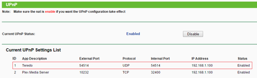

My router is this one; TP-Link N750

*** Request to cnn.com timed-out
Ran it while it was having a hiccup.
Edit:
Never seen this "Toredo" before. Though, Google said this is a 6to4 tunneling, appears to be ok? Though, I'm not running IPv6 on anything, and I don't think our ISP is, but I could be wrong.
what_is_this.thumb.png.184e2910cbf97c810
Edited by BinaryData
