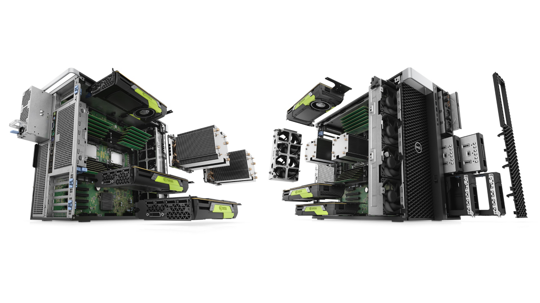

Manufacturer "laziness" aside, a current setup regardless of how "old" it is will be supported by the manufacturer for the warranty time specified 3 years, 5years, etc and can be extended beyond that in almost every case.  So squeezing every bit of current technology performance isn't something that I worry about as much as having a business continue to run for the time frame a warranty can be bought for.  Essentially if you aren't going to offer up support for the system, don't suggest something outside of what can be offered.  I can build a crazy fast system, as good or better than you possibly could....I won't support him when it fails and I do expect some hardware to fail at some point whether there be environmental damage outside of our control (flooded office, lightening hit, etc) and I won't be a phone call away with parts on standby ready to ship nor will I be a one stop shop for all of his problems in relation to this server purchase.
Dell Config DevTech-2
$5,884
  • So, Precision same as server = really fight with the bewildering config
  • CPU is 10 cores
  • Empty 2nd CPU socket for upgrade
  • 48 gigs is the smallest RAM which gives you the PROPER 6-way RAM for modern Xeon in LGA 3647 sockets - this can be downgraded if 2 way RAM in a 6-way socket system won't wake you screaming most nights "What have I done?" Note: all configs so far to patseguin have NOT been 6-way RAM
  • I suspect that some people holding out for RETRO SPINNING THINGS are attracted to those cute looking levers on the front where you can pull out a drive so in this config we give you cute little levers on the front to pull out NVMe drives!
  • If you want the server O/S then Dell Rep needed to change that
  • Selected lowest NVIDIA card - Dell rep can probably downgrade but stay with NVIDIA
  • I forgot to add a spinning backup drive but there is 9 more slots to stuff in just about anything
  • I added Thunderbolt 3 to ALL configs so far to permit super easy to add external fast drives down the road.
https://www.dell.com/en-us/work/shop/desktop-and-all-in-one-pcs/precision-7920-tower/spd/precision-7920-workstation/xctopt7920us
  • Precision 7920 Tower Chassis (BC_PCIe)
  • Intel Xeon Silver 4114 2.2GHz, 3.0GHz Turbo, 10C, 9.6GT/s 2UPI, 14MB Cache, HT (85W) DDR4-2400
  • Windows 10 Pro for Workstations (4 Cores Plus) Multi - English, French, Spanish
  • Quadro P620, 2GB, 4 mDP to DP adapter (PWS 5820,7x20T)
  • 48GB 6x8GB DDR4 2666MHz RDIMM ECC
  • Intel NVMe PCIe SSD (Front PCIe FlexBay)
  • Intel Integrated controller (RST-e) with 1-2 Front FlexBay NVMe Drives
  • M.2 2TB PCIe NVMe Class 40 Solid State Drive
  • Thunderbolt 3 PCIe card - 2 Type C Ports, 1 DP in
  • 3 Years Hardware Warranty with Onsite
