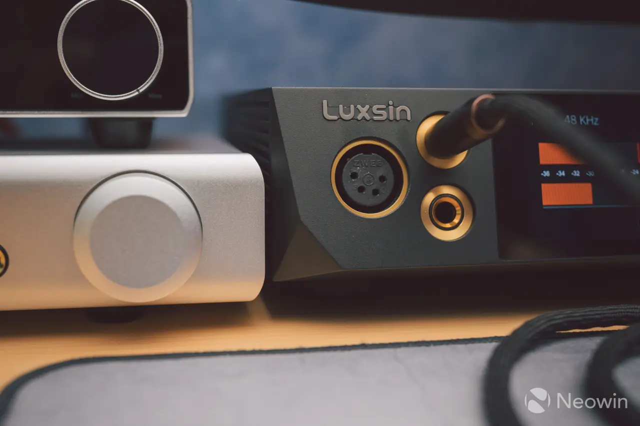

For those intrigued, above is a visual comparison. It is a bit wider than FiiO devices using the K15/K17/WARMER chassis, and is a little less in depth. Even still, I used right-angled cables to gain two more inches of desk space out of preference:

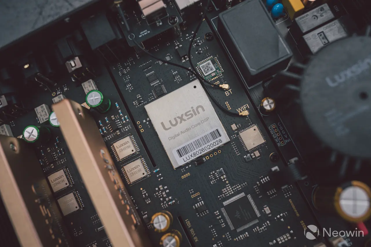

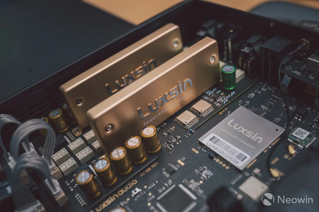

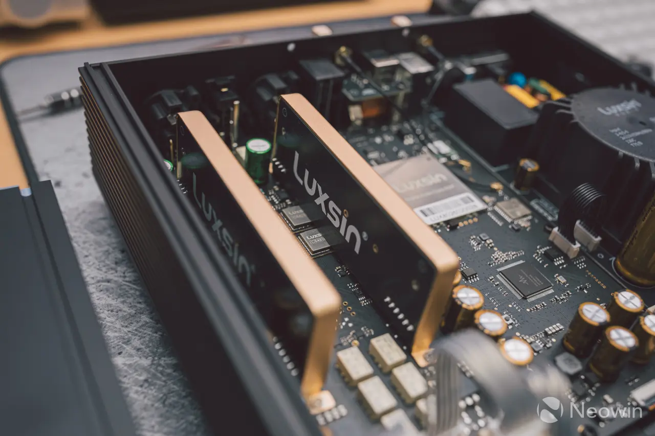

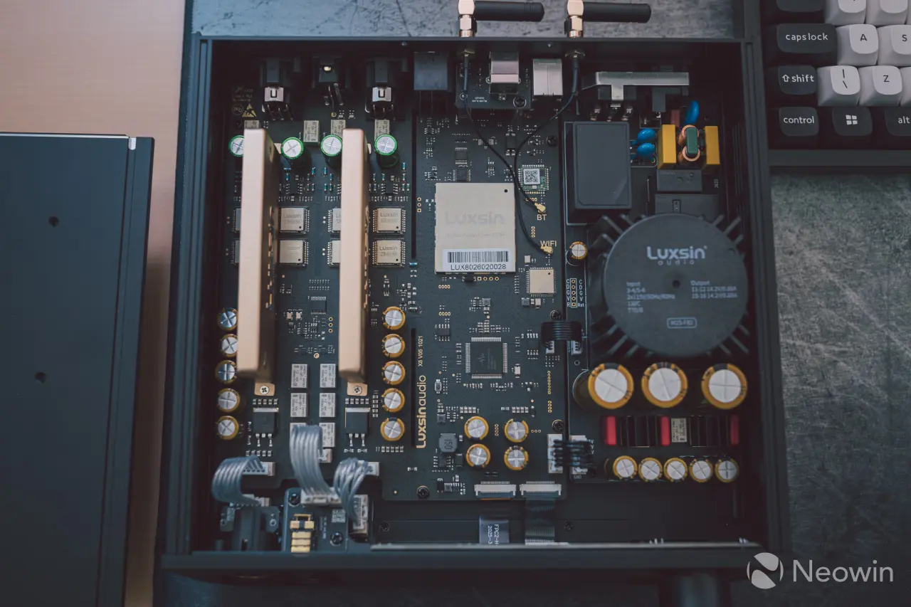

Don't let the DAC swap misguide you, though, because the CS43198 is not only tried and tested, but there are eight of them in this implementation, four per channel in a dual-mono architecture and power amplification.
There is no other DAC on the market currently using more than four CS43198 DAC chips. The X8 also has an in-house DSP dubbed the "Luxsin Digital Audio Core"; this DSP houses a +500MHz ARM CPU handling all of the AI/EQ processing.

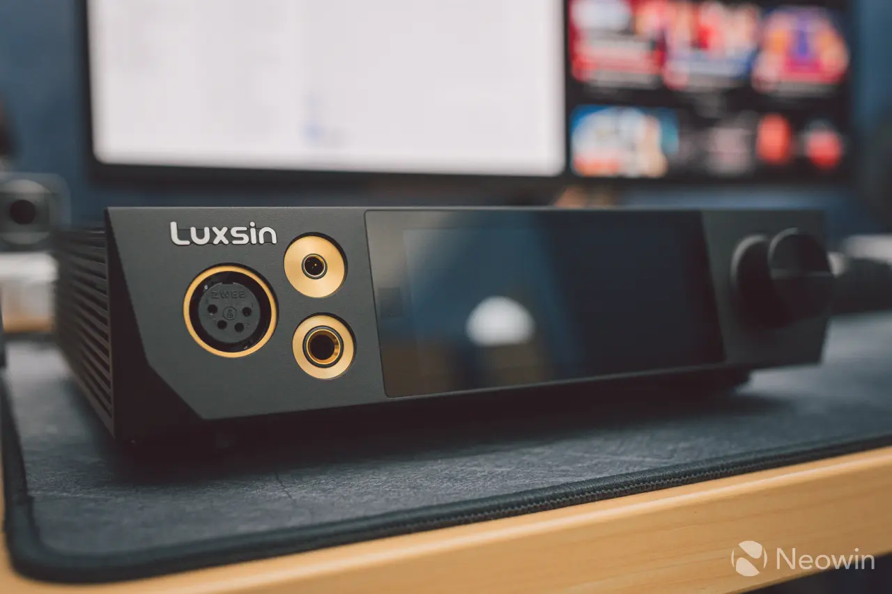

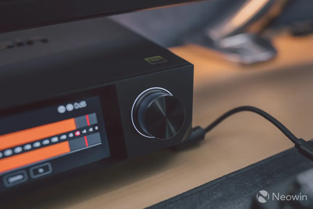

The rest of the package is just like what we see with the X9, a CNC machined Aluminium chassis, a machined volume dial that now functions as a button, and a 1080p capacitive touchscreen. From a visual point of view it looks like a juvenile X9. Dare I say it, I think it looks more sleek in black and an evolution over the X9 as a result.
The boot up time from standby is also fairly reasonable, it's not quick, but it does go through various stages with relay actuations giving audible indication, take a listen:
There really is only one gripe from my first impressions, and that is the omission of a remote control. I don't know how much of the cost this saved, but Luxsin has confirmed that it will offer a remote as an optional extra for those wanting it. It also confirmed that the remote is the same one that comes with the X9, and that an all-new remote is currently in development which will come with the next model instead.

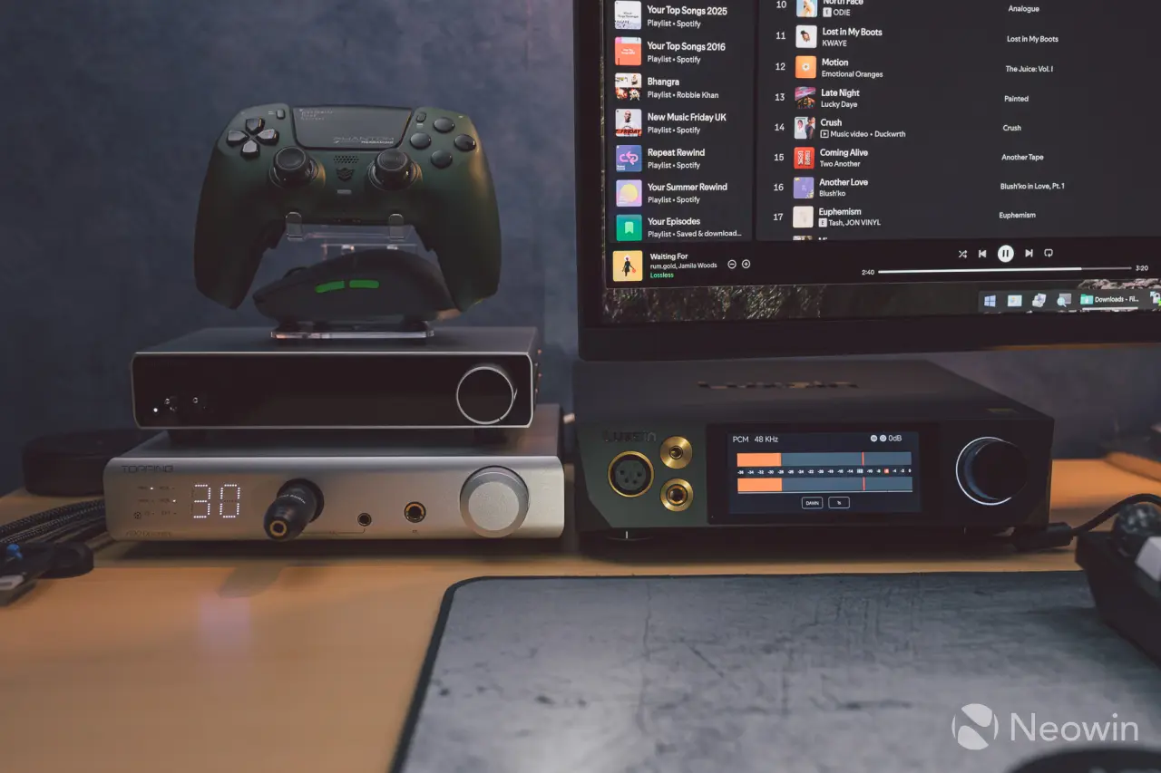

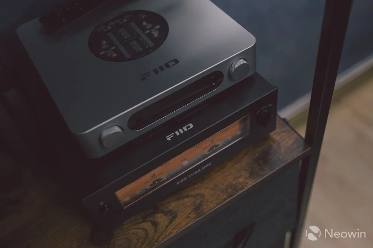

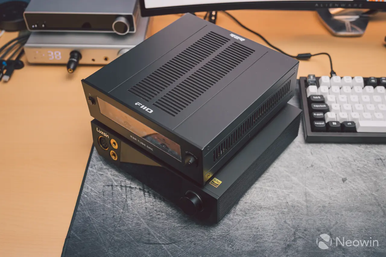

Comparing it as a DAC against both the FiiO K13 R2R and WARMER R2R Tube Buffer was interesting. The WARMER is my current benchmark thanks to its simplicity, price and full bodied sound. It got even better after upgrading the tubes, as did the K13 R2R after swapping to the external FiiO PL50 linear power supply.
Even still, the Luxsin X8 was able to nearly match the organic articulation of the WARMER, whilst retaining a tighter grasp of the lower end frequencies resulting in punchier and more immediate sub-bass response compared to the slightly laid back approach the WARMER has in this area where bass can have a slower roll-off. If anything, I would liken the X8's lower end frequency presentation to embody a combination of the K13 R2R's (with linear PSU) bass which is tight and punchy with a dominant slam when the music asks for it, and the WARMER's near-holographic soundstage and upper frequency detail extraction from well-mastered music.

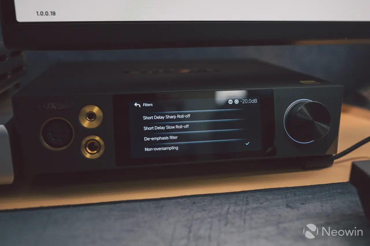

All listening tests here were conducted with the DAC set to NOS (Non-Oversampling) mode, and the parametric EQ and sound tuning fully bypassed. The pre-out volume was then set to passthrough which delivers a line level signal to the Topping A90 Discrete acting as the pre-amplifier to the speakers. The headphones were connected directly to the X8's balanced outputs.

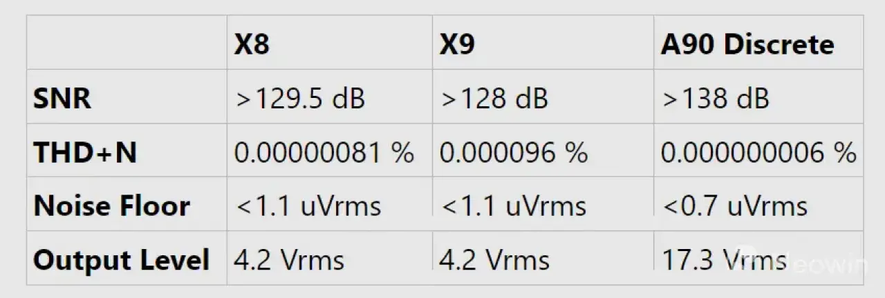

I found that whilst the pre-amplification section of the X8 does a fine job, it does slot behind some older pre-amps like the A90 Discrete, and this is very audible. For example, the table below shows just how different the trio are as pre-amps. The A90 Discrete wins on power output level, along with lower noise values, not that noise in either of them is audible to human ears at any volume anyway.
What this meant in practice was that the A90 Discrete at 40% volume (low gain) is as loud as the X8 and X9 at around 60% volume (X8's pre-out gain set to high). That is a big difference, and not just a case of different manufacturers scaling volume and gain levels differently. Both the X8 and X9 have the same output Vrms as shown above, whilst the A90 Discrete is considerably higher.
Even still, using the dial on the Luxsin duo is very satisfying, if a little lighter in ratchet feel on the X8 compared to both X9 and A90 Discrete. And whilst the A90 Discrete and X9 have volume control handled by a mechanical relay array for precise channel balance and attenuation, the X8 has a digital volume control with a single relay in place which is purely for the click sound that many loved in the X9.
Here's how it sounds compared to the A90 Discrete's actual relay volume controller:

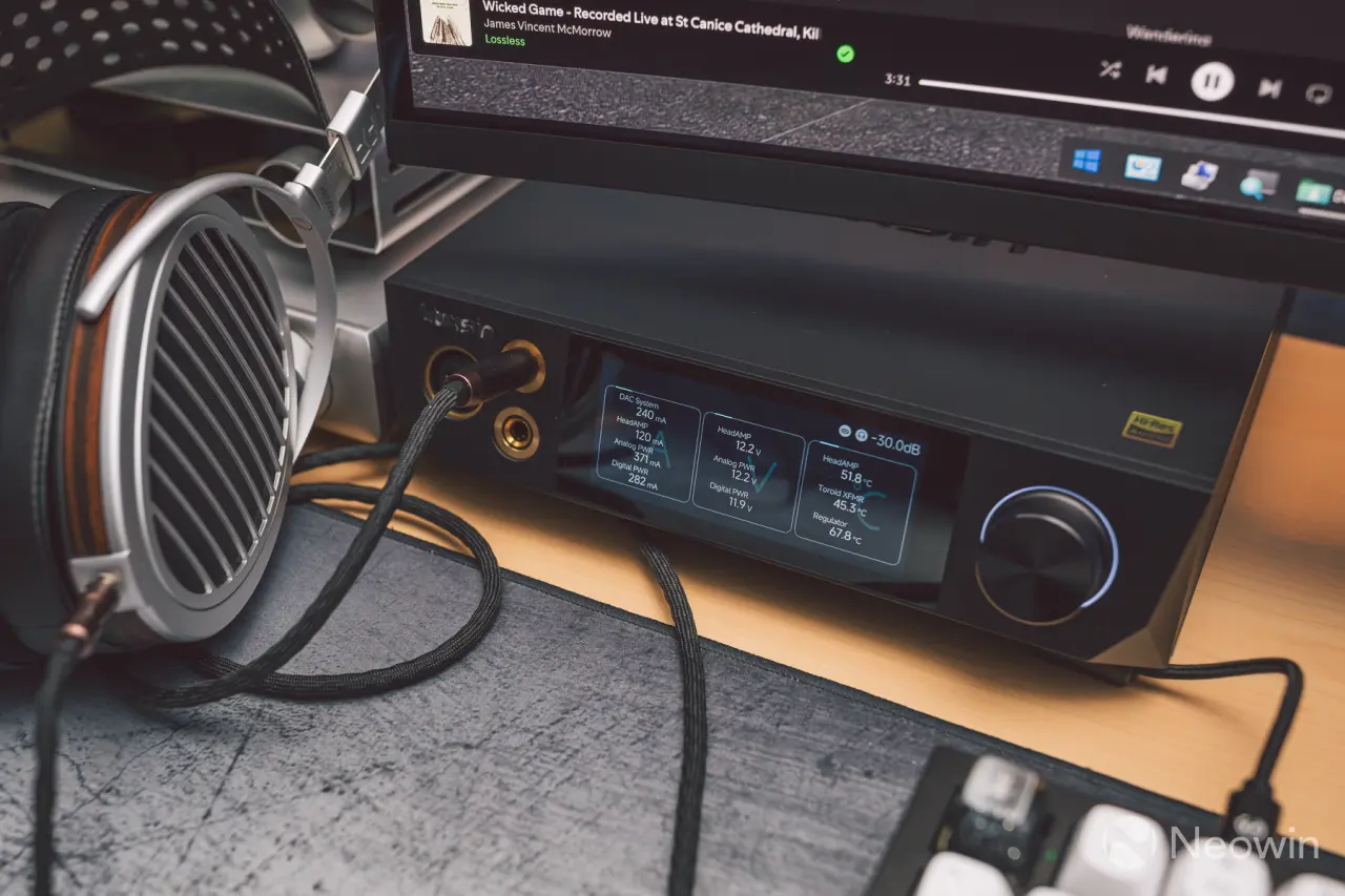

Ease of use
Using the touchscreen interface is a breeze, it is fast and the touch response is as low latency as a smartphone screen. This improves the user experience immeasurably since there is no remote control in the box.

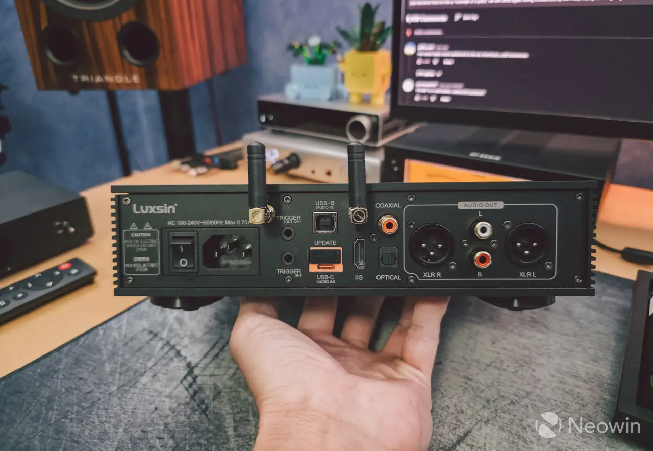

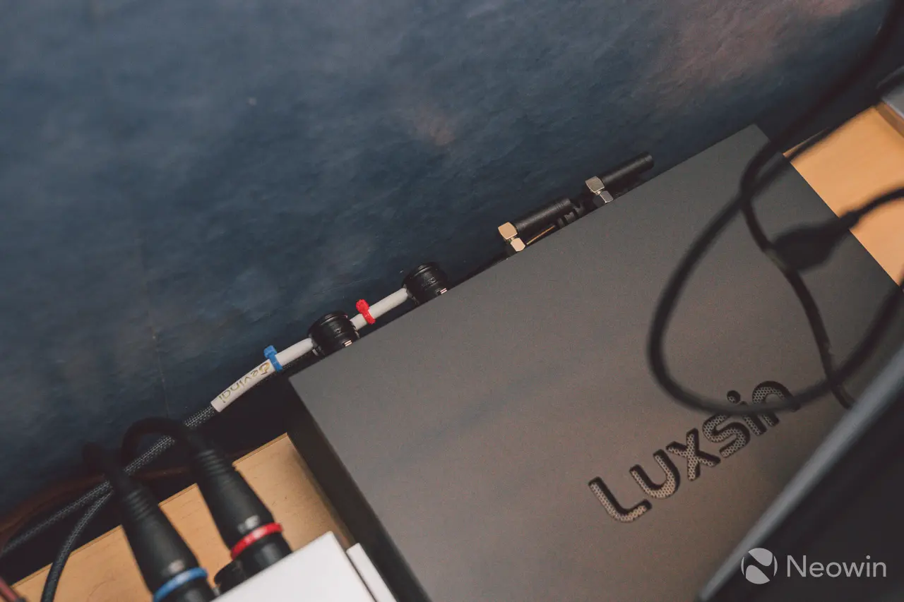

The X8 has a slew of inputs and outputs, the other omission here is that RCA inputs from the X9 are gone, so a bummer for those who wish to connect an analogue source to the X8.
As with the X9, Luxsin has opted to isolate the power lines for the USB ports, this means there is no way for noise to interrupt the signal chain from whatever source you connect from. This is extremely useful when connecting to a computer where internal noise finds its way to the USB controller on the motherboard. This also means there is no need to use a third party device such as an iFi Defender to isolate USB power signals so they don't reach the DAC.
Luxsin X8

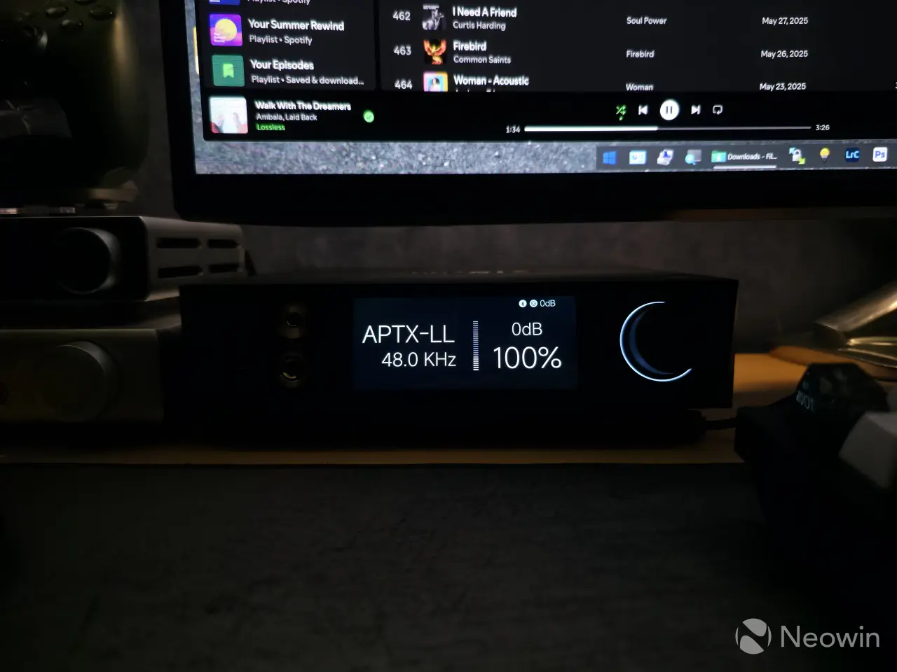

Bluetooth gets a nice upgrade over the X9, too, now supporting aptX-LL for low latency streaming from supported sources such as phones, projectors and so on. Though once again, anyone connecting to a Windows computer via Bluetooth must use the Alternative A2DP driver which allows you to select the better CODECs, otherwise Windows will just default to SBC or something crazy like that.
It is also great to see 12v trigger in and out featuring. I have connected both terminals up between my trio stack and it works seamlessly. Due to no remote, I'm using the A90 Discrete trigger source, all I have to do is standby the A90, and both X8 and PA7 power amp enter standby as well. Triggering this way saves from having to individually power on and off each component in your audio stack.
The inclusion of IIS will please some, though I don't have any sources using this connection. The IIS mode can be toggled in the menu system for those with specific needs here.

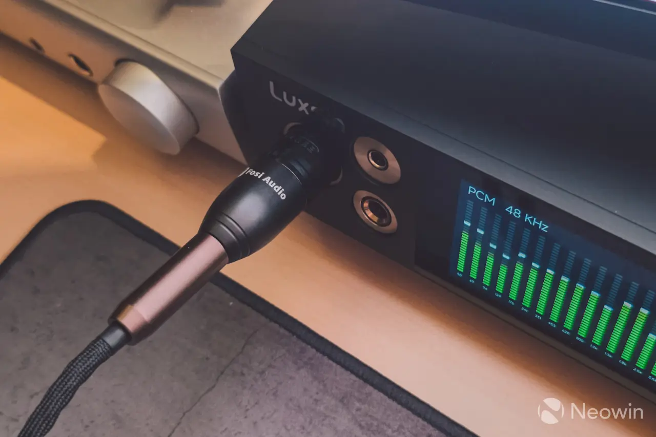

Something new this time round is that the front XLR port for a headphone connection has automatic jack detection. With the X9, and other headphone amps on the market, you typically must manually switch to the XLR port whilst the single ended 3.5mm/6.35mm and 4.4mm balanced ports only are auto sensing and switch to headphone output when something is connected. Now, the XLR port functions the same way.

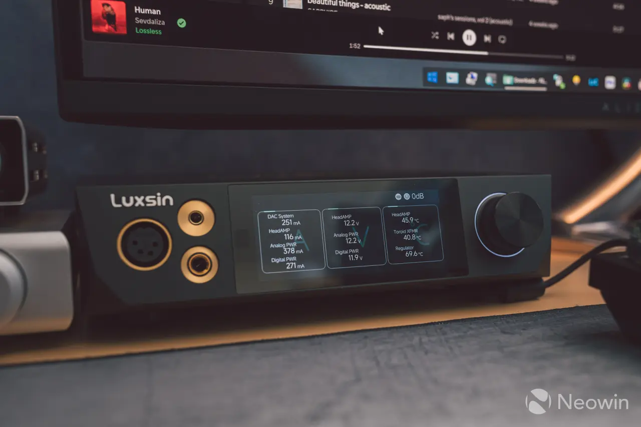

Something else new with the X8 is a home display screen that shows various technical stats (above) of what's going on inside, those of us who are a bit extra when it comes to displaying stats on screens, this is for us!

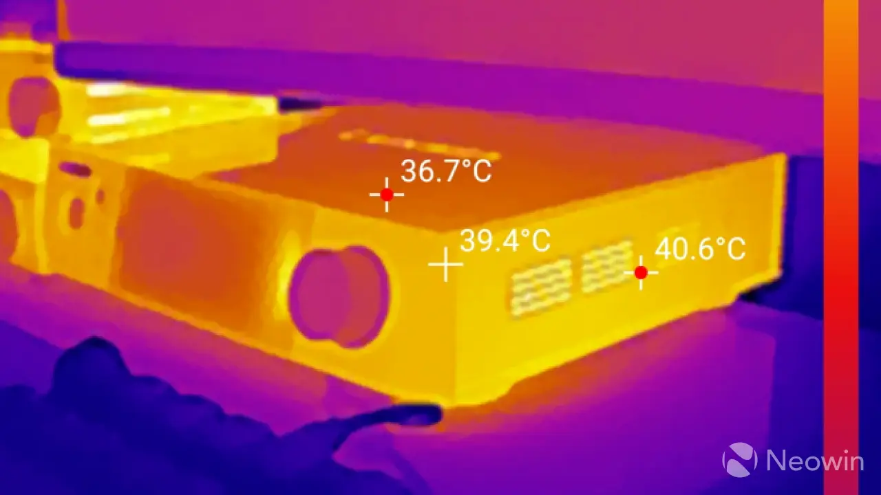

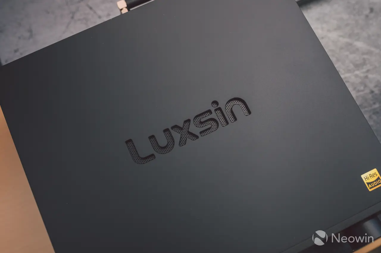

Heat distribution is also implemented nicely. The top panel is warm to the touch, whilst the right side vent area is warmer still. After being on all day long, the highest recorded temperature was 44 degrees. Impressive considering there is a linear power supply in there, dual power amp modules with heatsinks and a slew of large capacitors.
