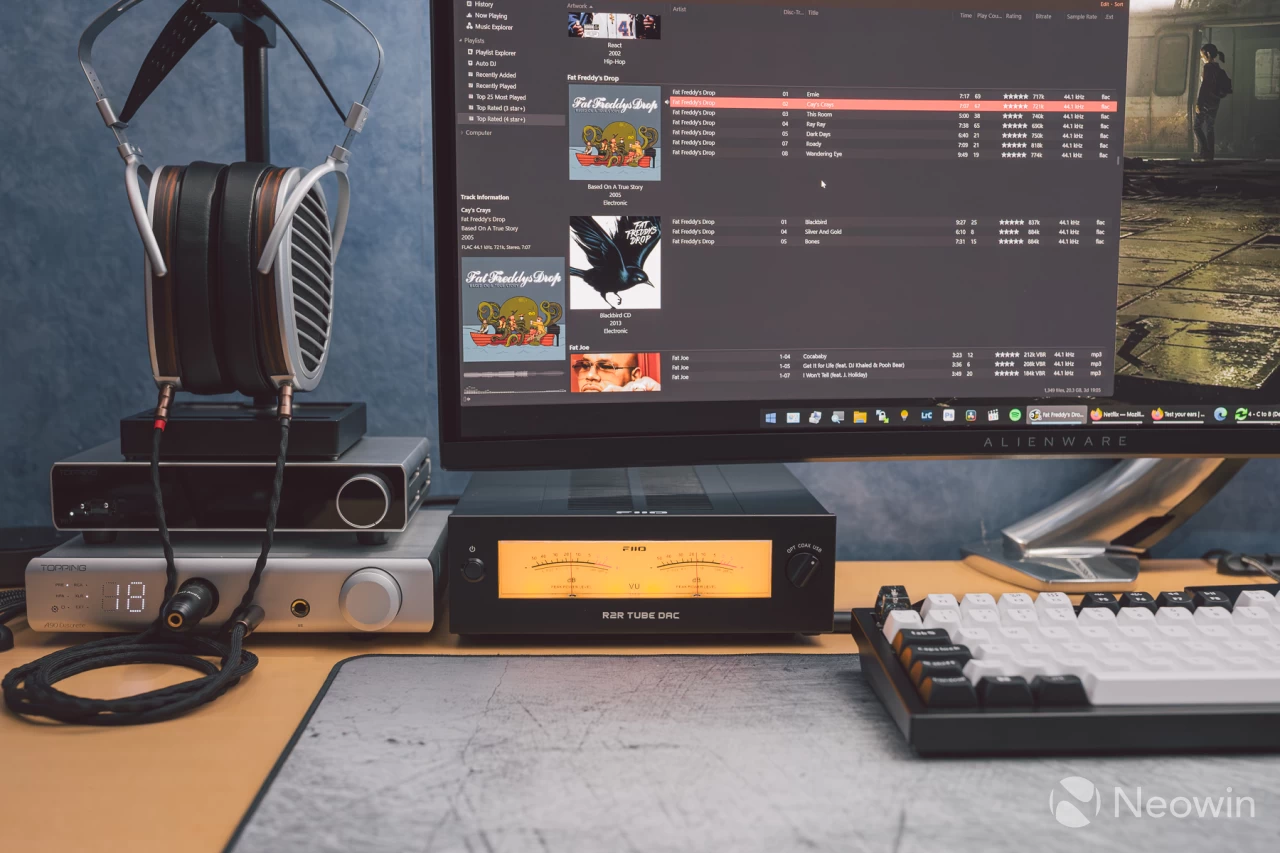

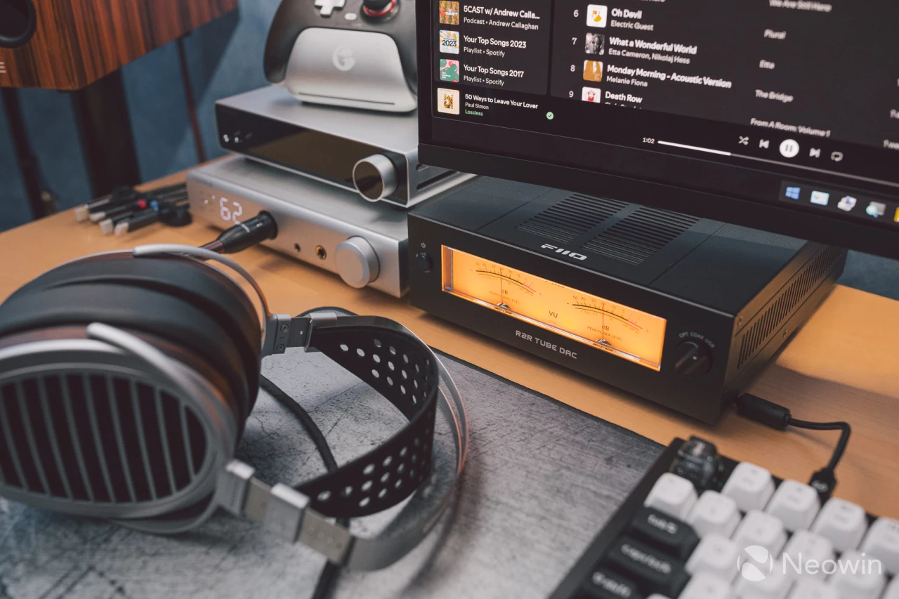

In my case, the rather excellent Topping A90 Discrete serves pre-amplifier and headphones amp duty as it is mostly transparent, and is able to distinctly articulate the source DAC's character.
To listen to my passive speakers (TRIANGLE Comete 40th Anniversary), the Topping PA7 is more than happy being the power amplifier for that role. All connections between separates are via XLR balanced cables, and the DAC is connected to my PC via USB.
Fiio
The FiiO USB driver has also been installed, with the Always On setting enabled in the FiiO control panel which removes the initial playback delay that happens with mostly USB DACs connected to a computer over USB.

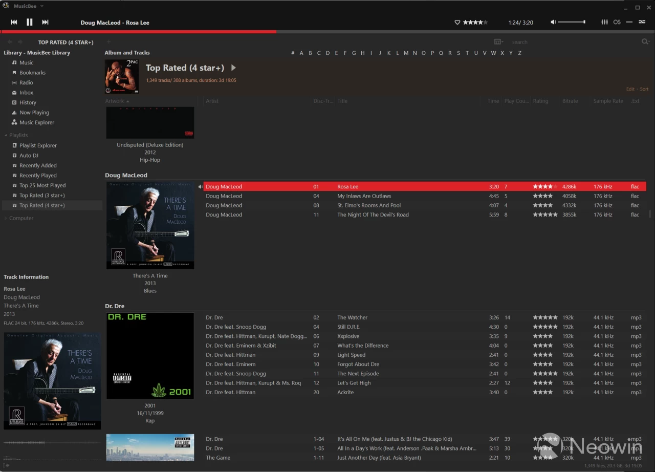

musicbee
All of the listening during testing was done via local FLAC files in MusicBee (ASIO), as well as streaming via Spotify Lossless from my curated playlist - Yes, I am aware that some pockets of the web do not consider Spotify to be truly lossless because the lossless file being streamed is being resampled by the OS.

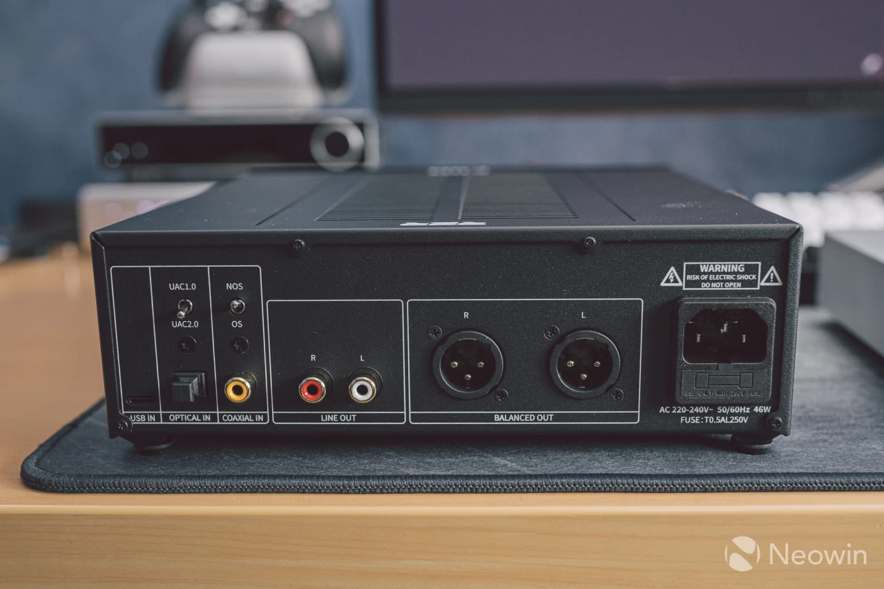

Rear controls NOS/OS switch, UAC 1.0/2.0 switch
Rear ports Inputs: USB-C, RCA, digital COAX, XLR3 balanced
Outputs: RCA, XLR3 balanced
Power: IEC connector

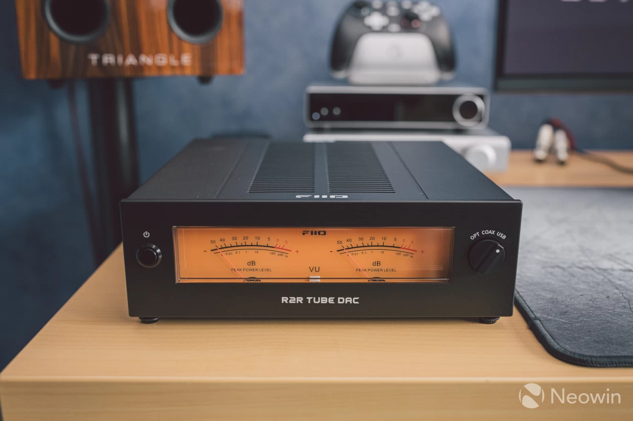

At 2800 grams, the WARMER R2R is no lightweight, that's more mass in a smaller footprint than the Keychron Q6 Max, and that thing takes effort to lift up. The weight is mostly due to the fairly large toroidal transformer forming the core part of the 46W internal linear power supply.

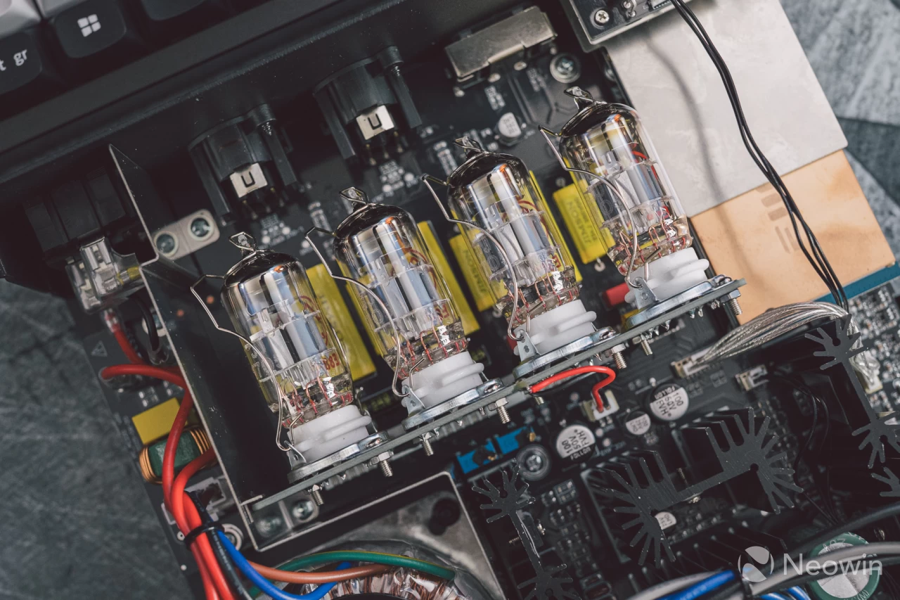

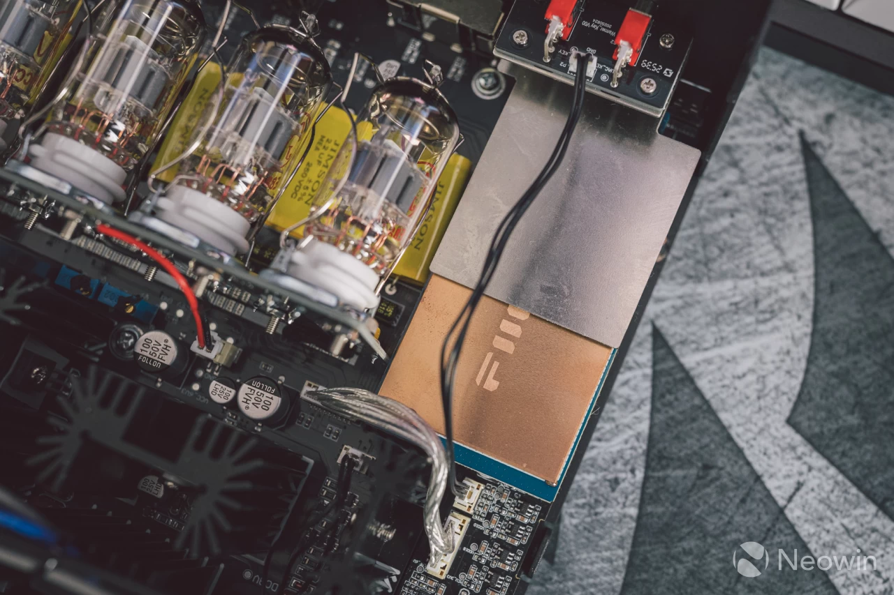

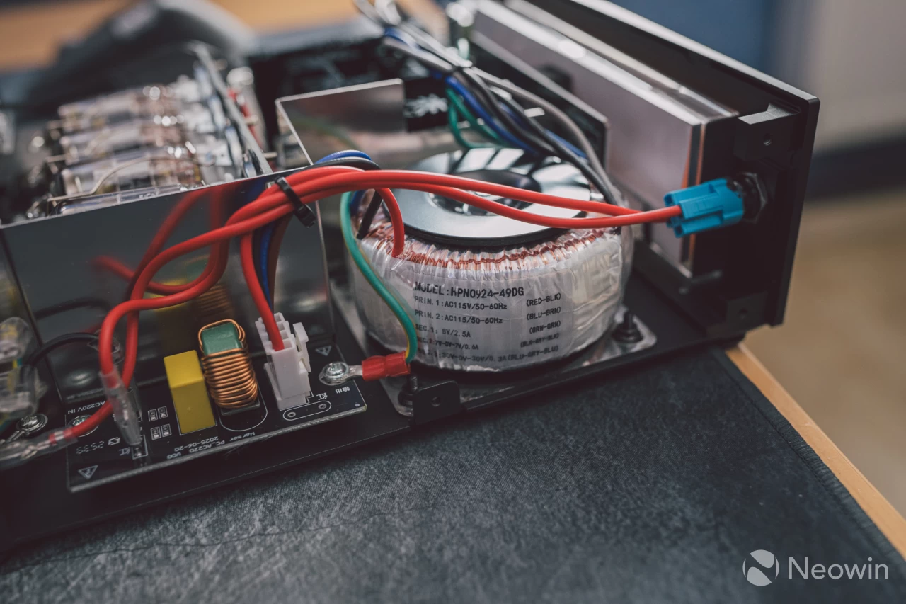

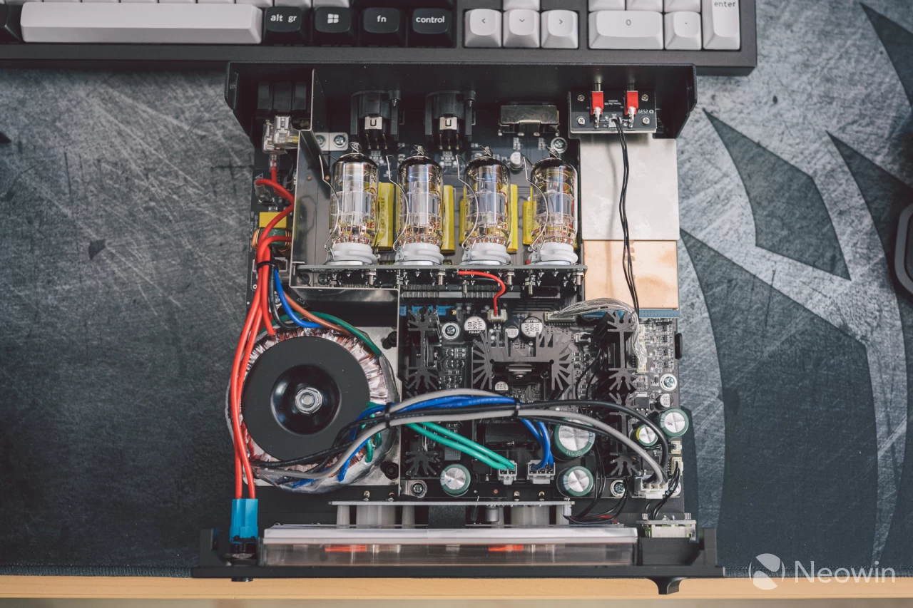

Opening up the WARMER isn't a quick affair. There are ten star headed screws holding the sides of the one-piece folded cover in place, and a further four cross-head screws at the back. Those wishing to experiment with tube rolling may wish to do this in one session to save yourself the time from having to remove so many screws each time.
The interior is clean and organised. The PCBs are sectioned off, with a rather novel layout for the JJ Electronics E88CC tubes to be oriented horizontally as opposed to vertically as found on most tube-based amps and DACs.

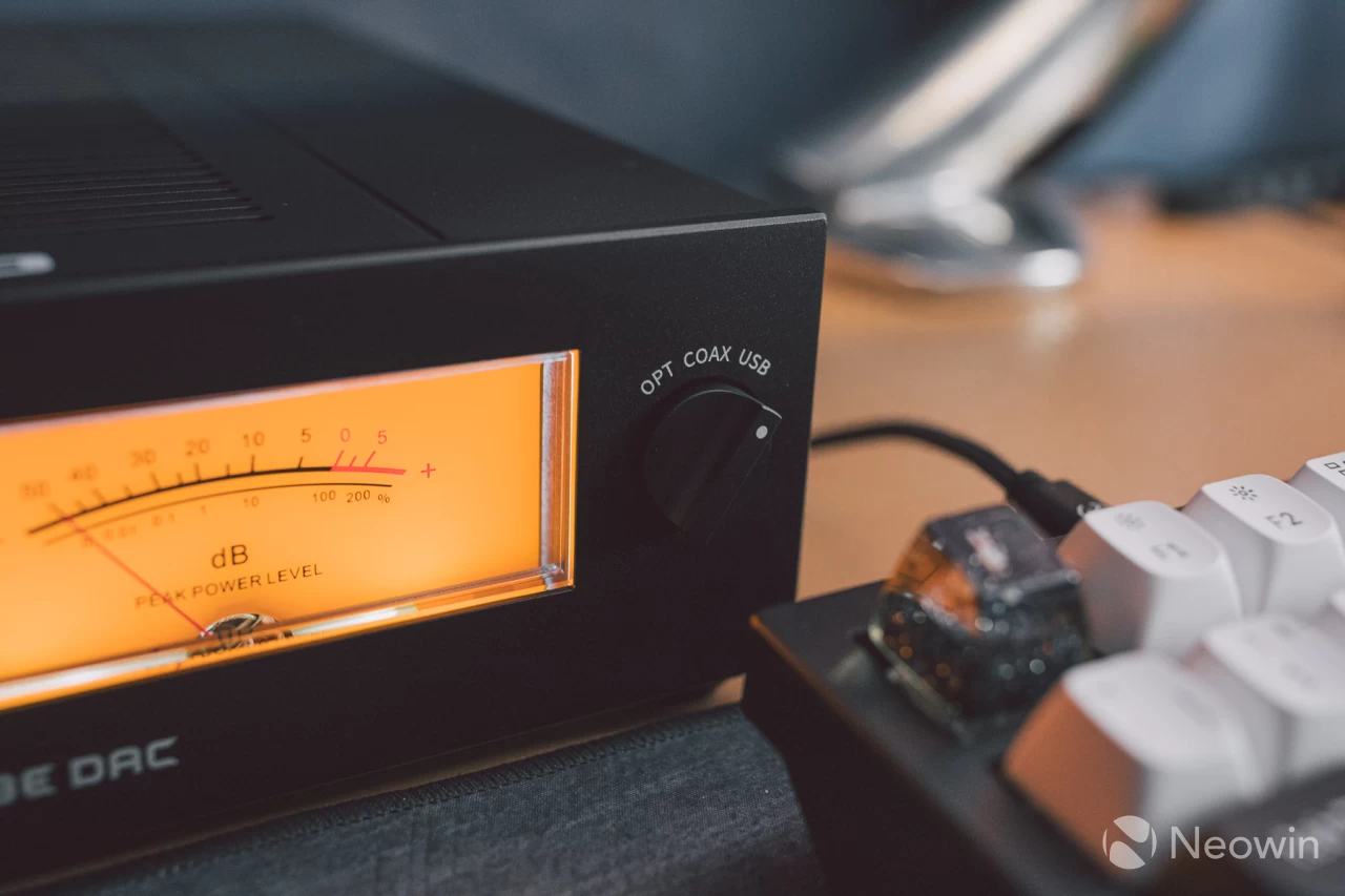

The power switch is mechanical switch as opposed to the usual digital type, and apart from the input select dial, that is it up front, there isn't even a way to dim or turn off the display. Whilst he display is not too bright in the dark, it can sometimes distract, especially if playing a dark game in dim lighting.

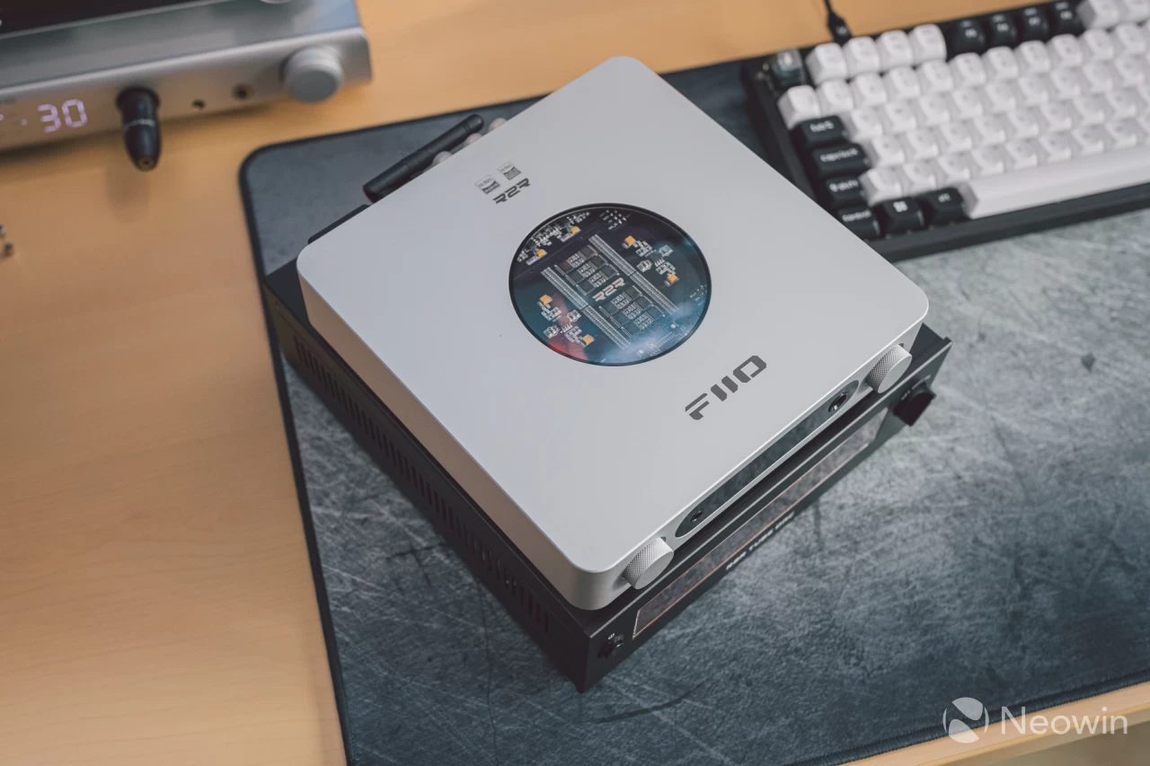

Comparing it to the K13-R2R, since they both have the same R2R DAC (shown above) shows that whilst the K13-R2R is also excellent, the WARMER is able to do a better job with a wider soundstage and greater stereo image, more detail in the upper frequency range and a more composed mid-range.
The only area where the K13 wins is its ability to produce sub-bass extension which is especially noticeable through speakers instead of headphones. There is a level of instant punch in music through the K13-R2R that adds extra dynamic which I really enjoy.
fiio warmer r2r
K13-R2R on top, it's a little more space-friendly
I then wanted to test whether the K13 could produce soundstage and stereo imaging that rivalled the WARMER by using a linear power supply instead of the internal switch mode one, so I ordered the FiiO PL50 and spent a couple of days listening between both DACs.
What I discovered was that the K13-R2R was now producing both soundstage and a stereo image that almost matched the WARMER R2R, whilst still having greater sub-bass extension. The WARMER is still wider staging still, with a greater level instrument placement and air between them, but the gap was definitely smaller now between the two.
fiio warmer r2r
Whilst the K13-R2R costs nearly £280 here in the UK, the PL50 linear power supply is an additional £118. That puts the price of the combo quite a bit above the WARMER R2R to only get close to the WARMER 's harmonic charm. Some may well prefer that given that there are a number of issues with it which I will detail shortly.

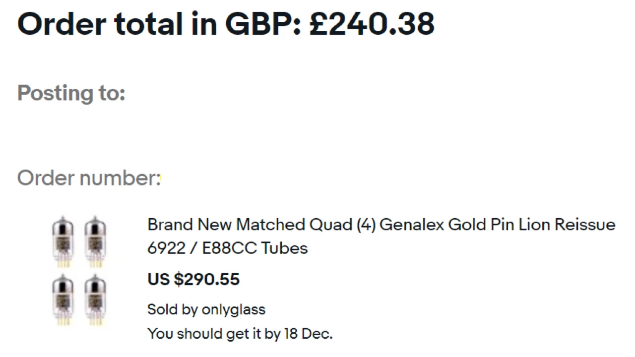

... After seeing many comments asking if I was going to try out third party tubes. So based on recommendations from within the community, I ordered a matched quad set of Gold Lion tubes.
Delivery will not happen for a couple more weeks at minimum, so I will update this section with my findings as soon as they do and I have had a chance to sample them, it will certainly be interesting to see what (if any) differences can be heard with tubs in an R2R DAC at the buffer stage.
UPDATE: 2025.12.18
Tubes
The Gold Lion E88CC matched quad tubes are now installed and have had nearly 20 hours of listening time. Right out of the box the sub-bass extension was greater in slam and depth than the stock JJ Electronics tubes that now have over 500 hours of listen time on them, so have opened up further themselves with improved sub-bass.
Vacuum tube burn-in is a real thing, an old and well-understood technology going back at least 100 years! Many manufacturers back in the day would refuse to supply such tubes to customers unless factory burn-in of up to 100 hours was conducted.
After around 10-20 hours, these Russian made tubes have relaxed in the mid-range frequencies to levels matching the matured stock tubes, just now with the extended sub-bass detail. This was exactly what members of reddit and head-fi were alluding to when these tubes were recommended.
Not a cheap way to get extra sonic definition for sure, and there may be cheaper tubes that do similar things, but at least I've tried some of the better tubes out there for dynamic range and quality.

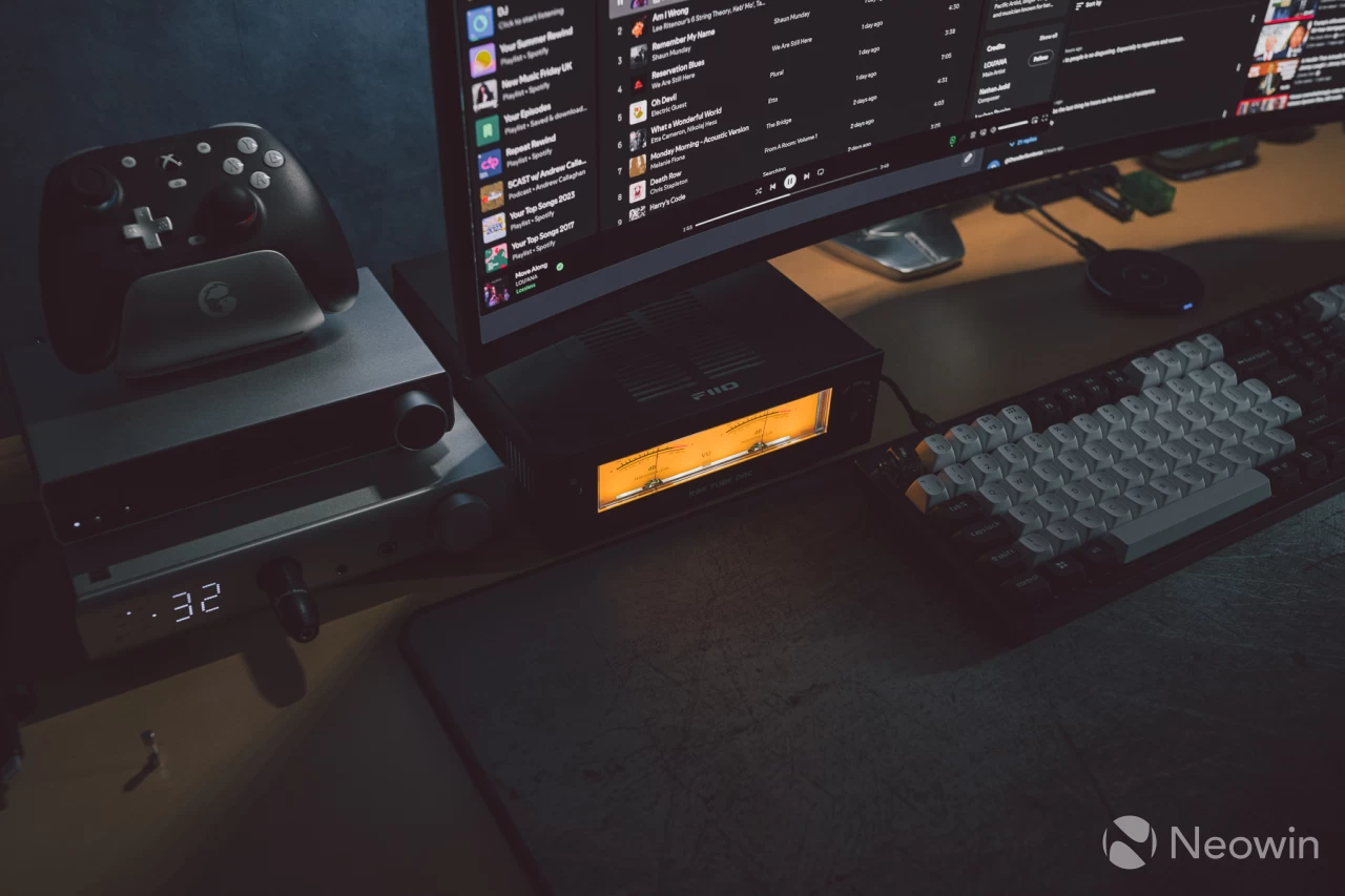

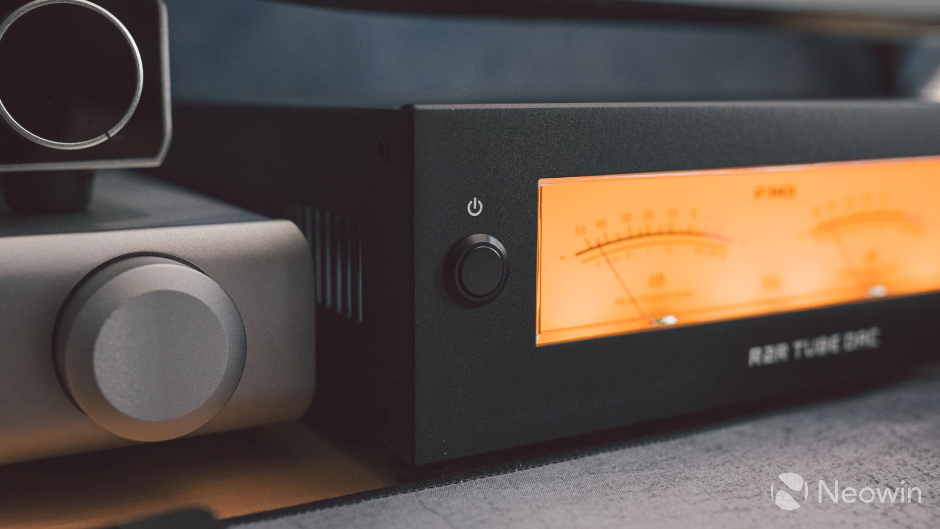

1) The display lamp cannot be turned off or dimmed. This means in dim lighting when watching something, or just working away, the orange glow could be a distraction. I have become accustomed to it and don't really notice it any more after some weeks of working in the dark most nights.
Here is what it looks like in a desktop setting with lighting under control:

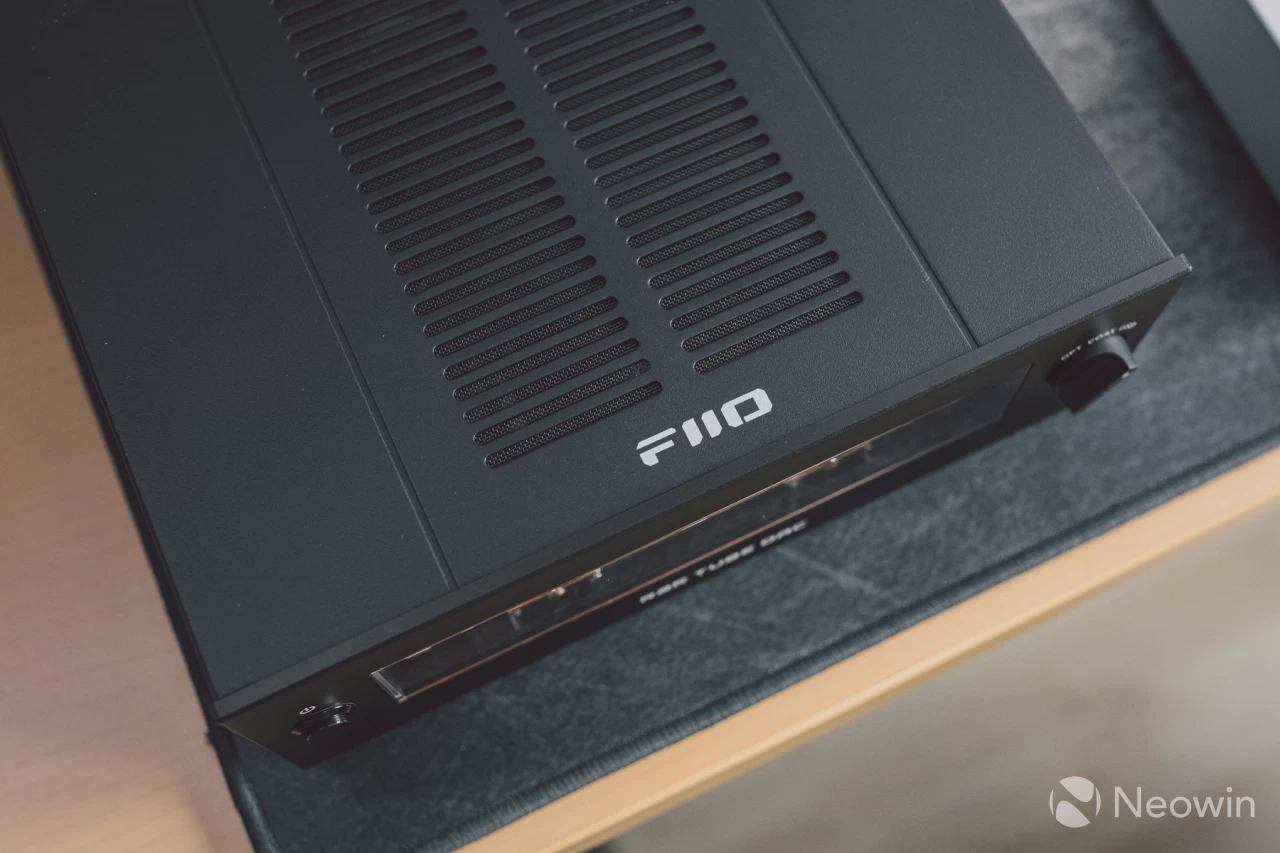

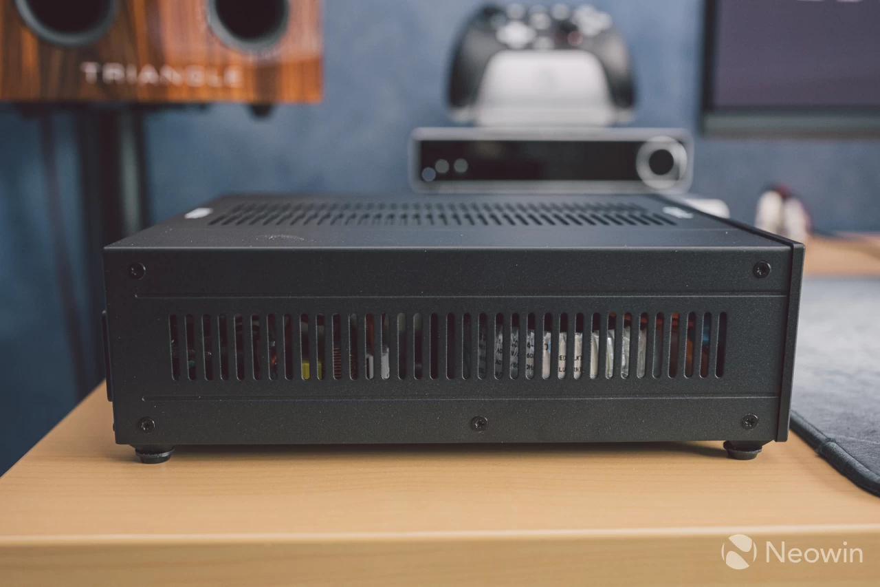

2) It runs hot, hotter than most would be expecting since this is just a DAC, and it is not just the tubes causing the heat, but instead the tall heatsink towers and capacitors. Using an IR thermometer I registered up to 66.4 degrees over areas of the chassis:
fiio warmer r2r
Of course this also means stacking things above or below the WARMER R2R is a no-go, and in fact when you first unbox the DAC there are multiple bright warning sheets advising not to stack because it gets hot during operation.

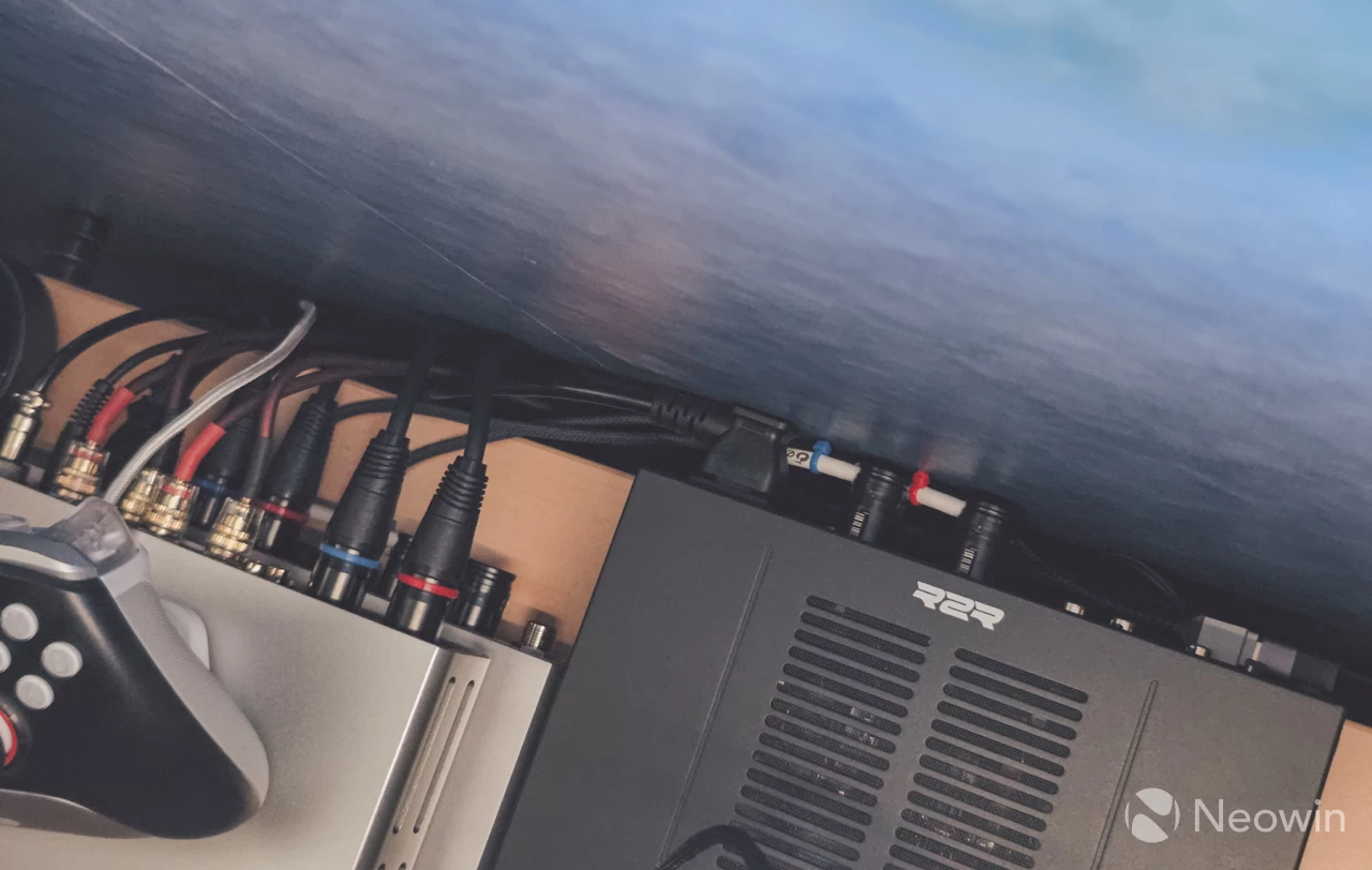

5) It is quite a deep unit, even on my 68cm deep desk I needed to buy a right-angled USB-C adapter, a right angled IEC power adapter and right angled XLR cables to be able to gain 2 extra inches of desk space:
Fiio
Size does matter after all it seems 😅
