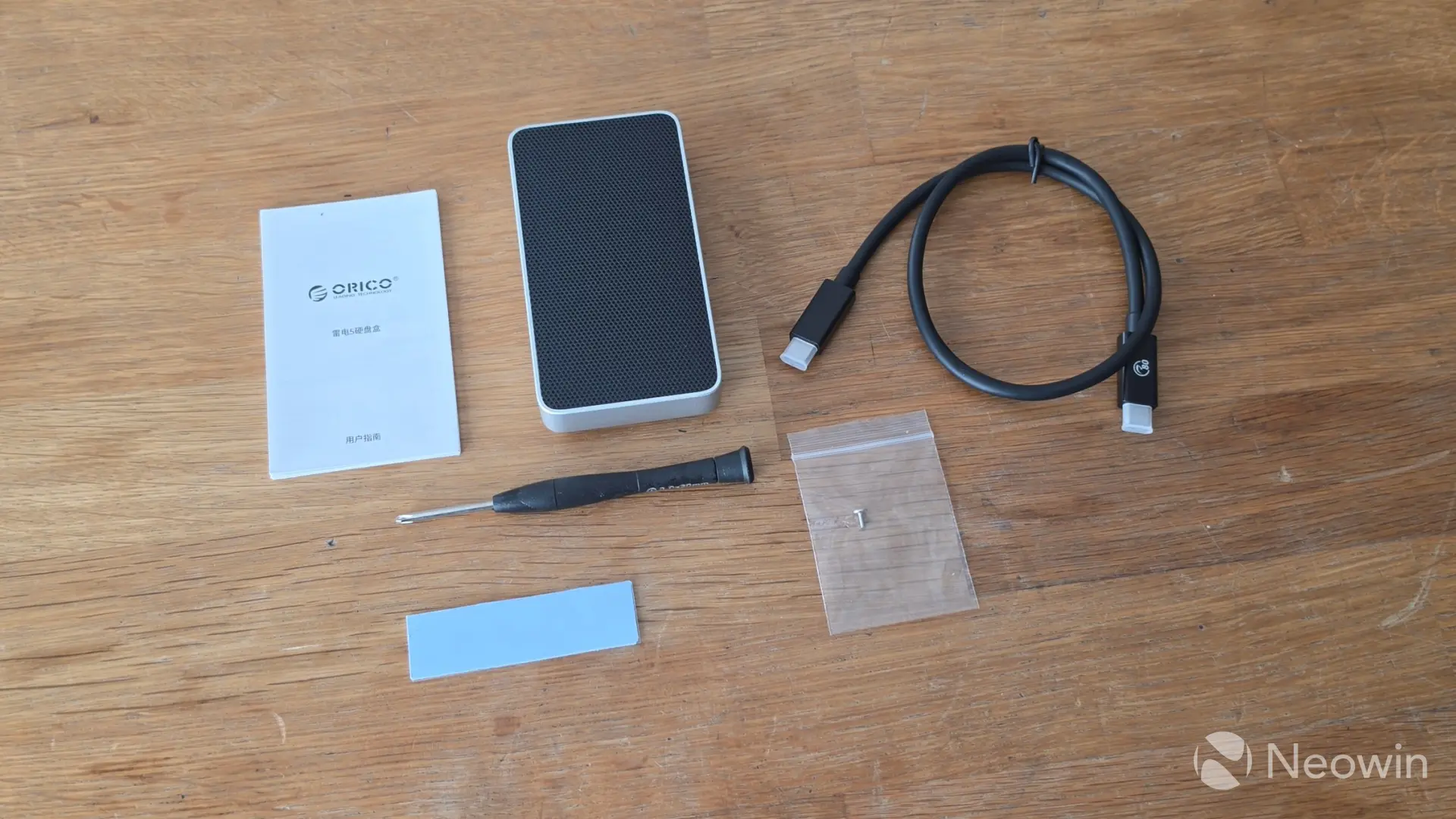

With that out of the way, the ORICO X50 comes in a cardboard box, which, when opened, reveals the SSD enclosure sitting in a foam cushioning in a plastic bag. Below that is another compartment with the accessories.
orico x50
What's in the box
  • ORICO X50
  • USB Type-C cable (C to C) 0.5m
  • Screwdriver (magnetized)
  • 1x Thermal Pad
  • M.2 screw
  • Quick installation guide

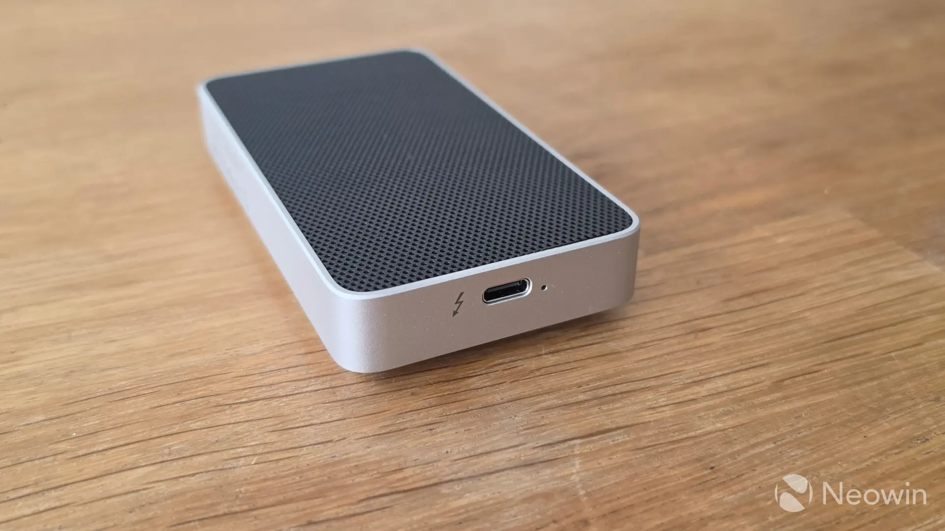

The SSD enclosure is a familiar rectangle design with what looks like a metal grill top to assist with heat dissipation, but it doesn't function that way; ORICO says that the top of the X50 includes a HydroSkin cooling film under what looks like the top grille. Personally, I think it looks quite nice.
terramaster d4 ssd

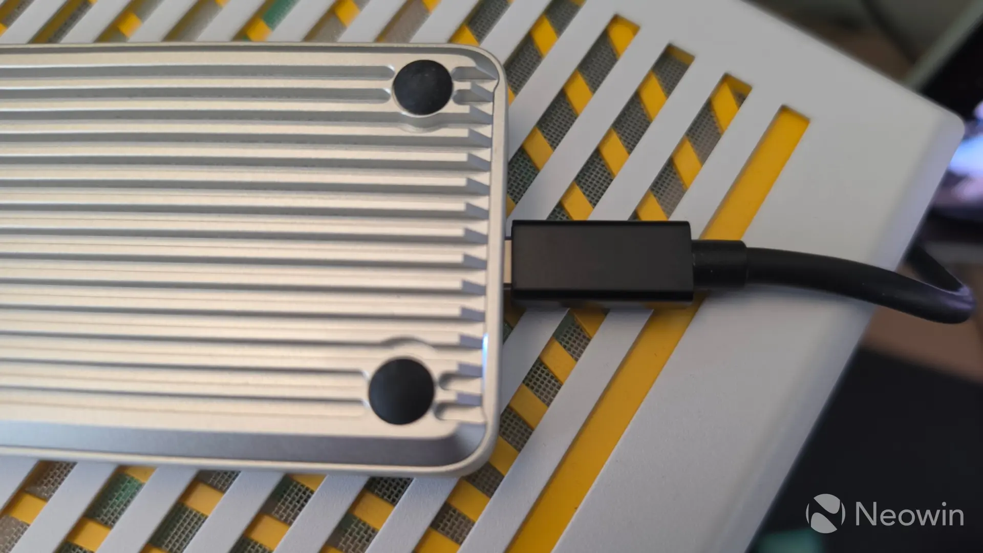

Above, you can see it from all angles. The underside, which comprises an "innovative fin design," has one screw that does not stay in the frame when loosened. On one side, you have the port, flanked by a thunderbolt symbol and an indicator light that does not change color depending on the port speed. Around the other side is completely free of word marks.

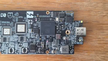

After removing the four screws of the PCB, turning it over, and carefully removing the thermal pad, the Intel JHL9480 Thunderbolt 5 Accessory Controller chip can be seen along with a relatively large amount of SMD capacitors. This ensures voltage stabilization, power failure protection, and data safety. As well as its advertised USB4/Thunderbolt 5 40Gbps x2 speeds, the JHL9480 chip is also backwards compatible with existing USB Type A ports and Thunderbolt 3/4.
There's no preinstalled thermal pad on the SSD side, although one is included in the box.

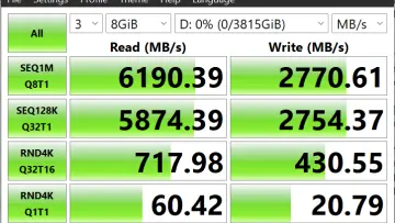

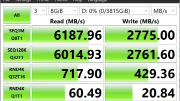

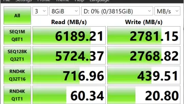

I ran CrystalDiskMark 9.0.1 in Windows 11 with the ORICO X50 attached to a Thunderbolt 5 port three times with an 8GB workload, and also recorded the disk temperature using HwINFO. The outer enclosure reached a max temp of 48 °C with a max 54 °C disk temperature.
CrystalDiskMark numbers show the random reads are great, and the random writes are decent, about what you would expect from a DRAMless drive, and that too off a USB interface, so nothing much to complain about here.

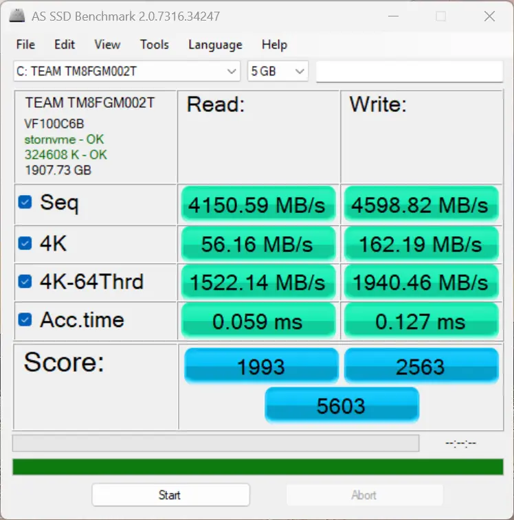

AS SSD
terramaster d1 ssd plus
We also did a run of AS SSD, and the performance figures put up are good. The drive has performed as expected in both sequential and random throughputs here, too. The speeds make it a really good option for 4K/8K video editing projects that would benefit from fast transfer speeds and rapid access times; add to that the benefit of the cool temperature.

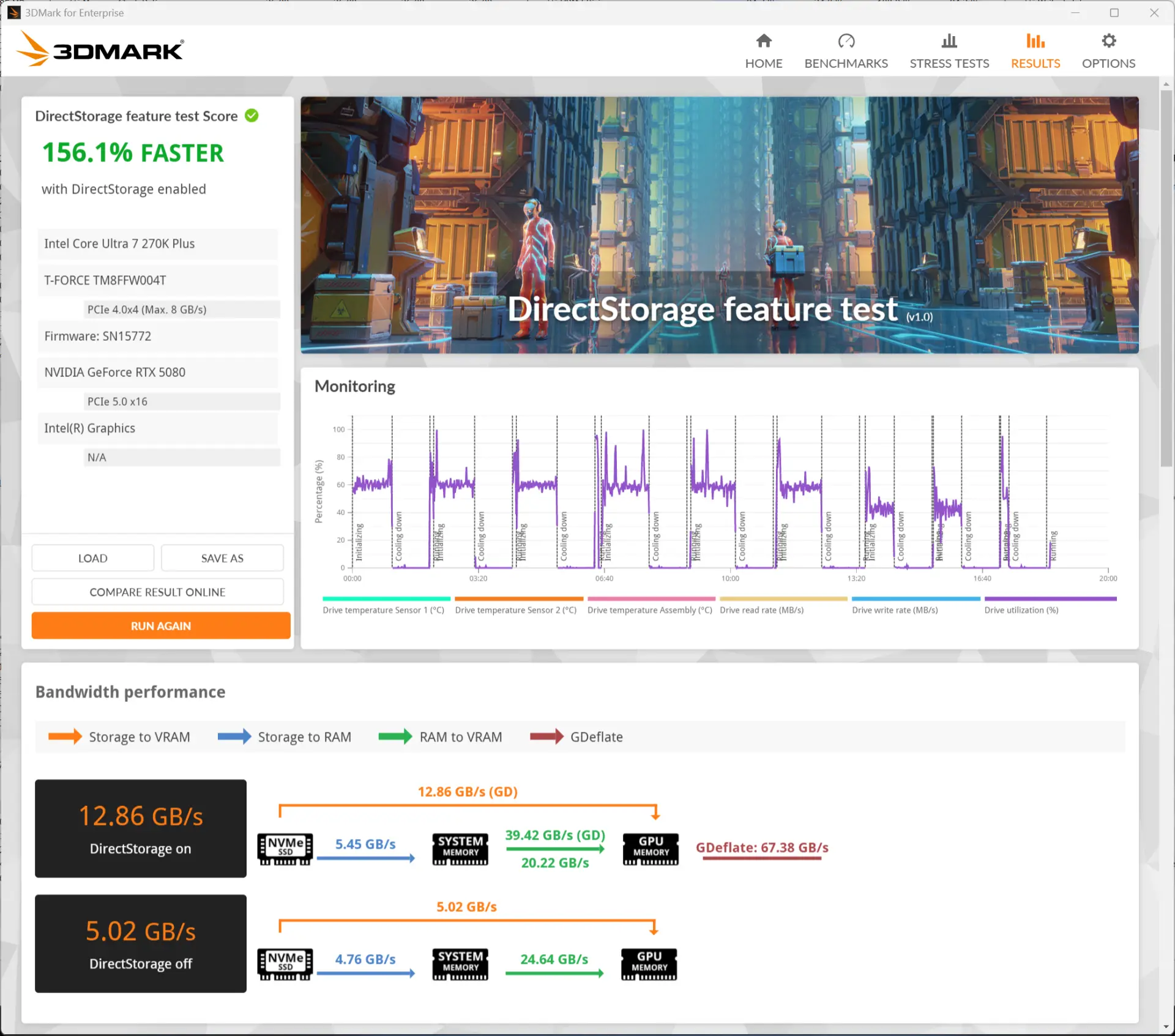

Our final synthetic benchmark was the DirectStorage feature test that measures game data transfer speed with and without DirectStorage. The DirectStorage feature allows faster data movement during gaming by removing as much of the OS overhead as possible, and this leads to faster game asset loading that, in turn, helps to improve the overall gaming experience.
This test did far better, almost matching that of the TB5 D1 SSD Pro, and clearly shows a huge boost in throughput (over two and a half times) with DirectStorage enabled. While that is indeed great, DirectStorage is very much game-dependent, and so the title itself has to support the feature, and unfortunately, its adoption so far has been very limited.

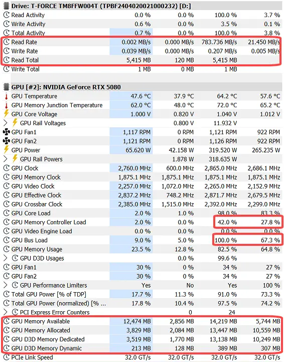

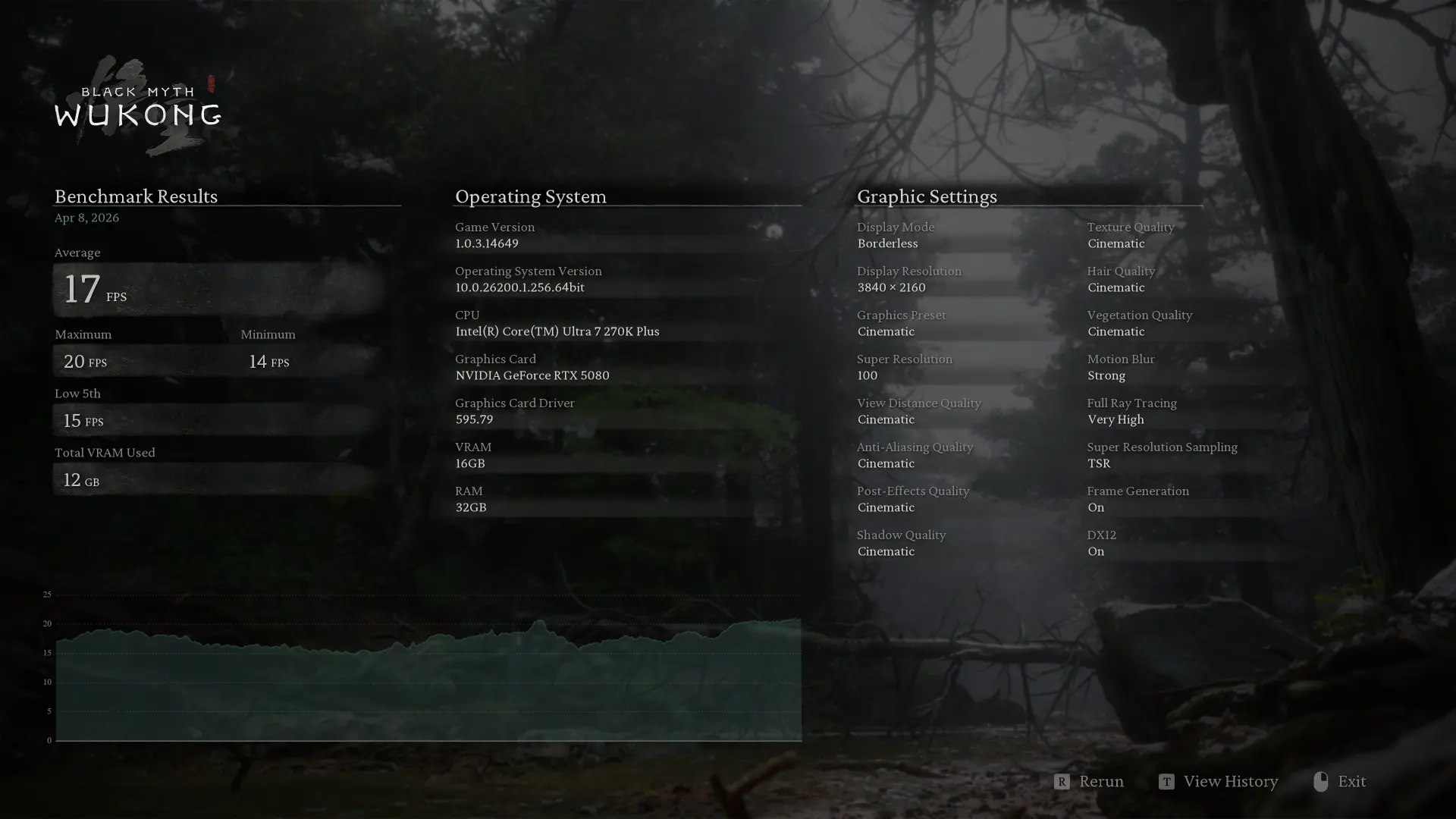

Real-world gaming, you say? Yes. I decided we needed another testing scenario, so I fired up Steam and added a new library location pointing to the ORICO X50. Then I moved Black Myth: Wukong to it, which utilizes high-quality textures heavily, especially in its character models and environment details.
terramaster d1 ssd pro disk enclosure product benchmarks and thermals
With TSR ON and Super Resolution set to 100, at 4K screen resolution, the title saw the ORICON X50 hit nearly 785 MB/s of data flow rate for textures and game asset streaming/loading.
We have also marked the dedicated VRAM usage on our PNY RTX 5080, where we tested this game. As you can see, at these settings with Super Resolution set to 100, we managed to fill up the entire 16GB buffer of the 5080.
Exceeding this would have put additional strain on the SSD, though it's worth noting that the scenario is not realistic, as we tested these at settings which are unplayable in real-life for most people, as the framerate averaged 17 FPS. This was more of an academic exercise.

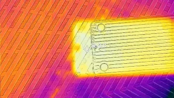

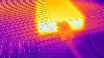

Using my FLIR ONE Gen 3 thermal camera while the benchmark was running, I was not able to record a temperature above 32.2 °C anywhere on the casing (despite HWiNFO recording a much higher max temp of 48 °C inside the enclosure). However, this can possibly be explained below.
