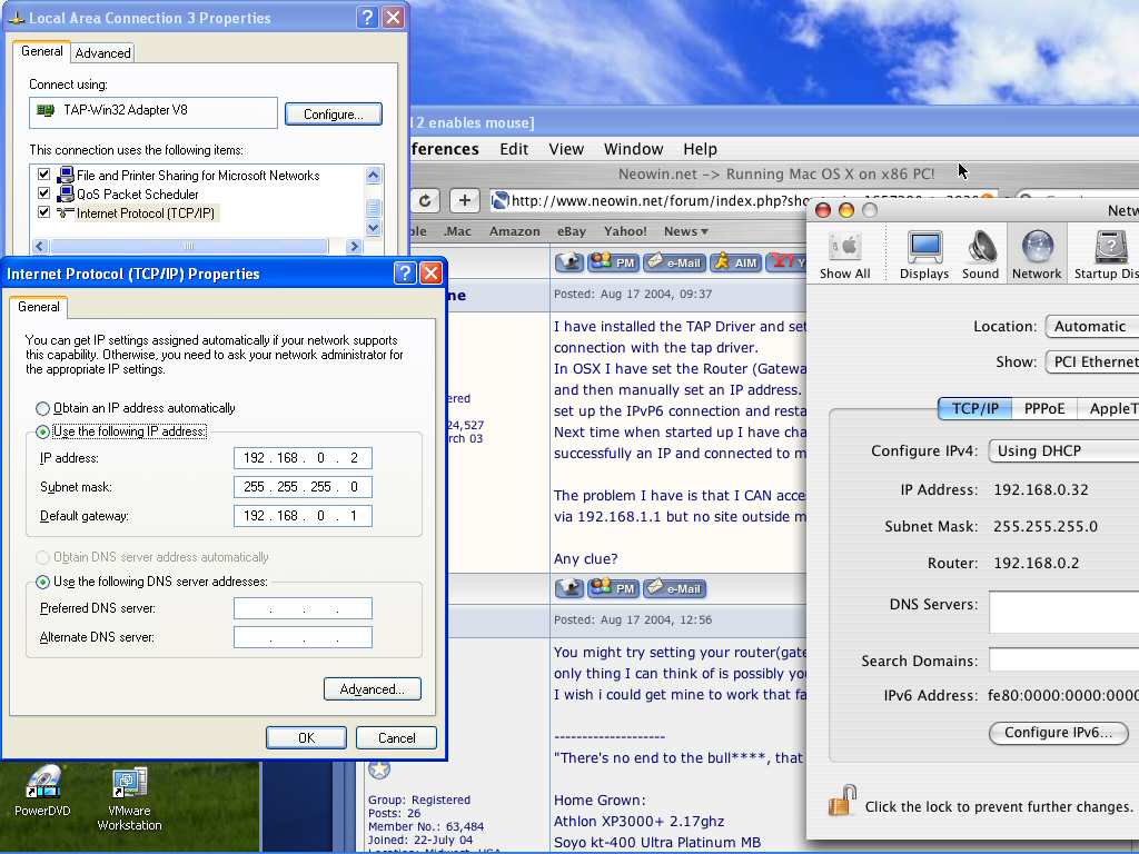

I have installed the TAP Driver and set my Wireless connection to share the connection with the tap driver.
In OSX I have set the Router (Gateway) Address to the IP set in my TAP connection and then manually set an IP address. After having done that I have let automatically set up the IPvP6 connection and restarted the OSX.
Next time when started up I have changed the OSX settings to DHCP and got successfully an IP and connected to my Network.
The problem I have is that I CAN access my Router (DLink DI614+) and can access it via 192.168.1.1 but no site outside my network.
Any clue?
  • 0
You might try setting your router(gateway address to that of your router. Thats the only thing I can think of is possibly your router isnt passing the request on to your is. I wish i could get mine to work that far, mine wont even get an address.
