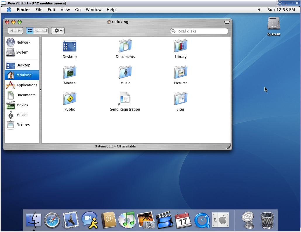

Running Mac OS X on x86 PC!

Is there a way to get the TAP driver working for WinXP SP2? I've installed the OpenVPN Driver (beta 2 and every incremential beta after that) to no avail, even after reinstalls and reboots. The network connection is never shown in the network connections folder, nor is it being detected by PearPC. It *DOES* however show up in the device manager. Also obviously there is no ICS option in SP2's connection advanced tab, so all those pretty guides for WinXP are no longer valid for SP2. What can I do at this point to get networking working on PearPC?
  • 0
I have SP2 and OpenVPN 2.0b2 installed. PearPC runs fine. I don't know what you're doing wrong. :D Maybe I can help you?
First of all, it is not necessary to reboot after installing OpenVPN.
Secondly, make sure you follow the instructions exactly.
Thirdly, ICS will not show up if there are no devices to share the connection with. If you have no other networking devices on your PC (including Firewire) then you won't get ICS.
