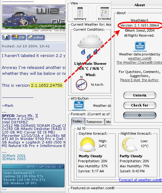

I haven't labeled it version 2.2 yet. 2.1.16xx.xxxxx is 2.2 Beta. Sorry for the confusion.
Anyway I've released another small update; status bar now has icons, and the view toolbar's "forecast" and "radar" icons now change state to reflect whether they will be below or next to the extended info.
This is version 2.1.1652.24756
If all goes well I'll release 2.2 fully tomorrow; it will then show up in auto-updates. Then I would deem it ready to be listed on the front page if you still desire to do so, Mr.Magoo. Let me know if you have any issues, and make sure to send error reports so I can fix crashes...I can't test every situation, and although I've tried to make it robust, some quirks do occasionally come up.
