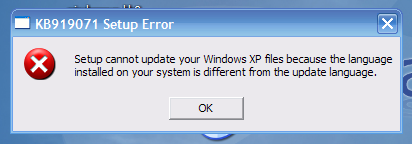

AutoPatcher XP Changelog (jul to Aug 2006)
2) 922481
- installation instructions fixed
What about windows 2000 and wndows 2003 ? installation instructions not fixed ?
7) 895181
- folder renamed (multi-lingual) (old folder deleted)
- setup instructions altered
7) 919071
this file [895181 and 919071] is not multi-lingual
