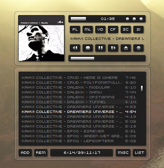

Weird, I can't reproduce this one. You have yours setup something like the pic below yeah?

I'm still trying to get that playlist width problem to appear, but no luck so far. Do you have the PL visualizer turned on? If it's off, the minimum width is shorter, but I don't see how this could affect the show/hide behavior you mentioned.

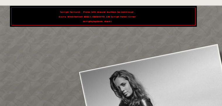

Further to the script errors, I just got this one after closing Winamp from the tray. As far as I can tell, it works fine when closed using the button on the skin, but sometimes crashes when closed from the systray.
If it helps, I was playing music when I closed it, and it had been open for a few hours. Plugin wise, I have the following installed (extra):

** Edited to get decent quality pic, first one was really, really bad **

Appreciate you taking the time to explain the problem so well Sмεη. It's been happening to me too, I just can't understand why it only does it from the systray or taskbar. ?
:) No xelios, you're not alone. I've seen it happen too. I don't have it fixed yet, but I am working on it.
