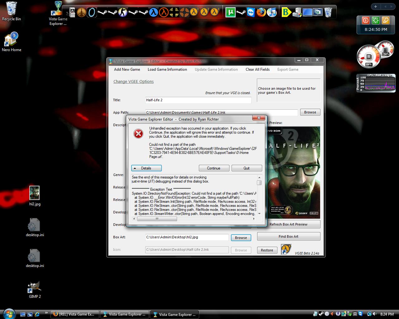

I need some help here, I can't get VGEE to add games, I made sure that VGE was closed, and the works, but when I try to actually add a game, I get this error (attached) from the sound of it, I'm missing a runtime or framework or something, I have .NET Framework 3.5 installed, do I need any others? Thanks.post-274538-1229736675_thumb.jpg
A few people still get that error. If you hit Continue everything should still work - otherwise let me know and I'll disable that command from running
I tried another game, and I think its working now, but let me go try the one that gave me problems again.
EDIT:
Nope, no cigar, same problem, since its obviously a problem with adding the url, let me try it without it.
EDIT of the EDIT:
Now its even worse, I did something and now my auto regenerating game is gone, and manually deleting the folder did nothing, I'm going to clear the keys in the registry, and see if VGE will reset itself.
EDIT OF THE, aww screw it, its an edit:
Would Halo 2 work as an auto regenerating game for this? Because I have a copy sitting around I could use.
Edited by The Shade

I realise I'm a month late (I found this topic whilst Google'ing icons for VGEE), but I can offer help on the Error window.
Go to C:\Users\*YOUR USERNAME HERE*\AppData\Local\Microsoft\Windows\GameExplorer\GamesBoxArt
Now select them all, right click and go to "Properties", and then deselect the "Read Only" box. Then, if you edit the game in VGEE again, it should work.
Hope this helps. :)
Edit: Oh wait, never mind - I thought it was a box art problem. Didn't read the screen shot fully. Never mind.
