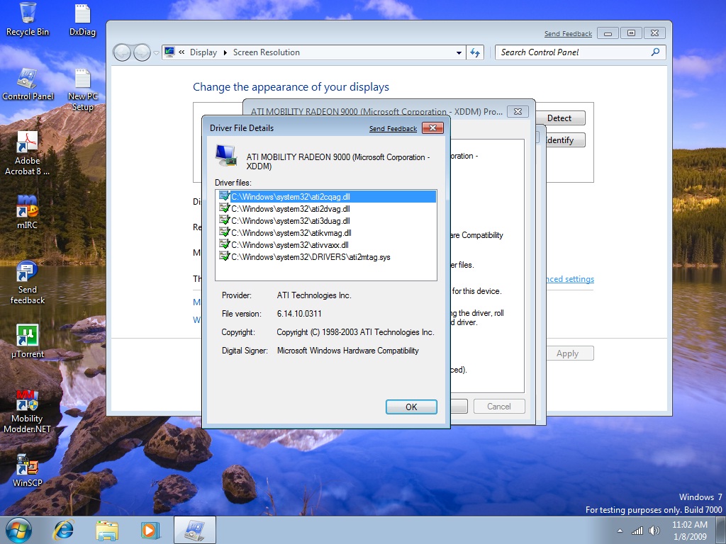

Ive spent the last 4 days playing with various Catalyst versions, custom driver files, etc to no avail at all. I simply think I will never gain support in win 7 due to outdated hw :(. I have an ATI Mobility Radeon 9200.
No Aero, PC comes back as a 1.0 :(!!! :( Windows Update installs some BS Mobility Radeon 9000 WDDM driver that cuases my display to go nuts!
Here is the driver info installed by MS. On my screen when that driver is installed i have lines EVERYHWERE and a double immage. I dont know where else to look for help on this issue.
I also commented on your other post. No DirectX 9 compatible GPU = No Aero.
