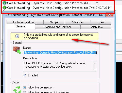

what firewall on the client -- the built in one or some 3rd party.
by default the windows firewall is not going to be blocking dhcp, if you feel its a firewall issue you must have it misconfigured. you should not have to create any special rules for dhcp -- they would be open already.
As you can see they are pre configured rules - and would be set to allow for both ipv4 and ipv6
Edited by BudMan
That picture is from the advanced settings firewall screen on win 7 client.
I can assure you that again you would have to make no specific rules on the 2k3 box for dhcp to work.
client firewall (pctools) <--- lost me on this? So your running a third party firewall on the client?
If you saying it works when you turn off the firewall on the server -- you must of created some rule that is blocking it??
I will take a look at my test 2k3 box firewall rules -- but again I am quite sure there would be default rules to all for it to be a dhcp server.
