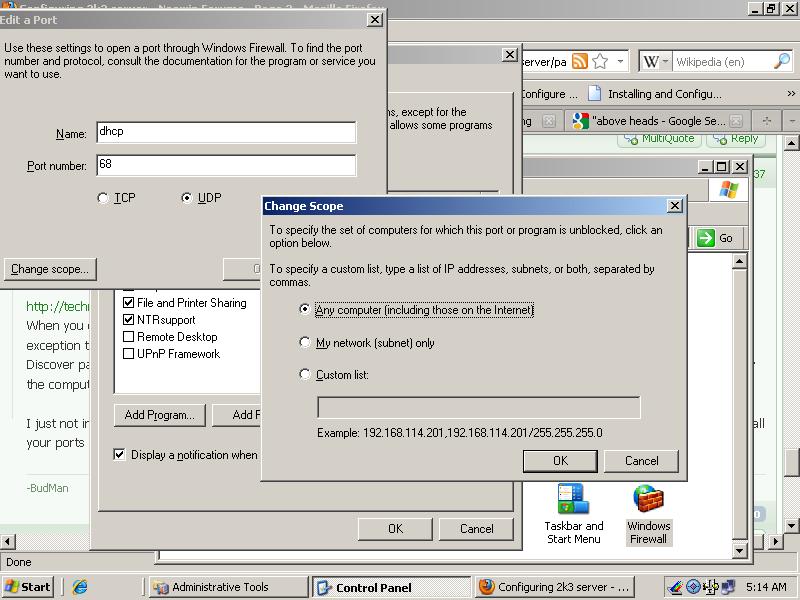

What rule did you setup on the windows firewall??
When you setup the exception on the windows firewall for dhcp - what did you setup as the scope? You need to all of all computer, even internet -- since when a client asks for an ip its going to be coming from 0.0.0.0 not an IP on current network.
http://technet.microsoft.com/en-us/library/cc755393%28WS.10%29.aspx
When you create a Windows Firewall exception for the DHCP protocol on a DHCP server, you must set the scope for the exception to Any computer including those on the Internet. If you leave it set to My network (subnet) only, all inbound DHCP Discover packets from client computers are dropped because the IP address of the packet is 0.0.0.0, which is not recognized by the computer as being part of the local subnet. This causes the DHCP process to fail and clients do not receive IP addresses.

What part of dhcp does not use TCP did you not understand??
To be honest you don't even need to allow 68 because that will never be used inbound to the server
Perfect example of saying you need a firewall - and then not even understanding the protocols you want to block or allow. Which is what causes users all the trouble in the first place, not understanding the basics of what a firewall does.. If they did -- then sure they could make great use of them even on a private network.. You could always be more secure and only allow for the "specific" traffic from the "specific" machines you want to allow.. But since your behind a firewall already, and seems you don't understand how to correctly configure even the most basic firewall a software one is going to pretty much suck up cpu and cause you grief and not provide one ounce of actual protection.
67 is used by the client to send to the server as the destination port, 68 will be the source port.. (discovery)
So when the server answers back it will be sourced from 67 going to 68 -- this is outbound and the 2k3 firewall will not block this. (offer)
client then talks back to server again from source 68 to dest 67 to server which will be inbound traffic (request)
Server than talks back to client to 68 outbound from the server from 67 source (ack)
So that rule you posted is pointless, what does the scope say on the 67 udp exception?
ok, i have deleted those TCP exceptions :)
.. what does the scope say on the 67 udp exception?
sorry, i havent understood this question :huh:
