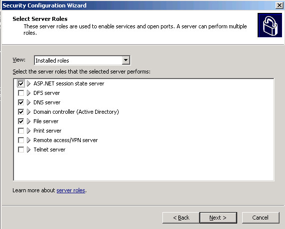

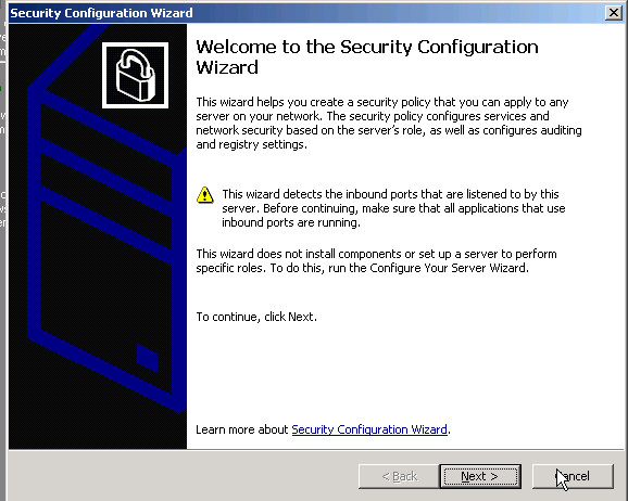

You don't -- Ah, been a while since I had to setup a 2k3 box with the firewall running.. It does do it auto for you -- if you run the WIZARD ;)
After you add a role, or setup the server the first time and are going to be running the firewall on it -- then you need to run the Security Wizard. My Bad I forget how nobody RTFM. Right in the first page on help in installing roles on your server -- which I would of thought anyone setting up a server for the first time would atleast breeze over ;)
Security Configuration Wizard
After you configure roles for your server, you can use the Security Configuration Wizard to create or apply a security policy to the server. For more information, see Security Configuration Wizard.
This auto sets up the rules for you for dns, dhcp, everything that would need to be open after setting up a server or changing its roles -- does everything automatic for you.. You don't have to create specific exceptions for everything.
It sees what roles you have installed - lets you tweak the policy if you want, etc
And creates the rules for the firewall for you
My bad for sure -- should of been more clear on that.. But to be honest I had forgotten about it -- its been awhile since played with 2k3 and running a firewall on it.. Just remembered that the rules were set automatically for you - you did not have to individually create each exception, etc.
Run the wizard -- if not installed, add it under windows components under add remove programs. But again -- and I think sc302 will agree with me, you have little use for the firewall in the first place on secure private network.
hehehe -- I would concur..

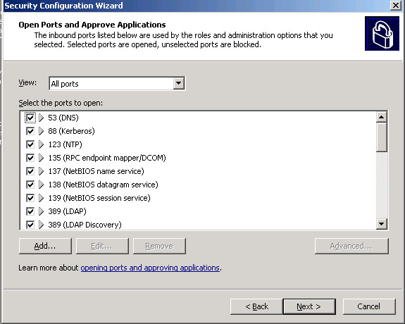

Run the wizard on your AD box, look at all the ports it opens up -- all the ports the box is listening on pretty much. No point in firewalling a port your not listening on anyway -- there is nothing listening to exploit!
Are you going to restrict any of these ports to only specific machines? Or pretty much your going to trust your whole private network? Are there ANY machines that you need to firewall against?? If so your going to have to configure the rules to only allow the specific IPs you want to talk this box. Thats a bit of pain in the ass now isn't it! Be much easier to just not allow untrusted machines onto your trusted network.. Ie the thread about policy of personal machines on a business network comes to mind.

So instead of letting the wizard actually open all the ports needed by a windows server to function correctly on a windows network, file sharing, Active directory, etc. your just going to open up 53..
I would suggest you read
http://support.microsoft.com/kb/832017
Service overview and network port requirements for the Windows Server system

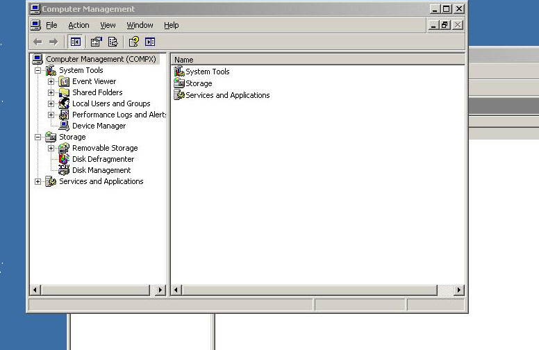

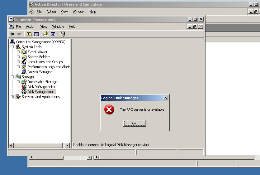

i tried remote computer management via AD users & computers snap-in -> Computers -> Manage.
i succeeded to open all parts of Computer Management except Disk Management (on the client machine).
when i try to open it (even though i turned OFF both firewalls) i get "The RPC server is unavailable".
:blink:
And what account are you authing with?
This question has come up a few times -- if your firewalls are off or correctly configured on both machines, and no antivirus blocking it - it comes down to permission issues.
i have just 1 account on 2k3 - administrator.
i also did what's suggested here:
http://www.tomshardware.com/forum/138472-45-enabling-disk-managment-remote-administration
but to no avail. :shiftyninja:

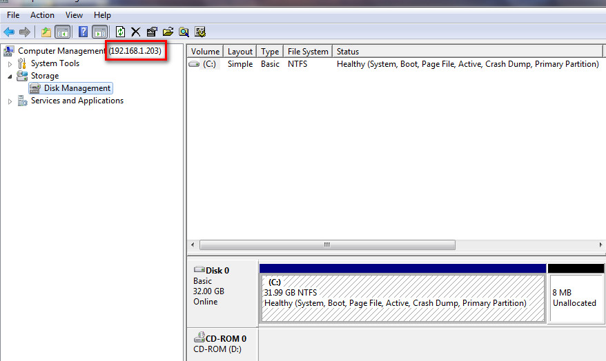

Ok -- lets get some details here on what your connecting from..
Cuz I just fired up my 2k3r2 test domain box.. My win 7 box is not even a member of the domain - but there is a domain admin account that machines my username and password Im logged into on the win7 box
Click click -- Im looking at the remote disk manager the 2k3r2 dc box.
now not running firewall on that 2k3r2 box, nor my win7 machine -- are you having the issue only from xp? What account are you using?
