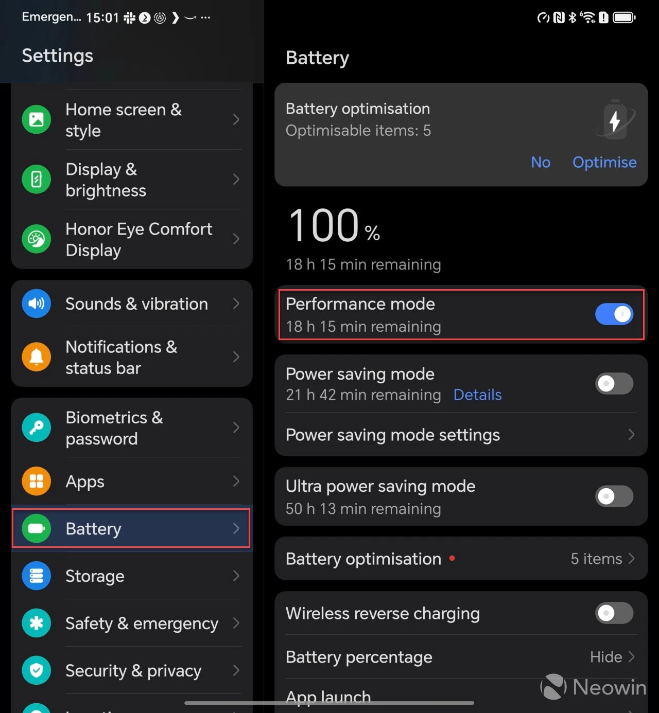

First of all, the reason it is happening, is because HONOR decides that the out-of-box-experience is one where the phone's Performance mode is disabled by default; this is also not made known to the end user, so it's something you have to discover for yourself. A result of that also means that your shiny new Magic7 Pro, or Magic V5 with its Snapdragon 8 Elite underperforms in benchmarks relative to other 2025 flagships with the same CPU. It also means that MagicOS aggressively kills apps in the background completely, which also disables the notifications and Push alerts for those apps.

First off, HONOR says that Performance mode is available on selected devices only, so if you do not have the setting then your HONOR phone is not throttled by default to save battery life.
Honor magic v5
To get around MagicOS aggressively killing apps in the background, enable Performance mode as shown in the above image, and in the steps below:
  1. Go to Settings, Battery;
  2. Toggle Performance mode on

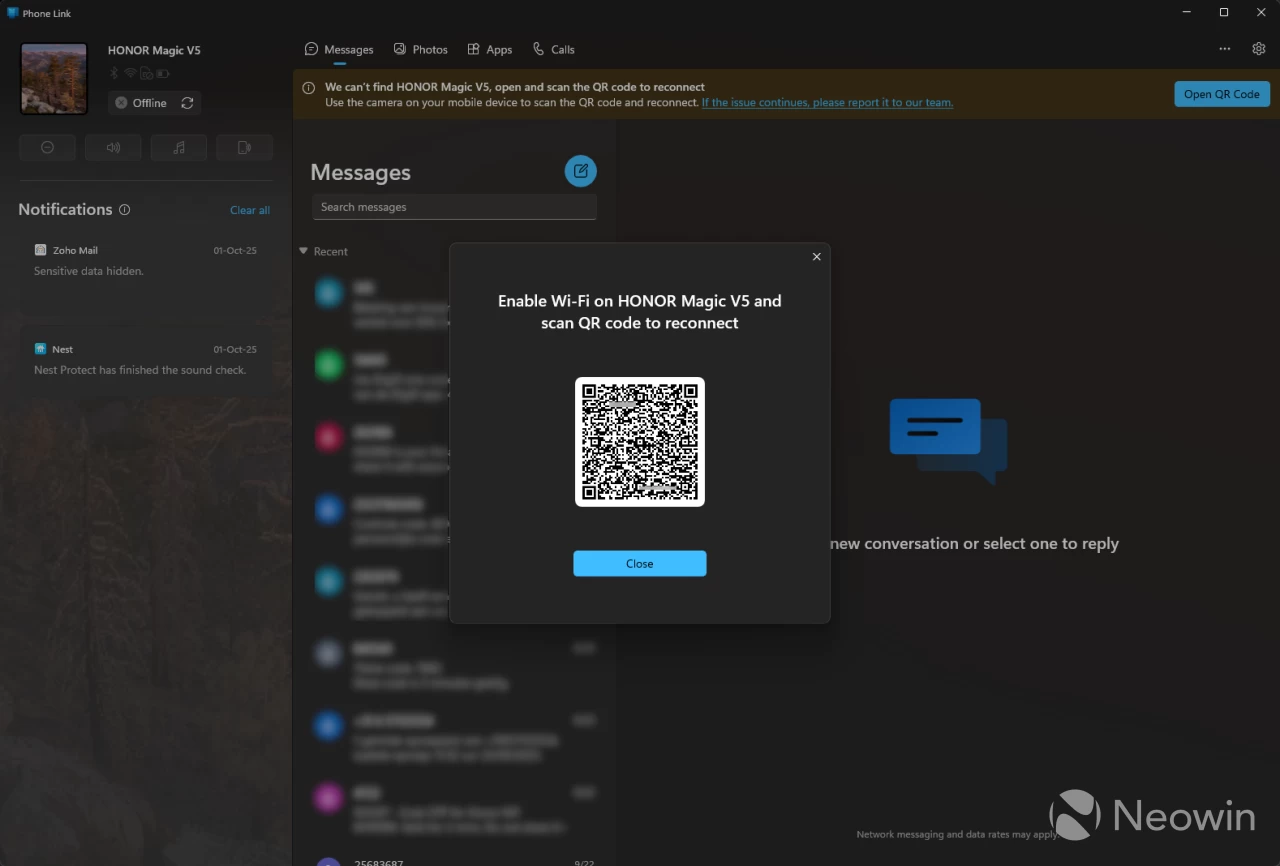

The above (Performance mode being disabled) also affects Link to Windows, which disconnects with the linked PC frequently and is a major hassle to reconnect. You can read about my experience here, but from my own testing, even enabling Performance mode and App Special Access hasn't really helped. Although the phone appears to stay connected longer, it will eventually go offline, and weird issues like the image below will happen, like presenting a new QR code to reconnect.
Link to Windows failboat in Honor Magic V5
One workaround I discovered was to disable and then re-enable Wi-Fi on the Magic V5 would sometimes get it to reconnect, but if you have discovered a better workaround, please let me know so I can update this guide.
