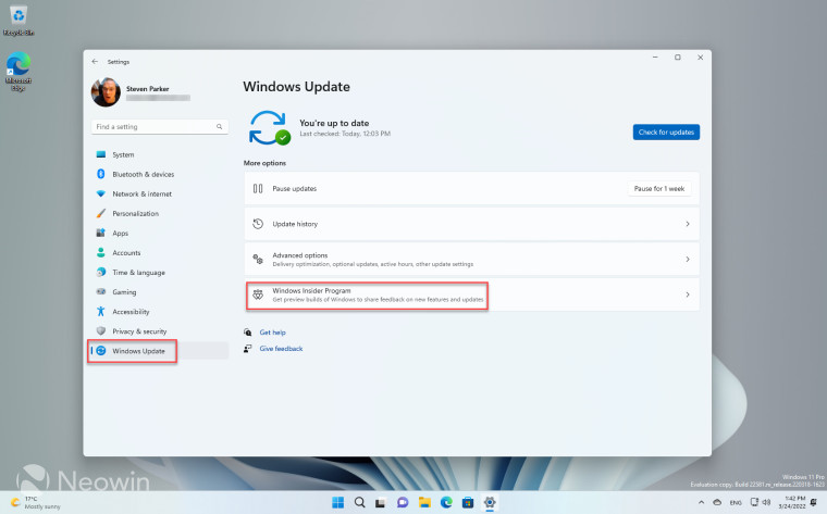

First of all, click on Start > Settings; alternatively, you can right-click on Start and select Settings from the context menu. Now select Windows Update in the left pane and then Windows Insider Program, as shown in the image above to open it.

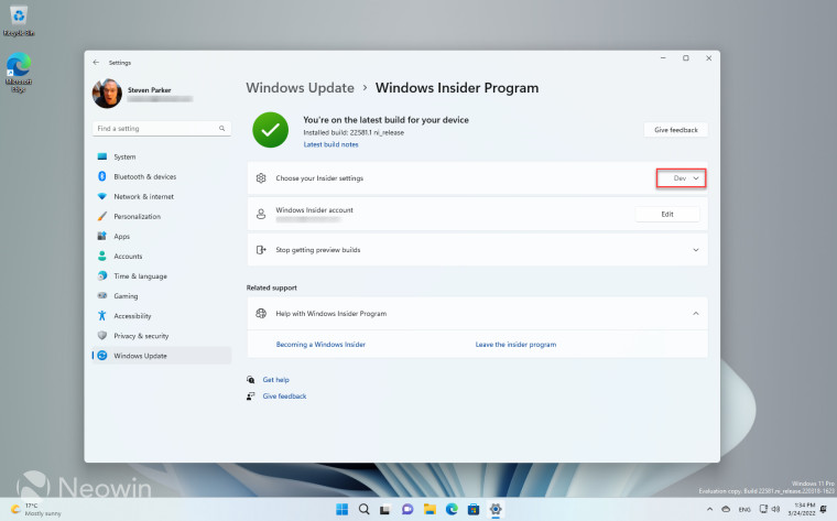

You will see the current build you are on, in this case, we're on the latest 22581.1 build delivered through the Dev Channel of the Windows Insider Program. Go ahead and click on Dev to expand it.
Windows 11 build 22581 screenshots
Here you can opt to move to the Beta Channel, which is what we have done and is shown to be recommended as well. It is currently not possible to switch to the Release Preview Channel, as it has not yet been populated with the Release Preview version of Windows 11. However, we expect this to become available soon, if you have such an option, this lets you receive Cumulative Updates, like for Patch Tuesday, a week or two before general rollout. It is also the channel that will get the next Feature Update (22H2) shortly ahead of general availability.
