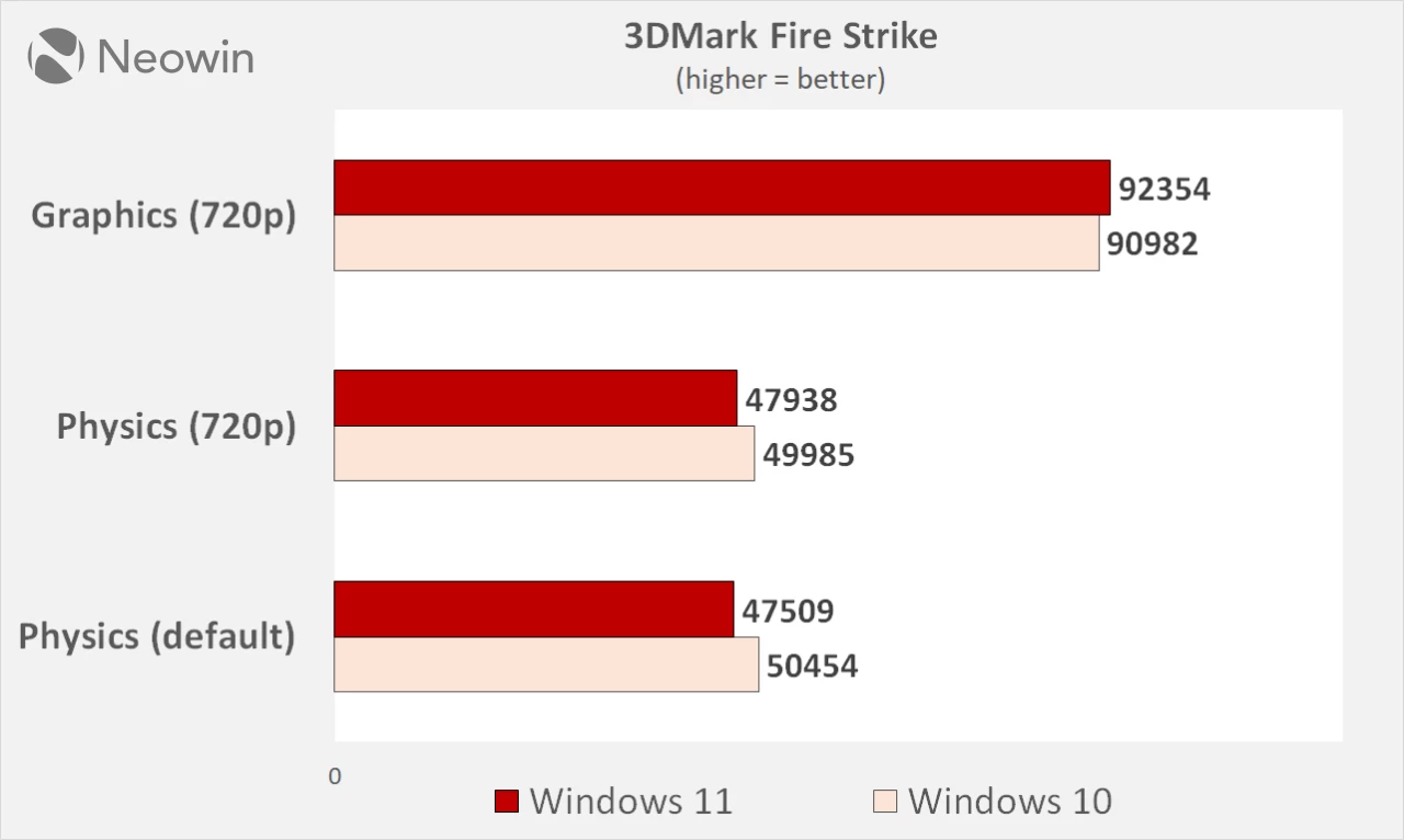

We start with UL Benchmark's 3DMark Fire Strike Physics test. This is a DirectX 11 benchmark and that means it does not utilize too many processor threads. Even then, at the default preset and 720p custom settings we see the CPU on Windows 10 being ahead of 11 by 4.3% and 6.2% respectively. The 720p test shows a wider split as it is even harder on the processor compared to the default setting test.
Windows 11 also picks up a win in the 720p graphics test, and this was surprising as it is counterintuitive given that the CPU test was won by Windows 10. It indicates that Windows 11 actually manages overheads better.

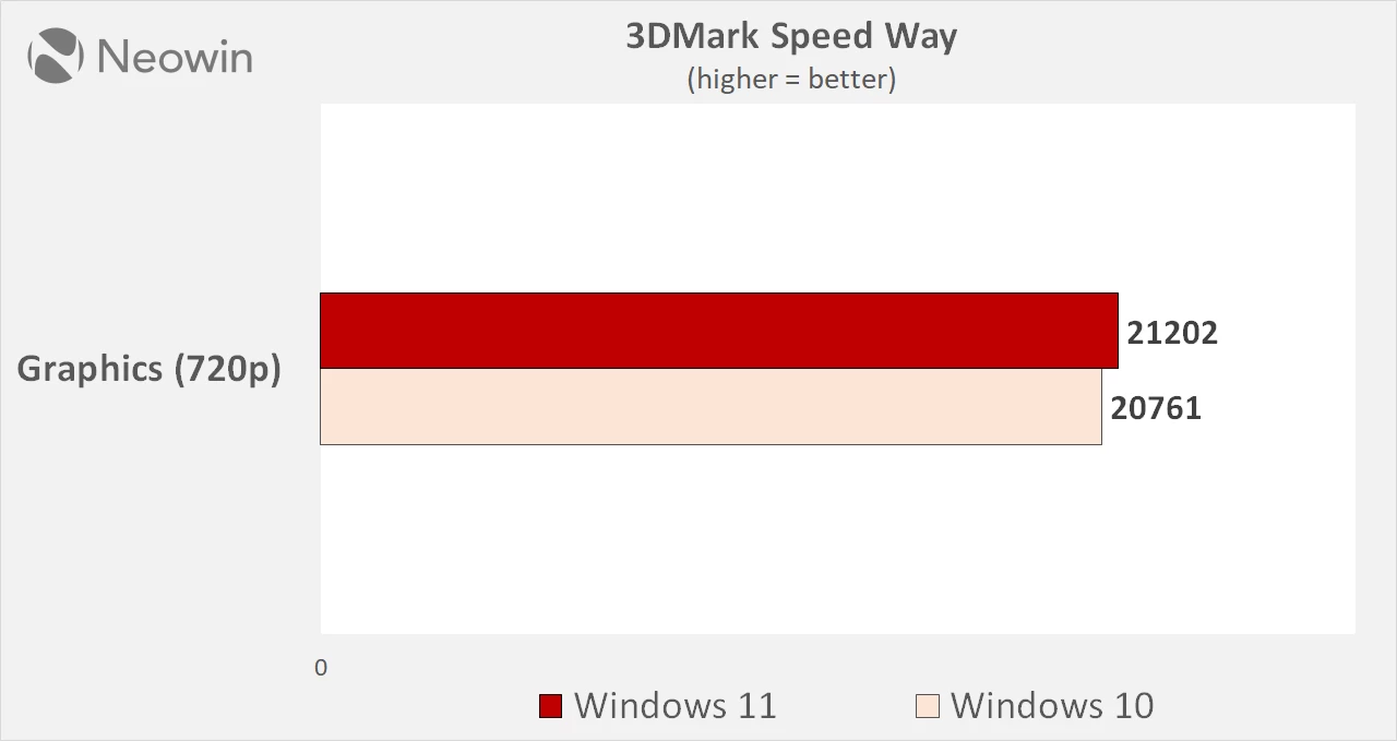

We wrap up our 3DMark data with custom 720p Speed Way where Windows 11 manages to eek out a small win over 10. Speed Way is a DirectX 12 Ultimate test that measures ray tracing (RT) performance and tracing all those rays of light is quite taxing on the processor, although perhaps not as much as it is on the graphics card.
