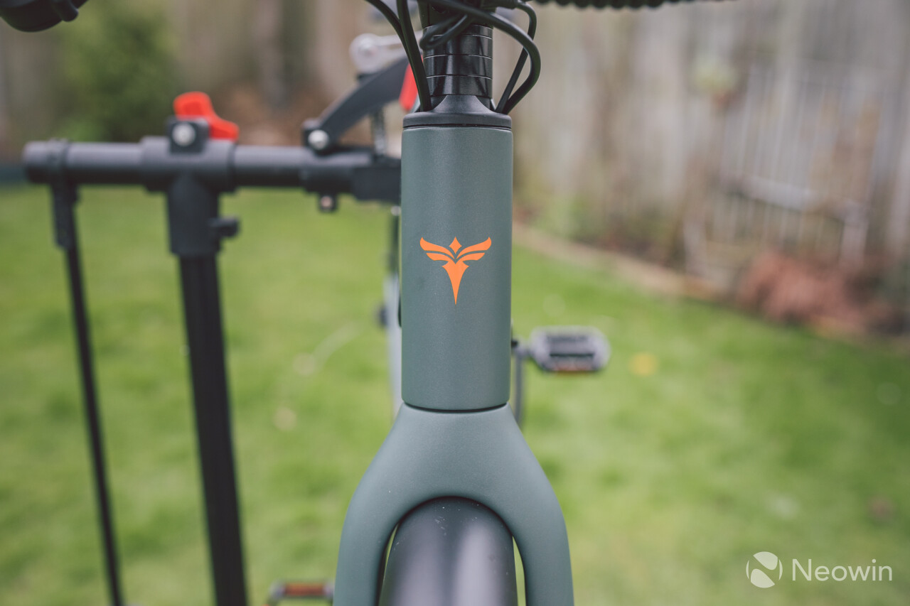

I've been riding the N1 pro for a few months now, and the unique frame design draws a lot of attention, which may not be what you want on your bike, as a decent portion of that might be the kind of attention you don't really like.
Engwe Mapfour N1 Pro
Geometry is important on a bike like this, the seatpost tube only offers a few inches of height adjustment, though the saddle does have the usual adjustment range for slope angle and forward/backward reach. More on this a little bit later.

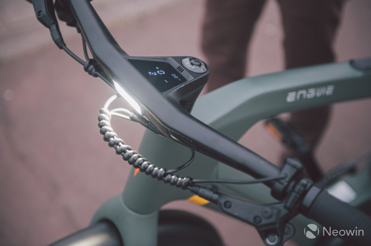

There are several digital features in the design, too, a high beam and low beam headlight integrated into the riser bar is one of them, and this can be activated via the control button on the bar, or remotely using the app thanks to the bike's IoT/BTLE/4G features.
Flanking the headlight are two strips of fully customisable RGB bars for additional visibility...
... Although I see these more as a novelty than a functional feature, I feel that they would have better been served implemented on the back and sides of the bike as tail lights. The rear aluminium mudguard has a battery-solar-powered tail light that activates when darkness is detected and has an idle sleep timeout period, so it isn't going to run the battery down in the middle of the night when stored away. It's a nice touch but has no buttons or a way to control it manually.

This is how it came from the factory, and the use of some cable ties can be used to tuck this further down, though this will, in turn, add some resistance to the turning tension on the front headset as the cabling goes through the stem tube inlet.
Whilst this is a nice touch for keeping a mess of cables from cluttering around the frame, it is something that adds further complexity should there be any issues down the line. It is not yet known if this routing method through the headset stem will affect issues like water ingress that could impact the bearings here.
There is also no cable clattering on the inside of the frame, finally! This was something I complained about on previous models, so it's nice to see Engwe has addressed this.
The display screen is neatly integrated into the riser bar, this has a major plus in that everything is flowing nice and clean, although if it gets damaged then fixing or replacing it could prove troublesome.
I did find a couple of quirks with the display, unlike the LCD on the P275 Pro, this one is just an LED matrix style display, basic but functional. The computer tracks short-term trip mileage, as well as a long-term odometer. Every time you turn on the bike, the short-term mileage travelled is reset, and there is no way to stop this. Both P275 Pro and P20 have the option to reset it manually; otherwise, the trip mileage will continue when the bike is powered on next time.
This is a handy feature because it allows you to track mileage per charge. If it resets every time you turn the bike on, then this breaks this system to track such things, and an alternative way must be used, such as noting down the odometer mileage after every full charge and then noting it again when recharging. I asked Engwe about this and was told that trip memory and manual reset are not features on the new model. This is a shame.

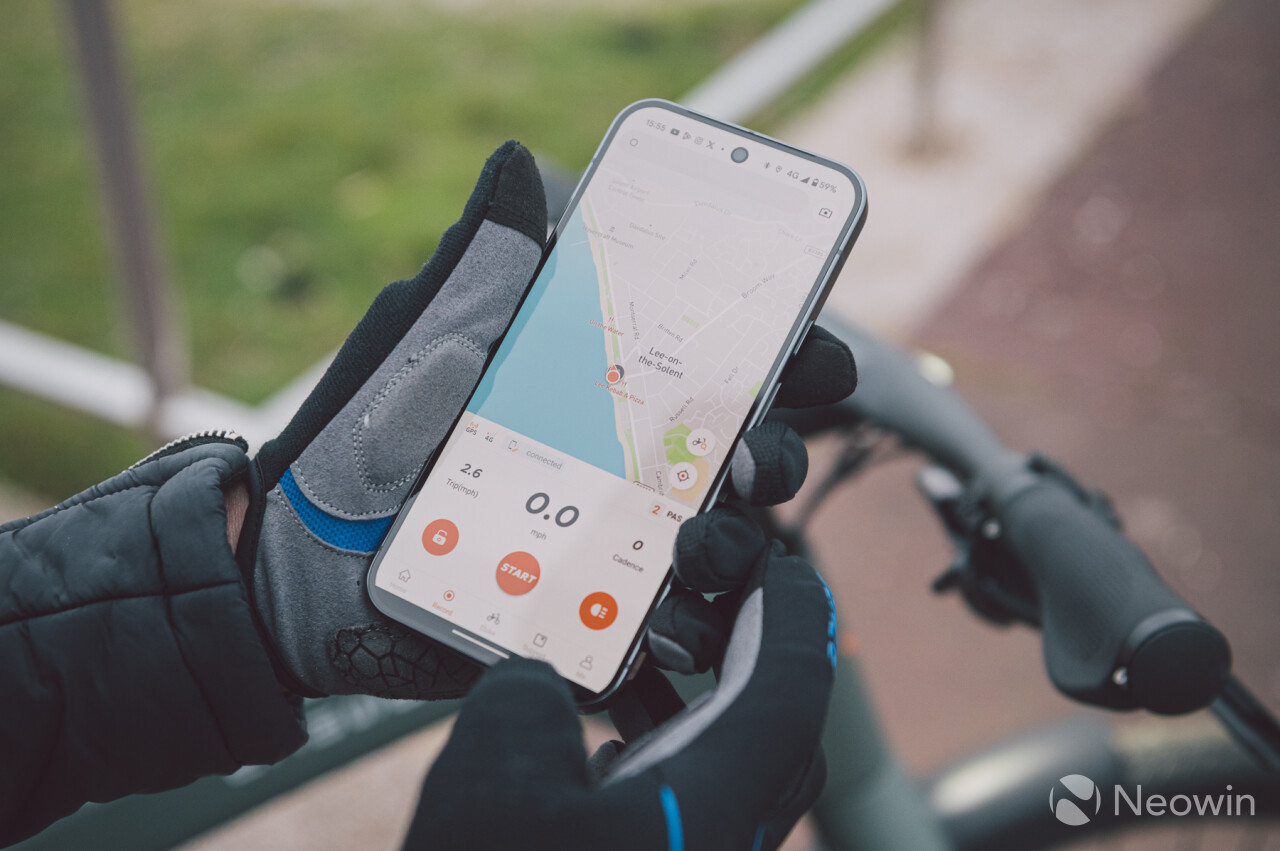

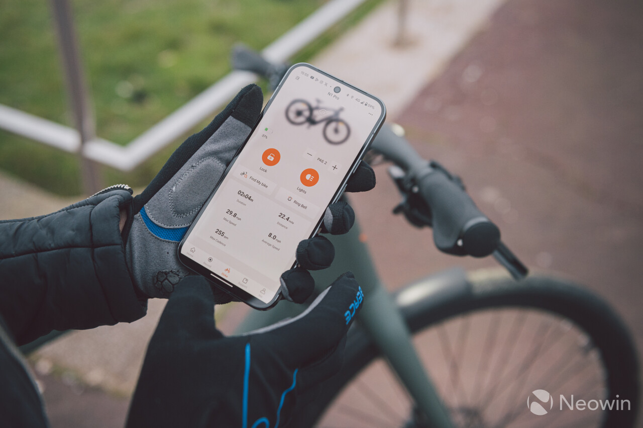

The app
The Engwe app is packed with many features. Those who have used Strava will know what the below screen is all about, offering similar stats features and logging:
From this screen the status indicators give a view of what the bike's condition is like, you can also activate the alarm/lighting remotely this way, too, as well as navigate to the bike if it is carried away by someone.
However, they may not get too far carrying 19 KG since the wheel/crank is immobilised and the alarm is sounding.

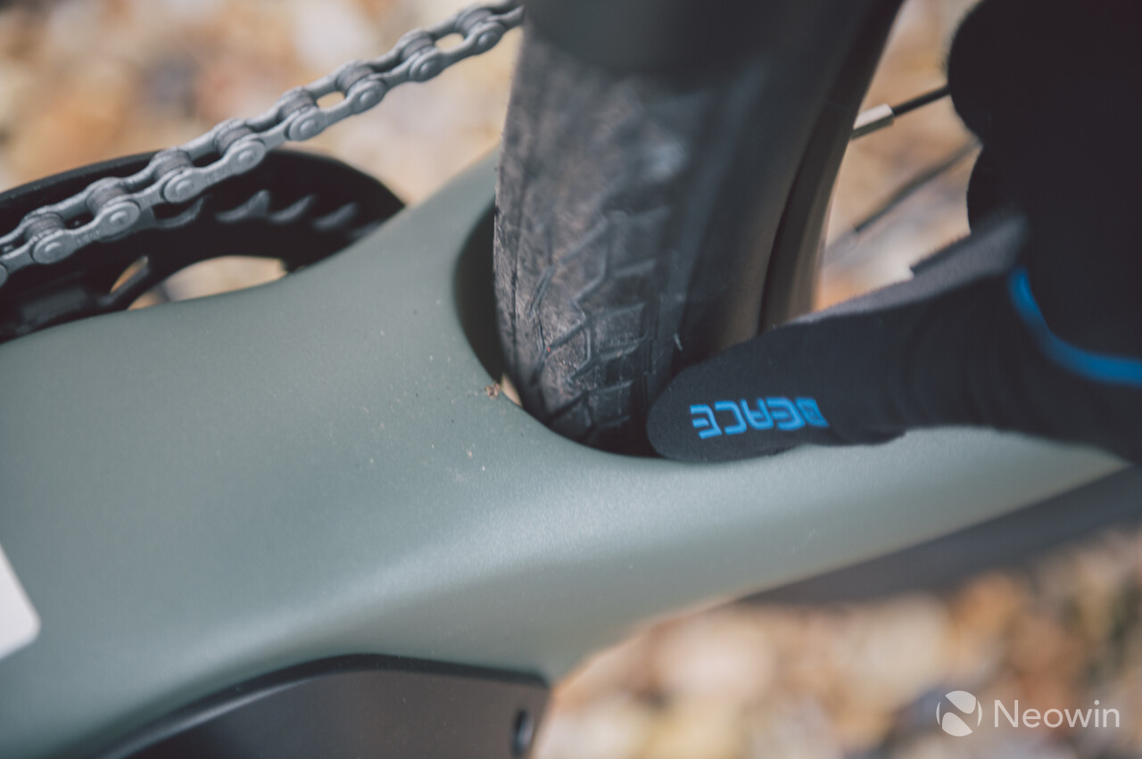

The tyres are thinner than on the P275 Pro, but thanks to the carbon frame and fork, vibrations are absorbed, which results in a more comfortable and smoother ride than that mode, even with thinner tyres.
Those looking to upgrade the tyres to something thicker or with more tread down the line may have limited options as the rear frame (shown above) does not offer much room to fit wider tyres, sadly. This bike can be ridden off-road, as I tested this out, but a tyre with studded tread would be better suited when not riding on tarmac for better grip.
