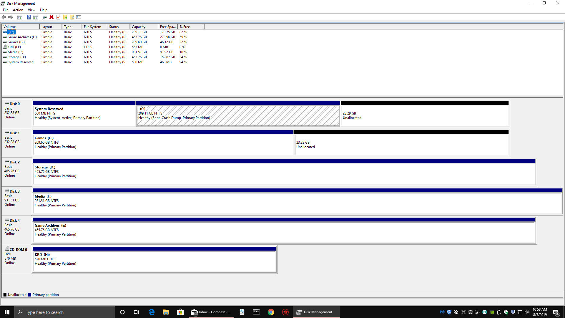

Steven P. Administrators Posted August 6, 2019 Administrators Share Posted August 6, 2019 Right click on the start menu flag and click on Disk Management, there you should be able to see where Windows has put the Boot drive, because it will say it on one of the disks. This will tell you if Windows boots from C:\ D:\ or anyplace else Mine is C:\ Link to comment Share on other sites More sharing options...
devnulllore Posted August 6, 2019 Author Share Posted August 6, 2019 2 hours ago, Steven P. said: Right click on the start menu flag and click on Disk Management, there you should be able to see where Windows has put the Boot drive, because it will say it on one of the disks. This will tell you if Windows boots from C:\ D:\ or anyplace else Mine is C:\ yeah that's what it says on my C drive my G (game drive) just says healthy primary Link to comment Share on other sites More sharing options...
Brandon H Supervisor Posted August 6, 2019 Supervisor Share Posted August 6, 2019 Just now, devnulllore said: yeah that's what it says on my C drive my G (game drive) just says healthy primary hmm yeah then it could be something malicious. I'd scan it with the Kasperskiy bootable recovery disc I mentioned above to verify and then you shouldn't have an issue deleting the folder from that bootable media either. If for whatever reason your computer won't boot up after you delete that folder you can pop you installation disc/usb back in and run the boot repair Link to comment Share on other sites More sharing options...

Ve7878 Posted August 7, 2019 Share Posted August 7, 2019 Could you post a screenshot showing disk management? Windows Key + X > Disk Management Link to comment Share on other sites More sharing options...
Brandon H Supervisor Posted August 7, 2019 Supervisor Share Posted August 7, 2019 6 minutes ago, Vince800 said: Could you post a screenshot showing disk management? Windows Key + X > Disk Management he confirmed his matches steve's screenshot above already Link to comment Share on other sites More sharing options...

Ve7878 Posted August 7, 2019 Share Posted August 7, 2019 2 hours ago, Brandon H said: he confirmed his matches steve's screenshot above already Yes but in my opinion it's worth checking just to make sure everything else looks okay. 2 hours ago, devnulllore said: I ran the rescue disk and deleted the boot folder but still accesses the drive and causes hitching (system pauses) when it does. Do you get a system pause every time you access the drive, even if you close it and go straight back into it. Although it's an SSD I wonder if it's some power saving option at play causing this issue. Brandon H 1 Share Link to comment Share on other sites More sharing options...
