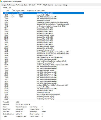

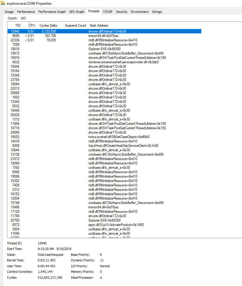

sc302 Veteran Posted August 20, 2019 Veteran Share Posted August 20, 2019 If you double click on explorer exe in process explorer, and go to the threads tab you can see what is using how much cpu and narrow down to the exact dll/exe that is causing your issues. You could further narrow down to see what other dll's/exe's are being called by using the thread button. Then you can research what the dll/exe is and/or associated threads and identify/disable/rename those files so they stop being called. There could be a fix without reinstall. Link to comment Share on other sites More sharing options...
