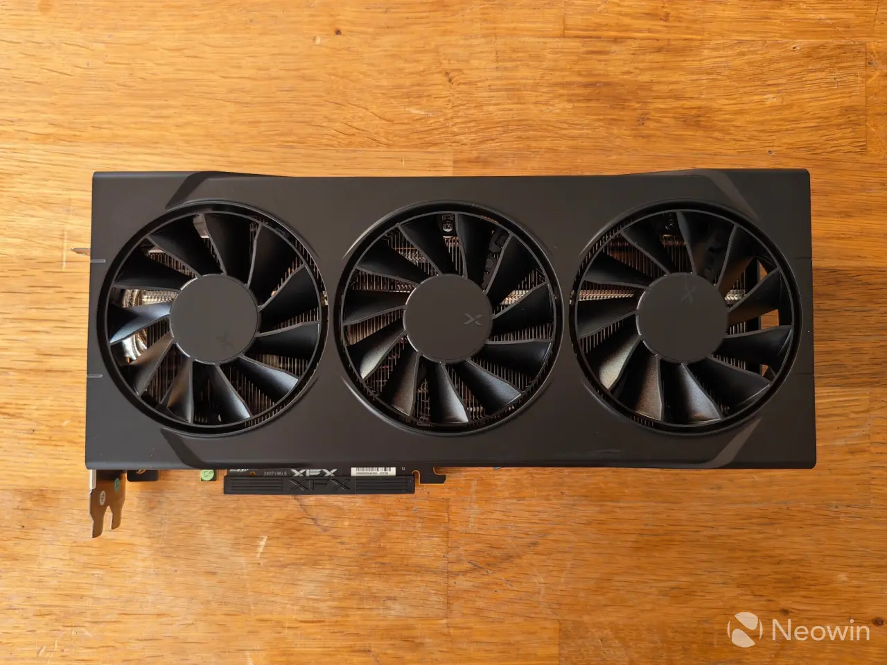

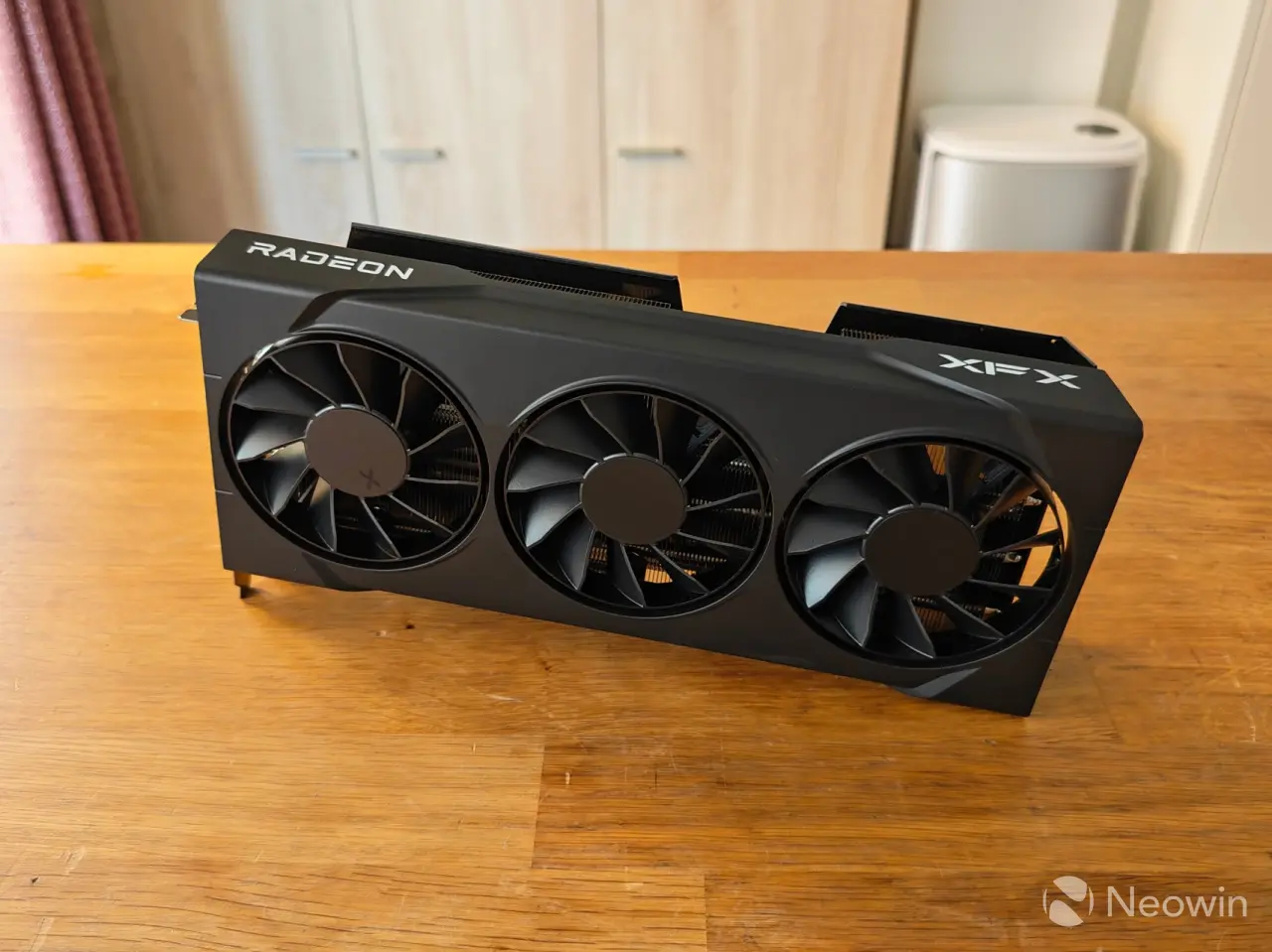

Moving on, the RX 9070 GRE we were given is an XFX Swift triple-fan, dual-slot design with two 8-pin connectors. At 30cm (self-measured), it will fit in most systems easily. There is no RGB either.
The AMD Radeon RX 9070 GRE by XFX from all angles.

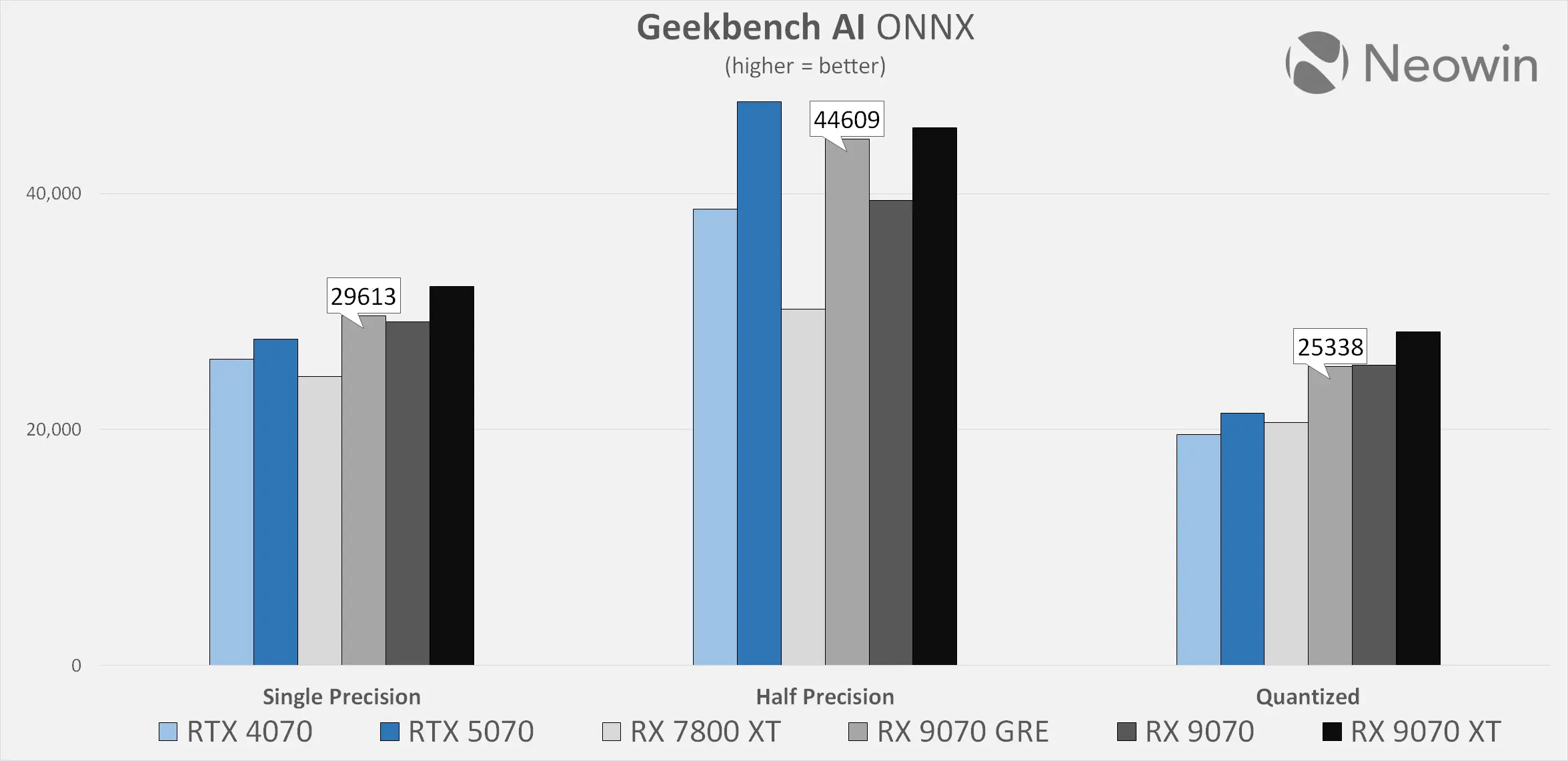

AMD shared a press driver based on the recently released Adrenaline 26.5.2 that we were required to use. We now move on to our benchmarks. First up, we have Geekbench AI running on ONNX.
XFX AMD Radeon RX 9070 GRE Neowin review benchmarks
For some reason, the 9070 GRE does exceptionally well here in both half-precision (FP16) and single-precision (FP32). It manages to beat the RTX 5070 and RX 9070 non-XT, and is only behind the 9070 XT. Since Geekbench runs in short bursts instead of continuously hammering the graphics card, it seems the GRE's faster boost clocks are helping here.

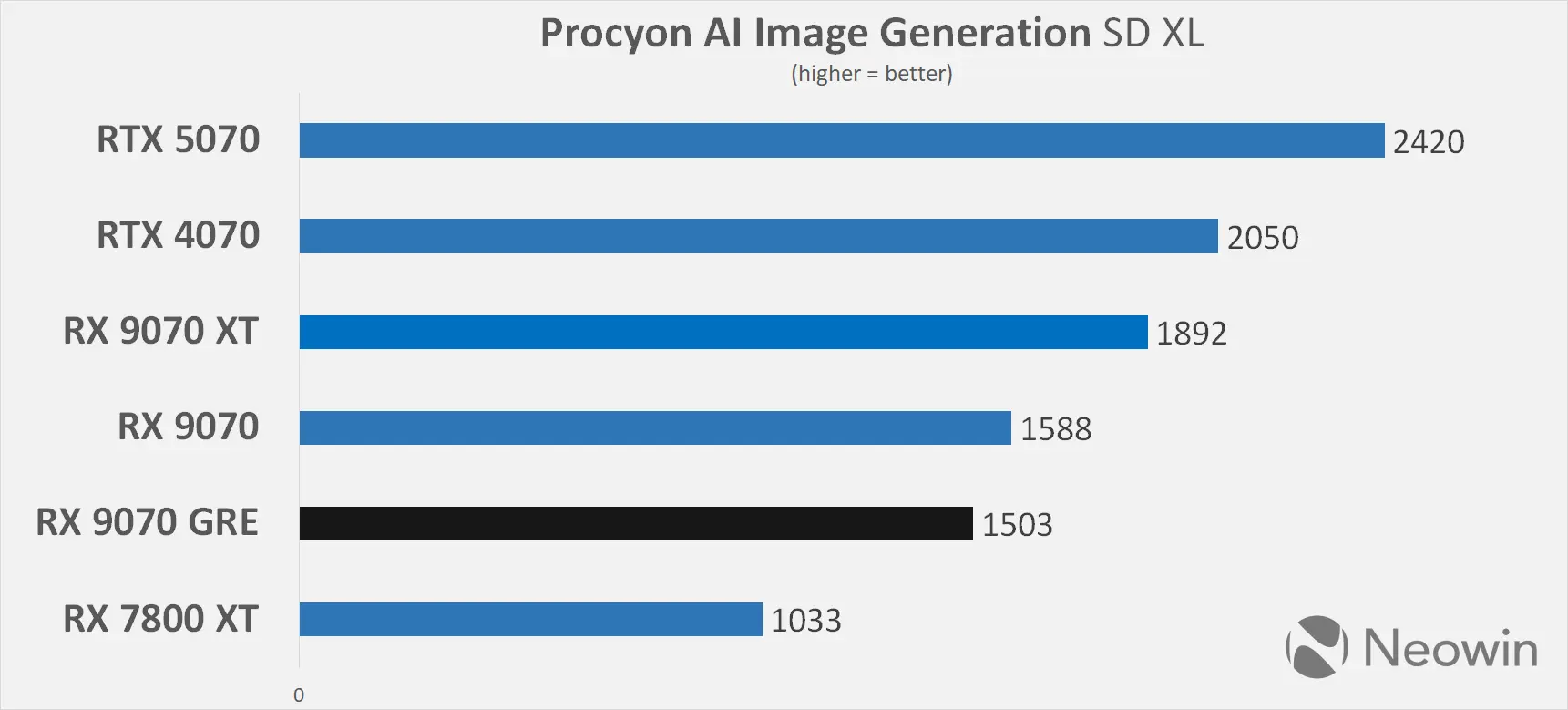

Next up, we move to the UL Procyon AI test suite, starting with the image generation benchmark.
We chose the Stable Diffusion XL FP16 test since it is the most intense workload available on Procyon. The Nvidia cards do very well here, as even the 4070 out-muscles AMD's best fairy easily.
The positive thing about the GRE is that it gets quite close to the 9070 non-XT in this test; this indicates that the VRAM does not play a very big role here, as SD XL relies on float16 (FP16). So this is something to keep in mind again. If you wish to work with float32 AI workloads, graphics cards with larger than 12 GB buffers would likely emerge as victors. Regardless, the gains are still massive on AMD's 9000 series compared to the 7000 series.

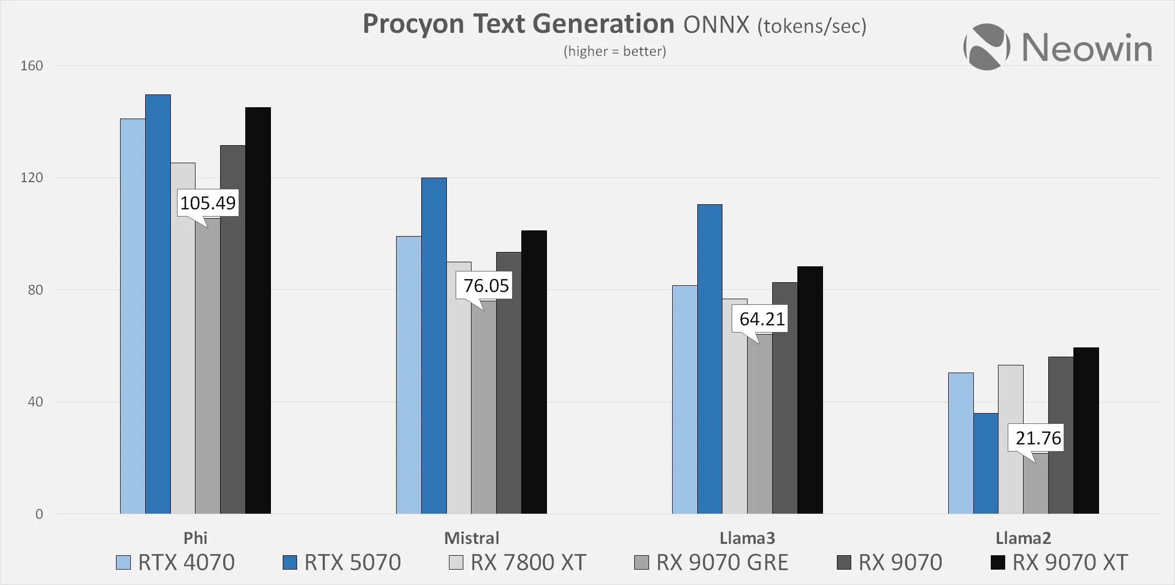

Following image generation, we move to the text generation benchmark.
This is one test where the 9070 GRE struggled, quite a lot. It seems that the 12 GB VRAM and lower memory bandwidth of the new Radeon 9070 GRE are hurting it quite a bit; the split is massive, especially in a test like Llama2, which packs 13 billion parameters. As such, in all the tests, the 9070 GRE is the slowest of the lot.

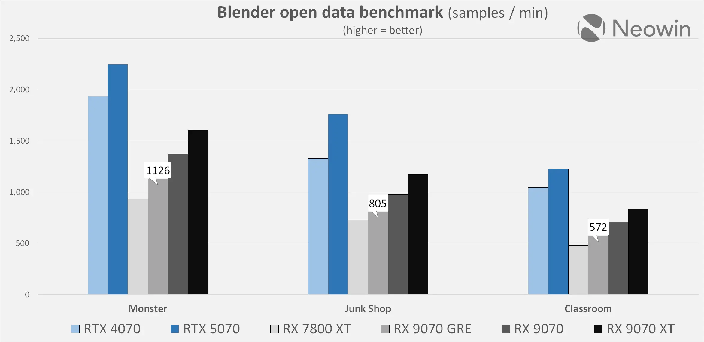

Next, we tried Blender, and here the AMD GPUs were beaten by Nvidia. Rendering is something the Green team has always had a lead over the Red side, and it has not changed so far. On the positive side, though, the 9070 GRE shows significantly better results than the 7800 XT, which means AMD is on the right path. Catching up to Nvidia, though, will require a lot more effort. And we hope HIP and ROCm can keep improving.

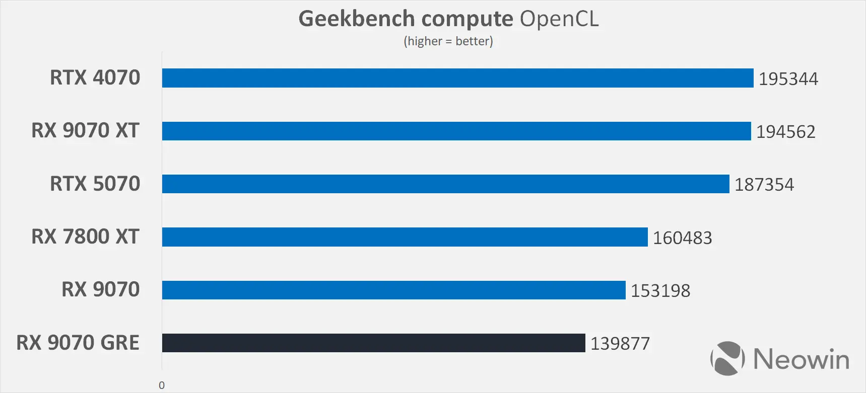

Wrapping up AI testing, we measured OpenCL throughput in the Geekbench compute benchmark.
The RX 9070 GRE alongside the 9070 did not fare well here at all, even falling behind the 7800 XT. Interestingly, even the RTX 5070 could not beat the 4070 on OpenCL, so perhaps this suggests that OpenCL optimization may not have been a priority for either AMD or Nvidia in the modern era.
