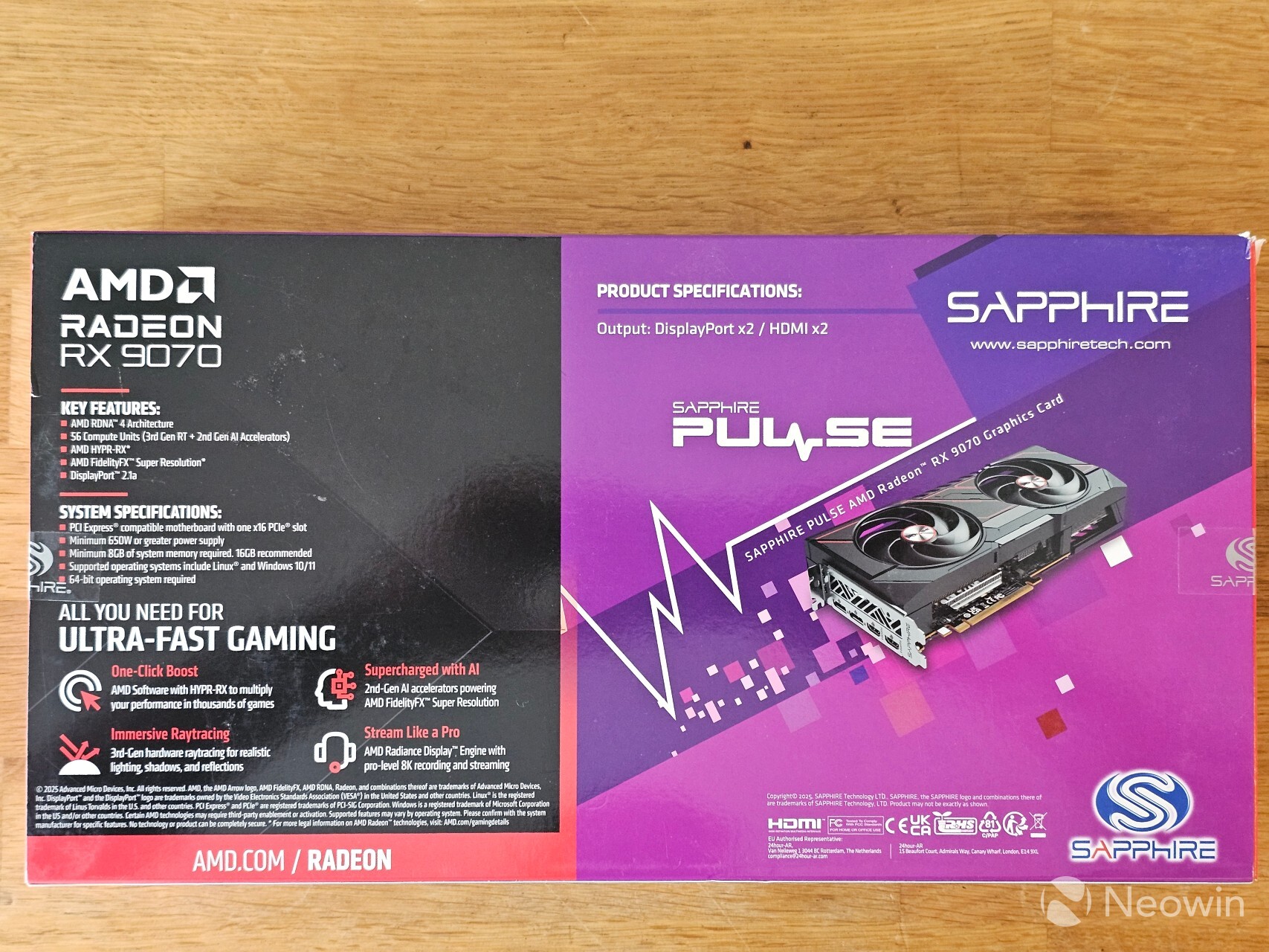

amd rx 9070 made by Sapphire

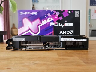

Moving on, the Sapphire Pulse is a dual fan, dual slot design with two 8-pin connectors, and at 28cm will fit in most systems easily, even though it dwarfes our 5070 FE in size. There is no RGB on the RX 9070 either, not even the naming on the side lights up, which is a shame, considering it is priced $200 over MSRP at $749 on Newegg.
The Sapphire Pulse RX 9070 from all angles.
As you may remember from our 9070 XT review, the 9070 looks pretty much the same as the Sapphire Pulse RX 9070 XT with the main differences being dual fan, dual slot versus triple fan, triple slot on the XT variant which significantly reduces its overall size versus the XT variant.

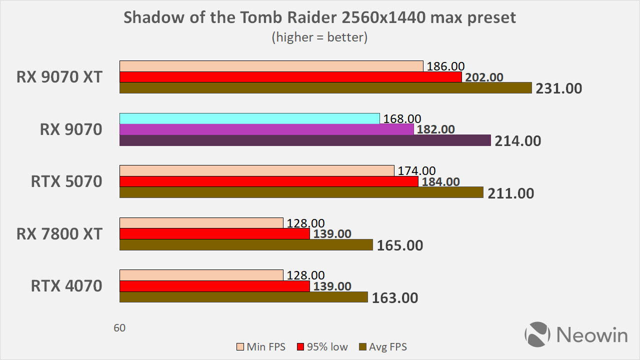

In 2018's Shadow of the Tomb Raider, based on the Foundation Engine, the 9070 and 5070 are essentially tied. And it's not just the averages, even the percentile lows are very close.

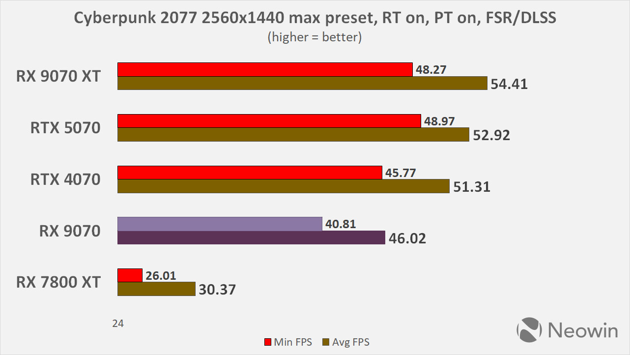

AMD also touted its path tracing enhancements on RDNA 4, so we have taken a look at it too.
As you can see in the image above, AMD has made quite an extraordinary jump in ray-traced Cyberpunk 2077 that runs on the Red engine. The 9070, although not quite as good as the 5070 here, however, it does easily manage to trump the last gen GeForce 4070. Meanwhile, the RX 7800 XT is not even in the same league.
The company explained in detail during its presentation about the ray traversal and shading upgrades RDNA 4 brings. You can learn about it here in our dedicated piece.
So, while AMD has clearly improved by a lot, Nvidia is still ahead in situations of path tracing or very intense ray tracing.

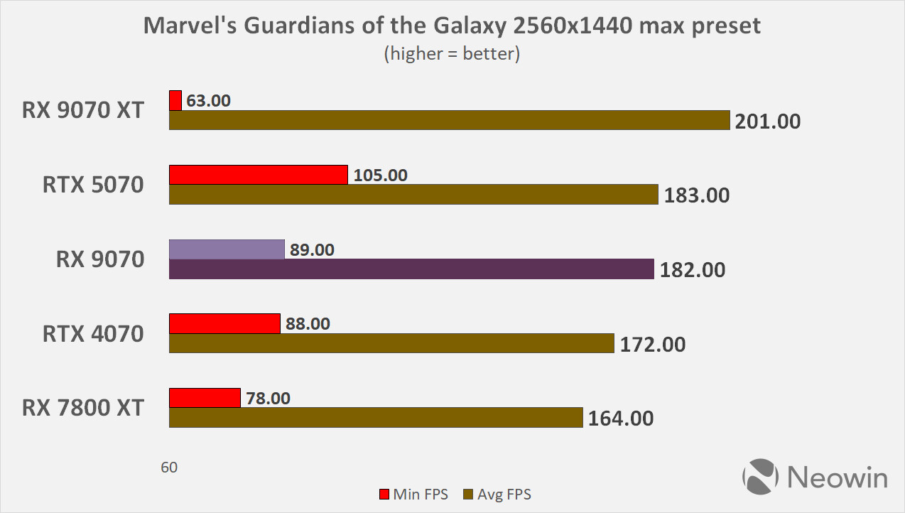

Marvel's Guardians of the Galaxy saw the 5070 and 9070 almost neck and neck once more in a Dawn engine title, at least when it comes to averages. So it looks like this engine in particular does not favor Radeon GPUs all that much. Once again, similar to Far Cry, we see another instance of lower minimums on the 9070 XT.
