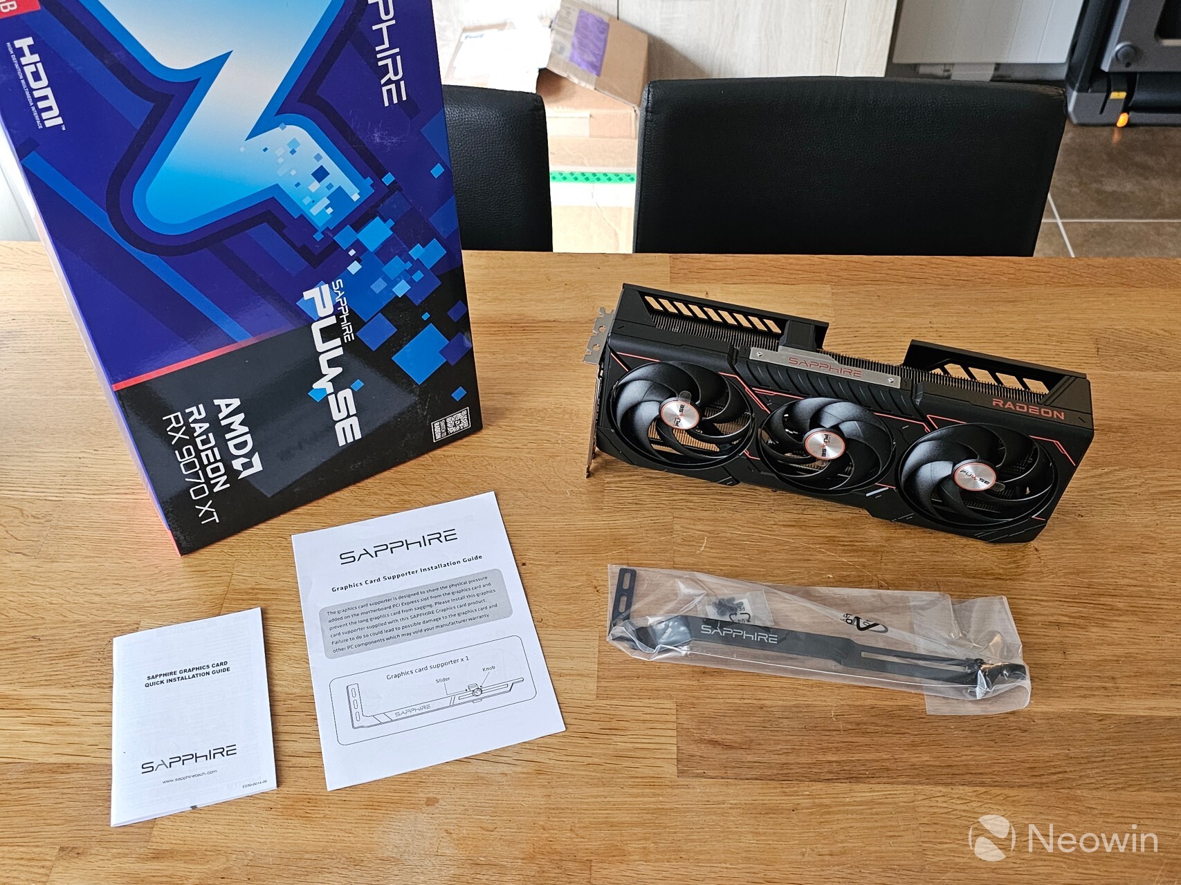

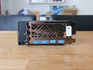

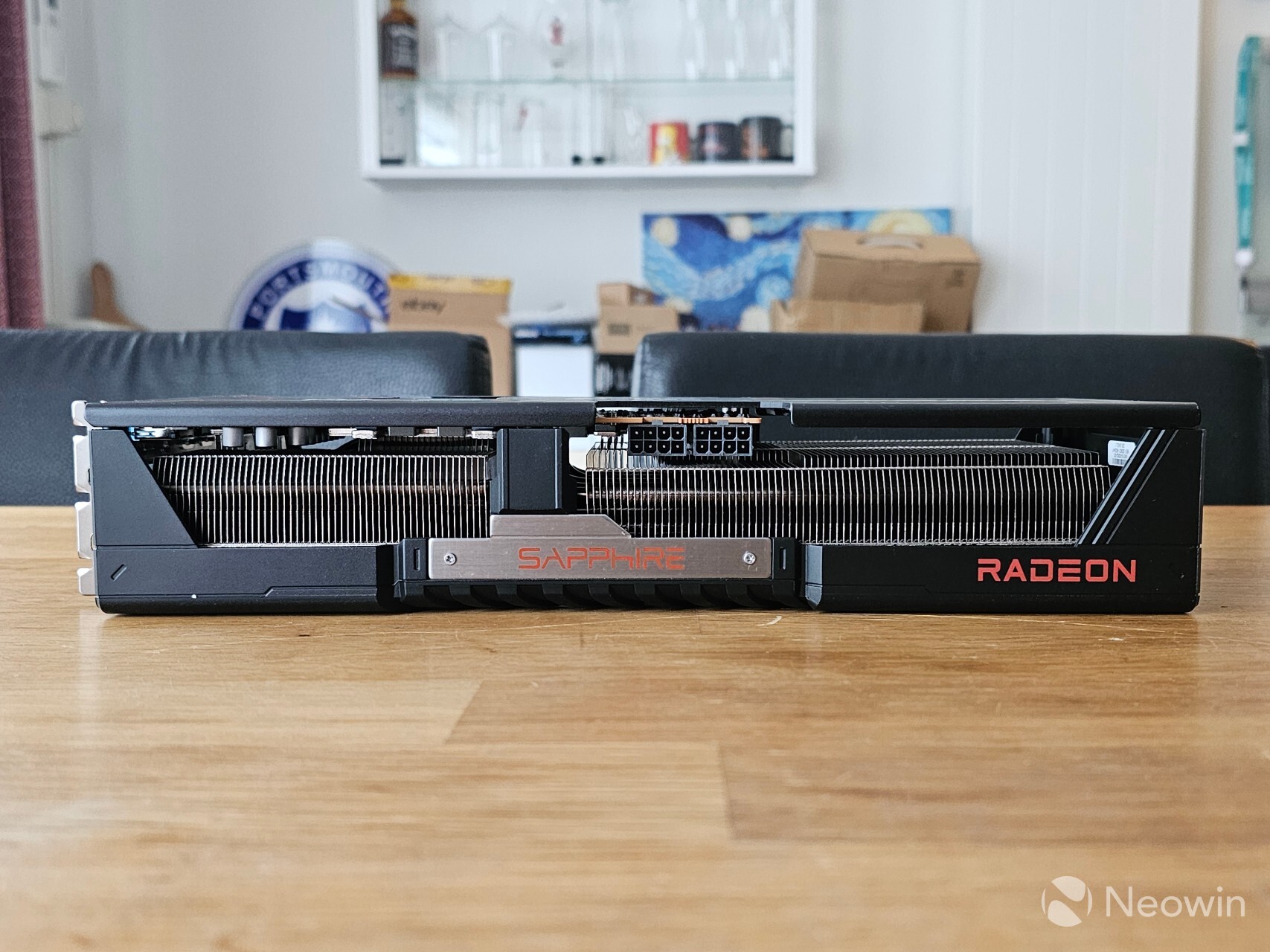

The Sapphire Pulse is a three slot design with two 8-pin connectors, and at a (self measured) 32.5cm it can only be installed in our NR200P Max system by taking off the back plate, which holds the rear of the GPU in place. For size it resembles a 7900 XTX, even though our 7900 XTX Phantom Gaming is actually a two slot design.
On the left Sapphire Pulse 9070 XT, on the right RX 7900 XTX Phantom Gaming 24GB OC
As you can see, the 7900 XTX still edges out the Sapphire Pulse in size, but only just, and also if we ignore the larger three slot design on the rear of the card.

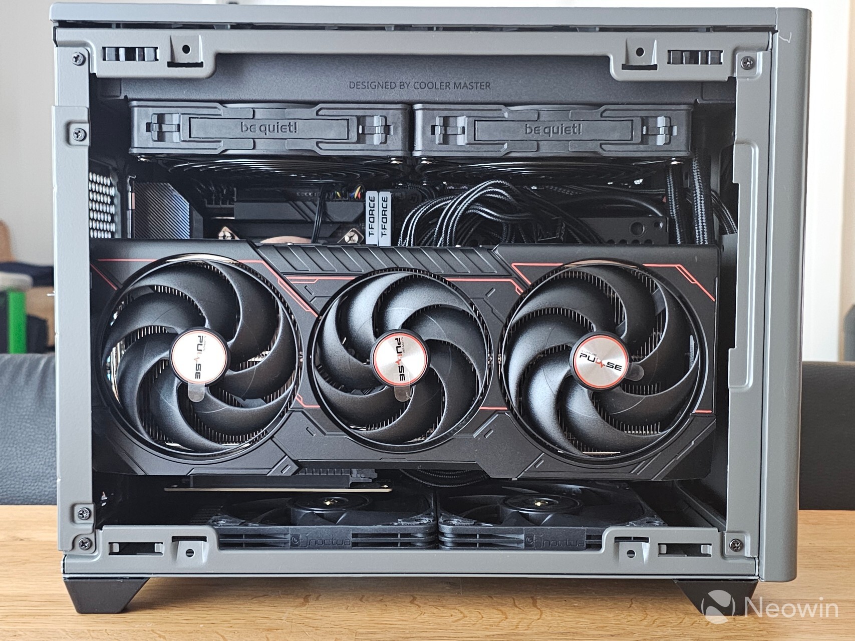

Test system
Our test system consists of the following
  • Cooler Master MasterBox NR200P MAX
  • ASRock Z790 PG-ITX/TB4
  • Intel Core i7-14700K with Thermal Grizzly Carbonaut Pad
  • T-FORCE Delta RGB DDR5 (2x16GB) 7600MT/s CL36 (XMP Profile)
  • 2TB Kingston Fury Renegade SSD
  • Windows 11 24H2 (Build 26100.3194)

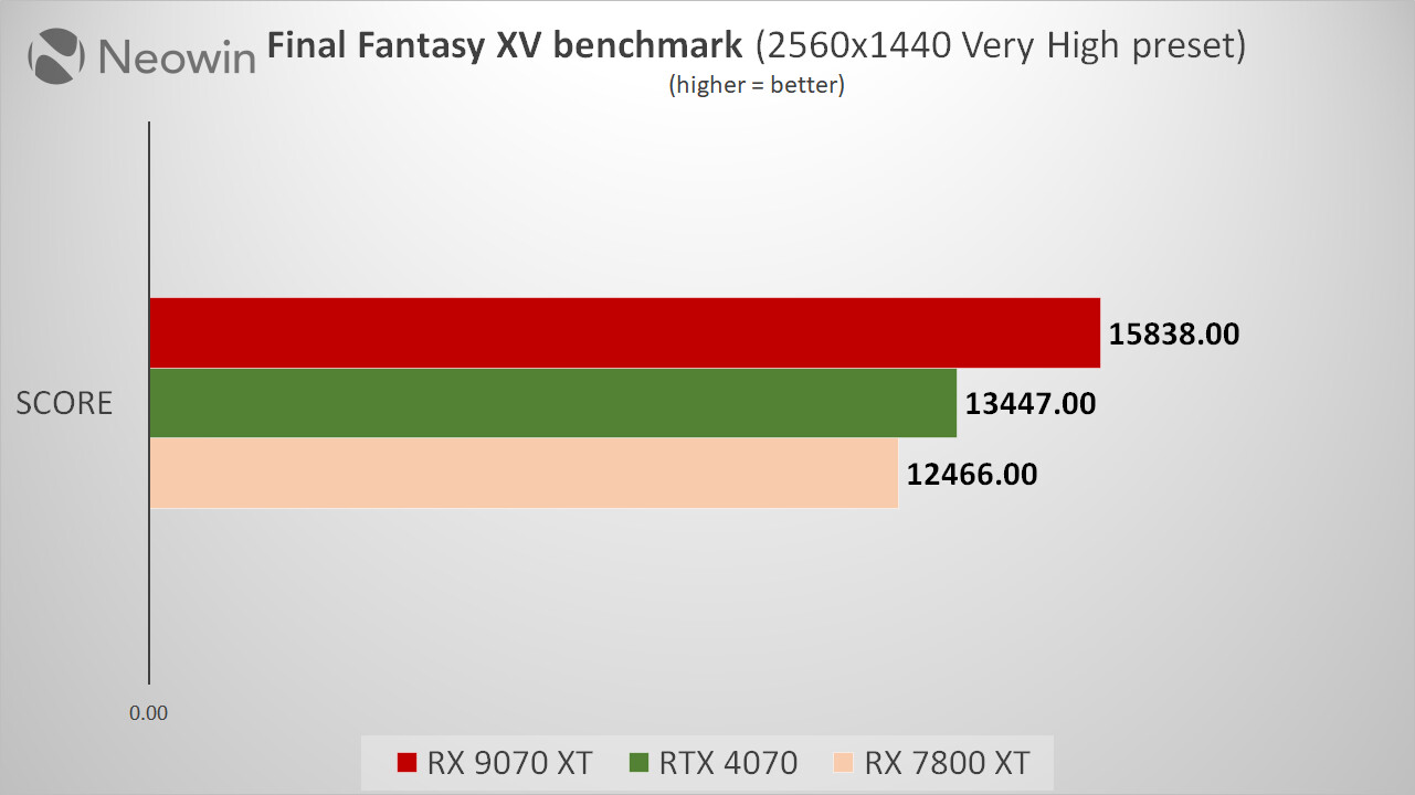

Following that, we have another 2016 title in the form of Final Fantasy XV based on Luminous Engine. Despite such a great start initially, the 9070 XT demonstrates a relatively poor show here as it is 'just' 27% and 17% faster than the 7800 XT and RTX 4070 respectively.
