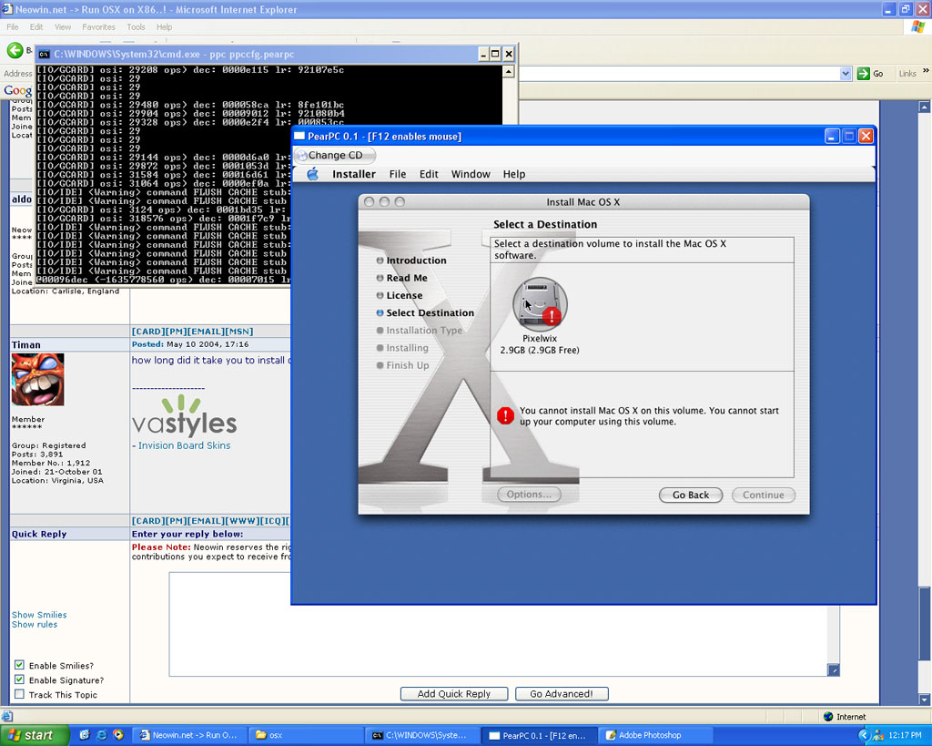

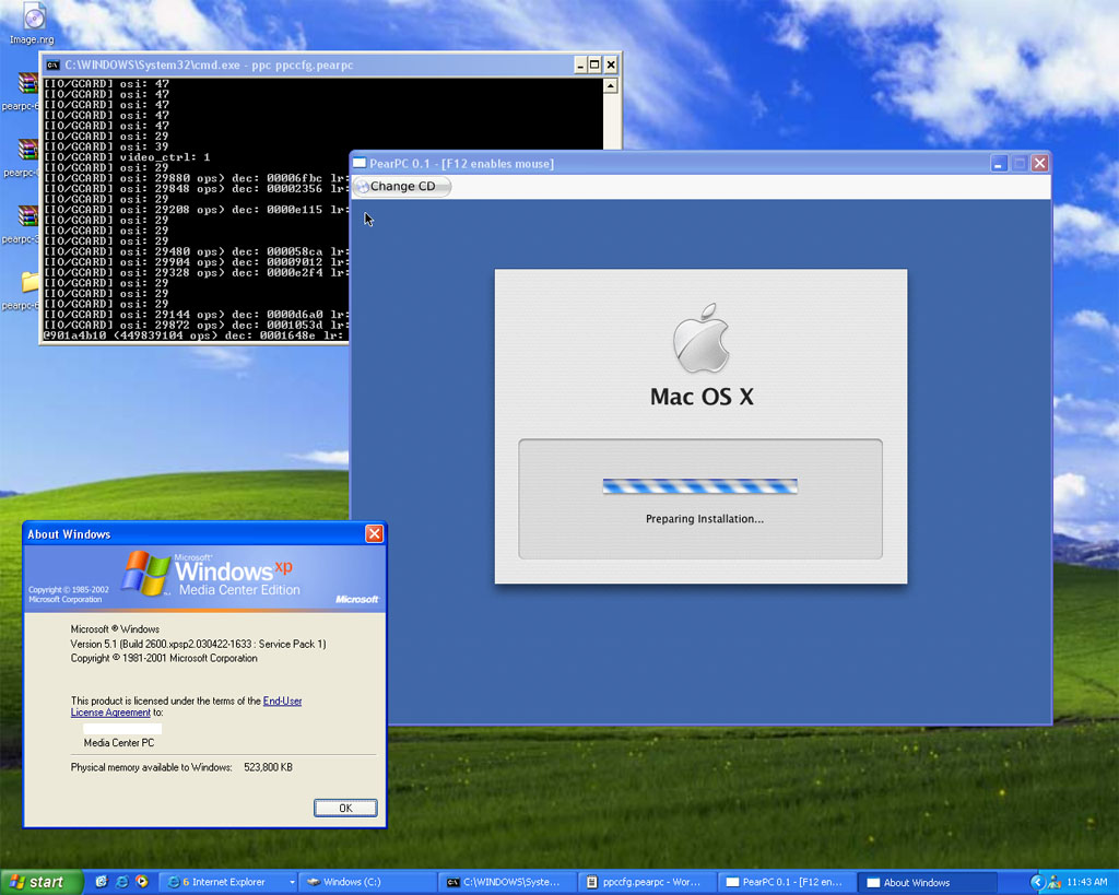

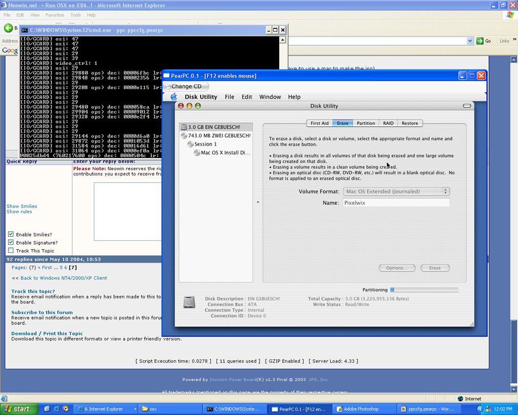

  • 0
# PearPC Configuration File
# Resolution
#	0: 640x480x8 (indexed)
#	1: 640x480x15
#	2: 640x480x32
#	3: 800x600x8 (indexed)
#	4: 800x600x15
#	5: 800x600x32
#	6: 1024x768x8 (indexed)
#	7: 1024x768x15
#	8: 1024x768x32
#	The indexed modes are unsupported.
#	default: 4
ppc_start_resolution = 4
# Redraw interval (in ms)
# must be between 1 and 999
# If you set this higher, PearPC will spend less time doing redraws (and so run faster)
# but feel less responsive. You should adjust this to your computer speed and personal
# preference.
redraw_interval_msec = 200
# Loader
#	Boot method
#   this can be
#   1. "auto", prom will boot the first bootable partition found (default)
#   2. "select", prom will show you a list of bootable partitions
#   3. "force", prom will load and boot the local file prom_loadfile
prom_bootmethod = "auto"
# Example of how to use "force":
#prom_bootmethod = "force"
#prom_loadfile = "test/yaboot"
#prom_env_bootpath = "disk"
#	bootargs: don't change unless you know what you are doing
#	machargs: set to "-v" to get a verbose startup
#prom_env_bootargs = ""
prom_env_machargs = "-v"
#	This is needed if you want to boot Mac OS X
prom_driver_graphic = "video.x"
# This will adjust the position of the initial page table (don't change)
#page_table_pa = 104857600
# CPU Config
#	Processor Version Register
#	Defaults to 0x00088302
#	Only change if you know want you are doing
#cpu_pvr = 0x00088302
# Main memory (default 128 MiB)
# must be >= 64 MiB
#memory_size=0x8000000
# IO Devices
#	PCI IDE Config
#	Drive type will be set according to file extension:
#  .img: Harddisk (filesize must be multiple of 516096)
#  .iso: CD-Rom
#	Or you can override this by specifying the type via
#	pci_ide0_master_type / pci_ide0_slave_type
pci_ide0_master_installed = 1
pci_ide0_master_image = "osx.img"
#pci_ide0_master_type = "hd"
pci_ide0_slave_installed = 1
pci_ide0_slave_image = "c:\osx.iso"
#pci_ide0_slave_image = "/dev/cdrom"
pci_ide0_slave_type = "cdrom"
#	Network (unavailable on windows)
pci_3c90x_installed = 0
pci_3c90x_mac = "de:ad:ca:fe:12:34"
#	USB
pci_usb_installed = 1
#	NVRAM
nvram_file = "nvram"
just so you know i have the panther cd made an iso out of it using disk utility (you have to use a mac to make the iso)
