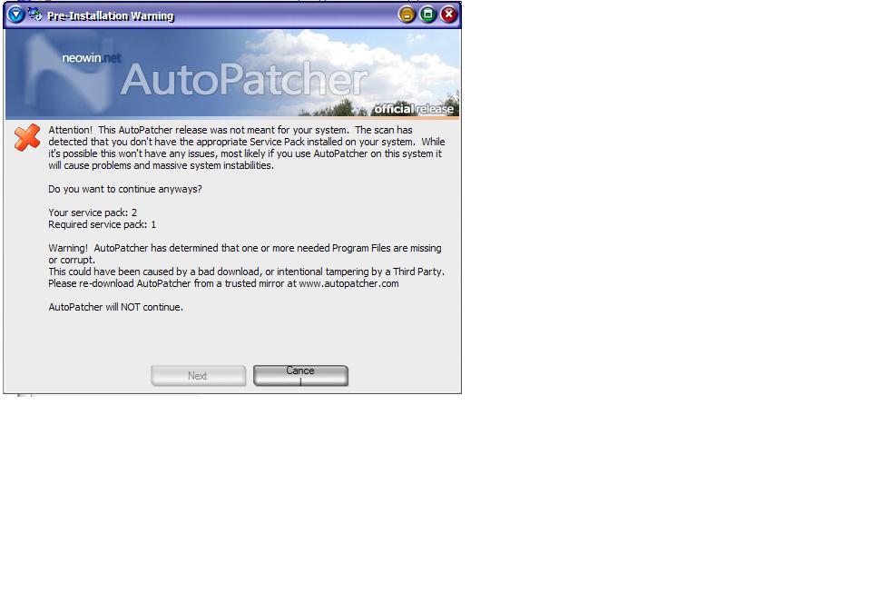

Sorry if this was already brought up, I didn't see it anywhere. But, I downloaded the full version.. from the first mirror, and installed it and it went to C:\autopatcher
Then I ran the Exe and it came up and said that It was for SP1, and that I had SP2 or something. I am added the pic as an attachment so you can see what I'm talking about. I thought this was mainly made for SP2? Did I get the wrong file or something? Thanx for the help.

Well, that link points to Jan2005 release... But in the screenshot, you are running an old release... Maybe you got confused somehow?
When the download finished, did you run the file? If so, did you install it with default options? It should be in C:\Program Files\AutoPatcher...

Yea, the name of the file that I downloaded was AutoPatcher_XP_Jan2005_Full.exe also.. weired
I am goin to try to download it again from another mirror. But about the MD5 thing, isn't there a way to check the MD5 of a file? A program to do it or something, that way I will know if it is the right file or not the next time I download it.
ok, I found a program that checks the MD5 of a file, It is called acutefinder.. and I have downloaded it again from another Mirror. I am goin to install it again after I get back from town. I will let you know if something is wrong again.. Thanx for all the help.
dreamon: I really have no idea what the problem could be. You could try this:
1. You got admin rights?
2. Under AutoPatcher folder, there's a bin folder. In the bin folder, select all files
3. Now, copy them over to your system32 folder (usually C:\Windows\system32) replacing any older files.
4. If the same error comes up, go Start -> Run and type (exactly as you see it):
regsvr32 "%systemroot%\system32\ssubtmr6.dll"
Again, Start - Run:
regsvr32 "%systemroot%\system32\comctl32.ocx"
And lastly Start -Run:
regsvr32 "%systemroot%\system32\mscomctl.ocx"
It *should* work.

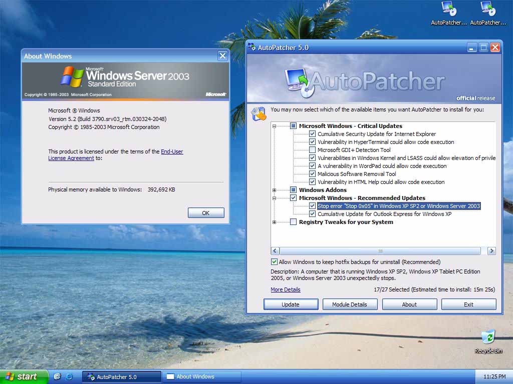

LovingU & Keldyn:
I tested AutoPatcher on Windows 2003 a little while ago. No problems whatsoever. Everything went as expected.
1. Installer started perfectly, installed normally.
2. AutoPatcher *started* perfectly, detected Windows 2003 Standard (English).
3. AutoPatcher loaded only what's available for Windows 2003 from the XPSP2 release (yes, some patches work on 2003 as well).
Here's the screenshot: Notice that some patches which only apply to XP SP2 do not show up. However, things which apply to 2003, show up normally!
