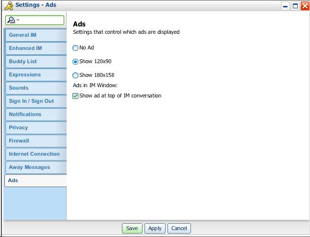

I have found a way to enable a hidden tab in the preferences, which gives you control over ads!
Instructions:
1) Make sure all AIM processes are closed first! Force them closed from the task manager.
2) Open "C:\Program Files\Common Files\AOL\AIMBeta\services\imApp\ver0_1_12\content\prefs\prefsContainer.box" in WordPad (DO NOT use NotePad, as it won't save properly)
2) Search for "TabAds"
3) Change the following line:
                <aolVerticalTab id="tabAds" collapsed="true" justify="left" label="Ads"/>
to
                <aolVerticalTab id="tabAds" justify="left" prefSetAttribute="collapsed" label="Ads"/>
4) Save file and open AIM. There will be a new tab named "Ads" in the preferences, allowing you to resize the adverts and even shut them off.
I'll upload my copy of the file. Just overwrite your old one with this and you'll have access to the hidden Ads control.
If this is not allowed, please let me know and take it down. Thanks.
prefsContainer.zip

I assume they left it there for corporate users or possibly were thinking about enabling it later.
I was very suprised to come across that, but extremely glad because the adverts are really distracting and ugly.

:woot: Any hidden settings to remeber the user name and password???
Nope no exploit on the username pwd yet. It appears in the code that the Ads tab was the only one that was hidden.
