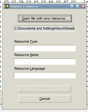

thanks, but yeah i seen that option before i posted.
what i dont understand is this (check image)
what do i enter into those boxes?
im trying to import the .ini file i saved and edited
cheers :)
cheers :)
586213880[/snapback]
RESOURCE TYPE : TEXTFILE
RESOURCE NAME: This would be the folder thingy name eg " ALPHA22_INI
RESOURCE TYPE: 1033
RESOURCE TYPE: 1033
Edit: Are you trying to replace the start button? Because your totally wrong if you are trying to replace the bitmap...
586213890[/snapback]
nope just trying to change the margins, thanks :)
(it worked, thanks guys)

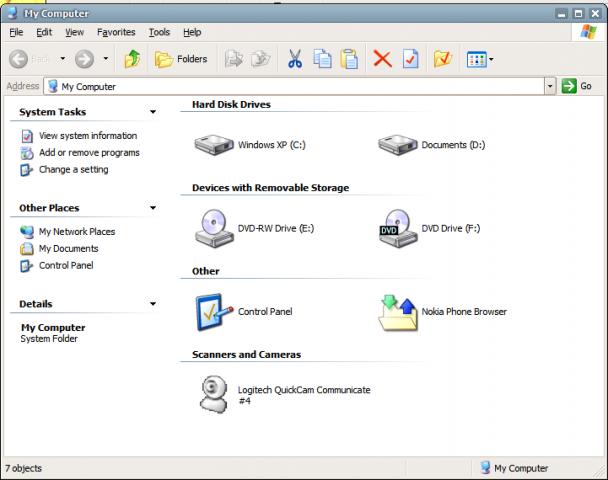

Shell style is perfect imho. If the left gradient colour matched the toolbar, it would look to dark and the gradient contrast would be too high.
I agree about the seperator, I'll dampen the colours a tad (Y)
586214581[/snapback]
I would make the shellstyle white (like i did in ClearLooks) or make a right to left gradient (white to toolbar color).
This color just doesn't fit in my opinion.

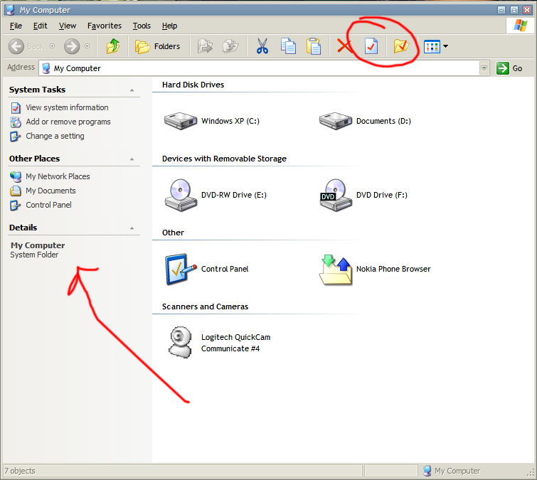

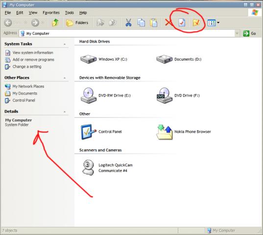

Schmoove: Nothing I can do about the 1px offset with 'system' dialogs. No idea whats going on with the WLAN page. Looks like shellstyle. I hate shellstyles, and hence, I will not be looking into that.

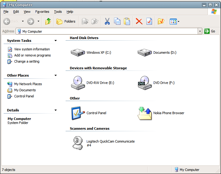

All white = too gordy, slight gradient breaks it up and points you towards the center of the window.
Yes, they are meant to be that long. The tabs are now final.
586214603[/snapback]

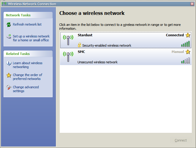

The WLAN thing is not the shellstyle. In StyleBuilder it is what they call the Explorer Bar. Last section in the sectionbar on the left.
And you can fix the systemdialog captions. You just have to make sure the image you are using for that caption is the same height as you set it under SysMetrics > SMCaptionBarHeight, plus you need to set the margins correct or else things can do all kind of crazy things.
Ok that is your opinion.... I have to disagree. I think a shellstyle as below works great.
