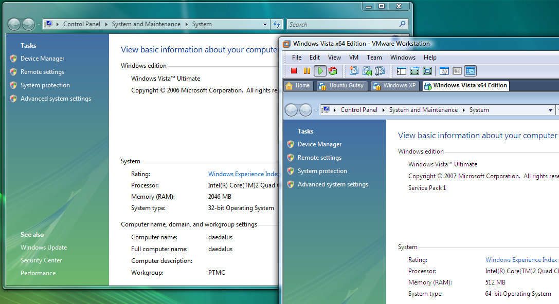

Eh, it is, but at the same time it kinda isn't, since I will probably have to be seriously using X64 before I start working on it. VMware doesn't seem to want to run it in a VM on 32-bit Vista, so I have to use it as my main OS, even to just test stuff on it in a VM.
Yeah, I don't know WTF I was doing, it was complaining about not having VT support; it's working fine now with 32-bit host and 64-bit guest.
