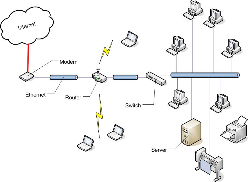

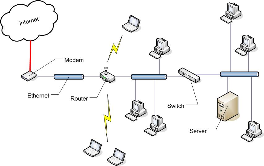

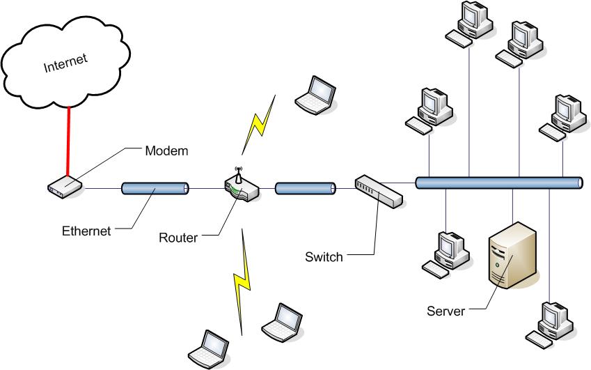

In a nutshell this is how your network should look.
Lets get it looking like this with each machine only having 1 connection to your network, and the one switch.. With you knowing which cable goes where, etc.. And then we can move forward.
All computers could be plugged into your 1 switch or the router switch ports.. Depends on where they are located, etc. The only reason I can think of why you would need more than 1 switch would depend on layout of your machines.. But from what I recall your switches are right next to each other.. So you only need 1.. And I would not suggest you connect anything to your router either -- unless location of PCs mandates it.. So should prob look more like this.
Here I added some printers/plotters -- so now it should look pretty freaking close to your network ;)
