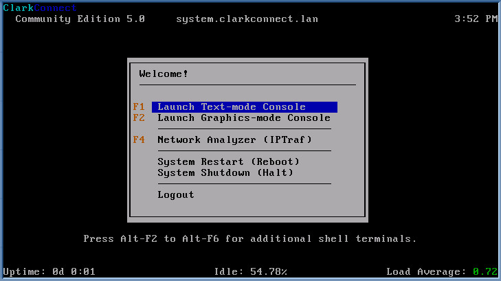

You have no need to launch the text mode!! When you get to that part -- you need to connect to the box with your Browser from another machine..
You finish the config using your browser from another machine.. Sounds like your trying to login into the console -- you only configure network there, etc.. used in case of not on network can not use web browser, etc.
This the screen your see?

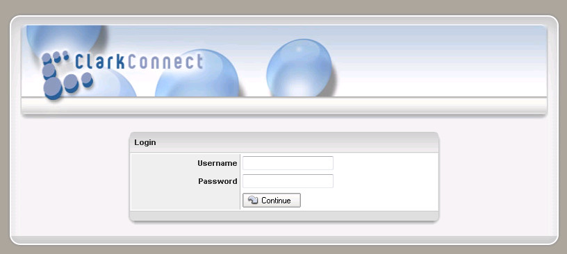

You need to open up the IP address of your CC from another machine -- its CLEARLY gone over in the guide.. Which you clearly have not even breezed though!!! :argh:
When you open it up in your browser you will get a screen like this
Dude as soon as SG Universe is done I will step through the setup for you.. But as sophism points out you need to go the IP of the CC machine -- really, Danny its not possible to be that dense -- is it????

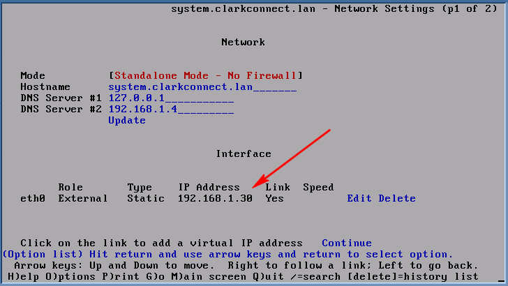

What IP did you give the CC machine when you setup it up, or if you set it up for dhcp.. Which Im pretty sure I stated it would prob be better to setup static.. But anyway.. If you log into the text mode on the console -- it will show you what the IP address of the CC machine is.
To log into the text mode you need to put in password of root, and then hit enter twice or tab over until continue turns red, then it enter -- then you will get this screen
I set it up so it's all automatic, I did not set anything specific. I tried what you said and could not get to that page. i boot up the machine i enter my root password and press enter. Then i get the options launch text mode graphics etc... when i click launch text it just says looking up localhost:82 then it says it cannot be found and it gives me 127.0.0.1:82...
After I typed /admin in the url i finally got it to work!!! This thing is freaking awesome. So far i got my webserver up email's everything!!!! :).

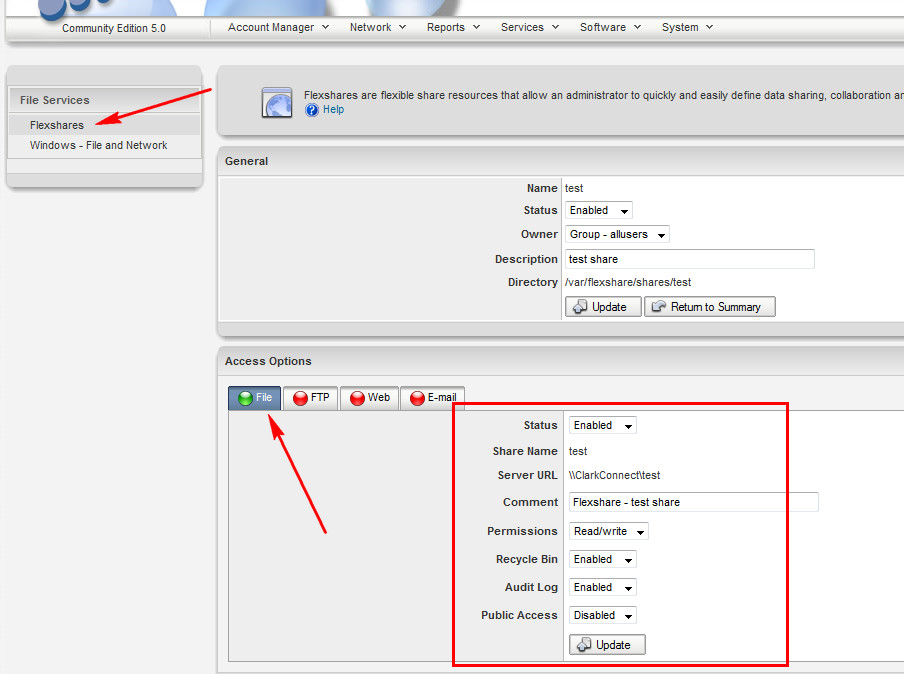

Without something to work I can not tell you what to change -- did you create that share in flexshare? Can you post a screen shot of flexshare in CC?

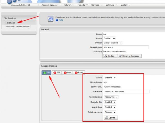

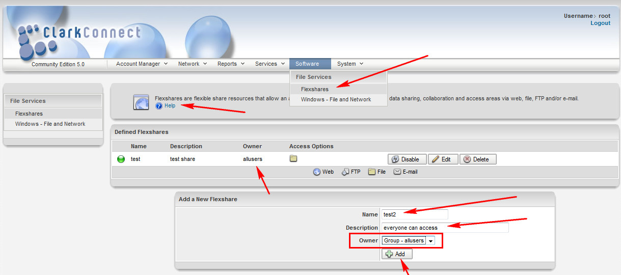

Do you even have Flexshares installed?? This is where you would create shares that everyone can use.
Danny I really really want to help you -- but your LACK of doing any thing on your own is starting to get very frustrating.. The product is very well documented, there are howtos for this howtos for that a great forum section, etc.. But seems you can not be bothered to read even the a few words of the documentation. Well NO F'ing **** your going to have issues if you dont RTFM!!
Here is creating a share that everyone can access

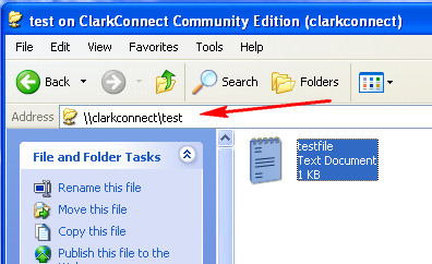

Here is accessing said share from a machine that is part of the domain and with a domain user account that is a member of the allusers group.
