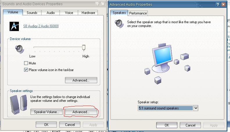

neone who has these... i cant get center channel to work in the "6 ch direct" mode.. it only works in PLII which sucks teh balls.. also im not using digital/optical cuz im limited due to only having audigy 2 zs
585079101[/snapback]
Use 6 channel direct, and go into your audio config panel and change the speakers to 5.1.
I have an Audigy 2, so it's directly the same for the ZS. Just go into speaker settings and set it to 5.1, or just do it the easy way - Go into control panel, sounds and audio devices and copy this. :p
I love my paint work :ninja:
