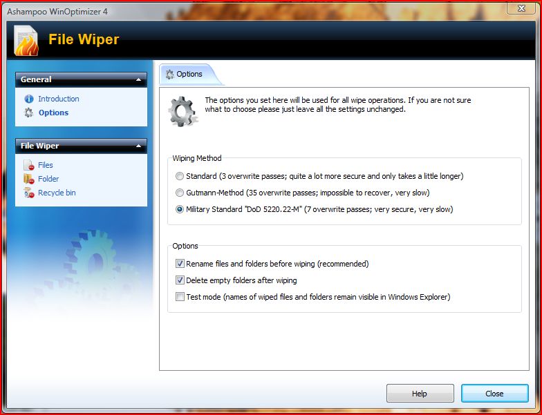

yo check what i found... very nice!
Ashampoo WinOptimizer 4
From Cnet.com
From Cnet.com
comes with "One Click Optimizer"
Also "Defragmenter"
