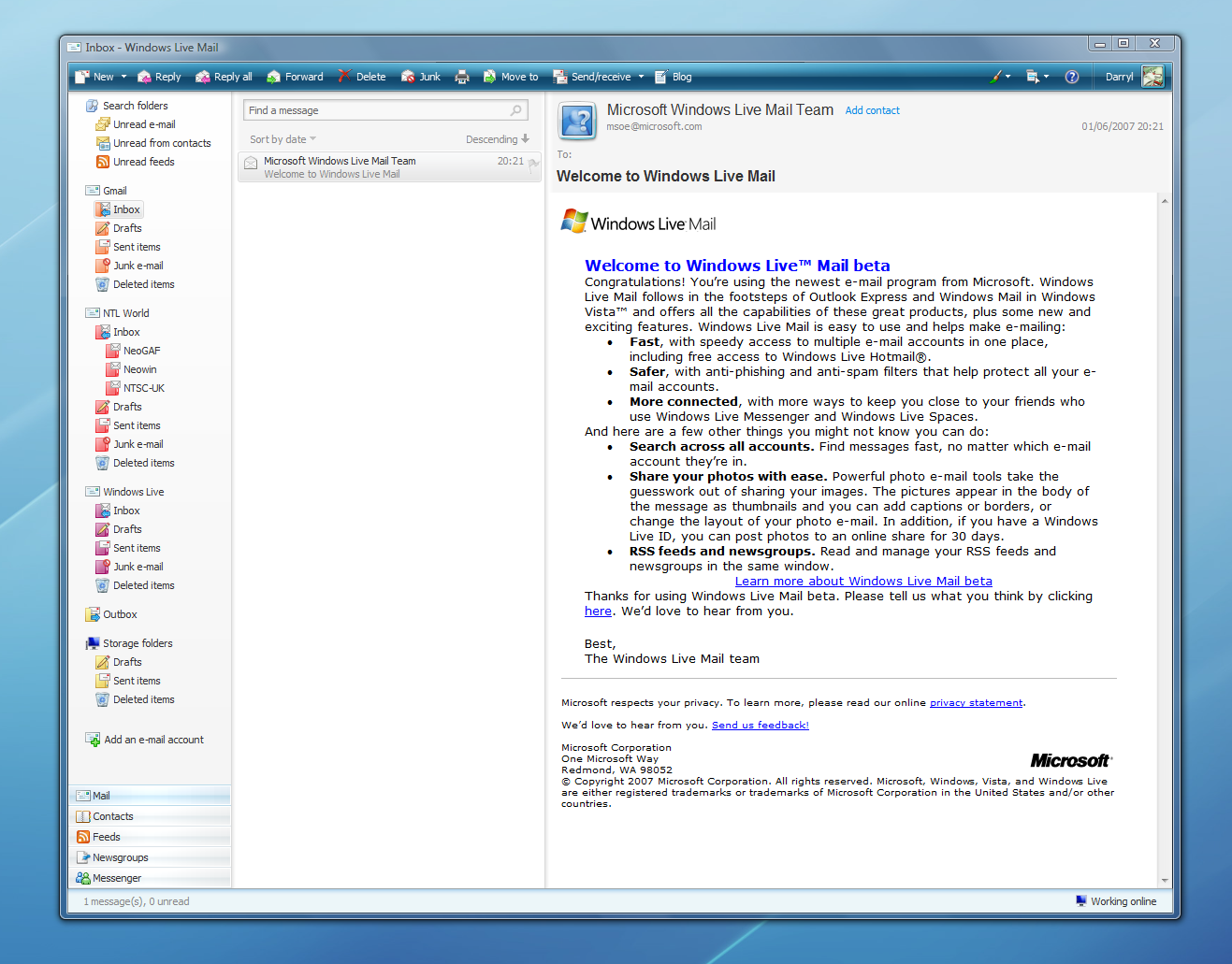

Windows Live Mail is actually pretty nice, it's a lot better than Windows Mail (imo). I've actually set it as my default mail client over Outlook, we'll see how it goes. The layout is nice, integration with messenger is nice. As is the integration with blogs (although I won't use that aspect). Pretty nice.

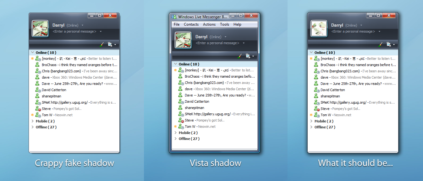

WLM is ok, does the job and it'll be my default client. There is one thing that annoys me (petty I know) but the shadow on the window without the frame on Vista has a crappy shadow. Should've implemented a proper shadow.
Just a shot of WL Mail:
Not bad...
