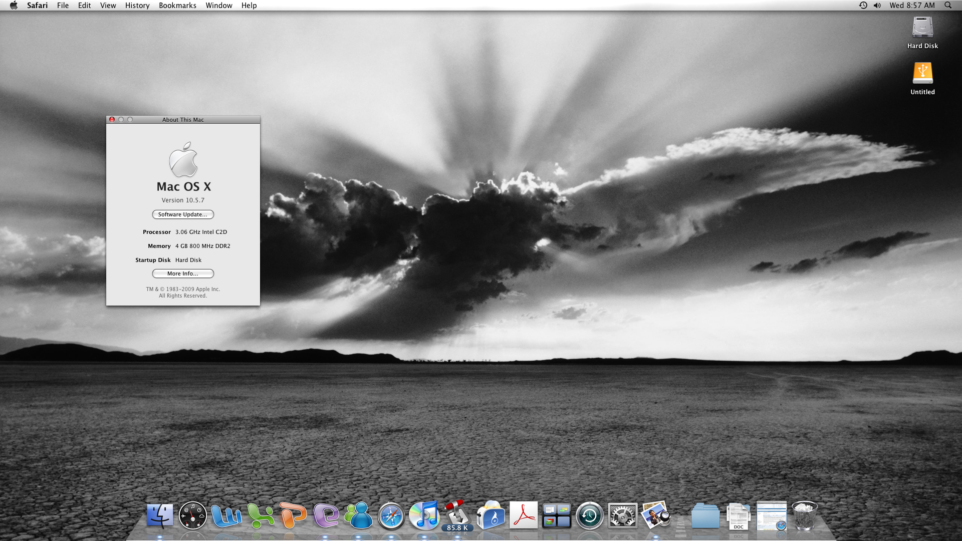

Here's a screenie of my system up and running:-

Everything hardware-wise works. Everything I need software-wise works too. Just like running a normal mac. Of course, I'll be able to get a better guage once I've been using it for a while. The one thing they warn is to disable automatic updates because it is possible that they kill certain things until workarounds are developed. But so far so good.
