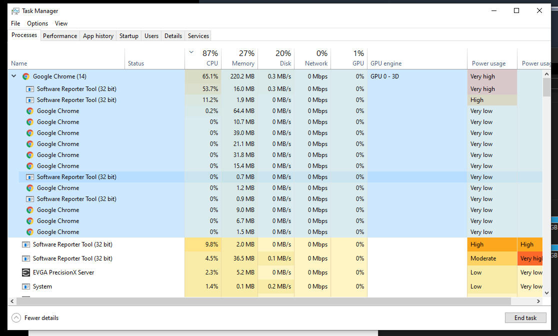

I was just monitoring the processes while trying to get it to repeat and suddenly 'chrome - software reporter tool' showed up 6 times and pegged my CPU and the power usage level went to very high stayed there for a few seconds then stopped. Could this be a suspect? As for getting a video I have never tried it.

Here is what I was talking about with Chrome and the software reporting tool.
Possible, I've seen that process bring some systems to it's knees. I've removed chrome from a few of my machine's because of it. That software reporter tool uses a ridiculous mount of cpu.

I doubt it because you said in a previous post it was happening on a clean install with nothing else yet installed.

No, you are correct I had not thought of that. Either way I disabled the tool to see if it helps.
Yeah I am curious as well why yours is showing 32..
I just fired chrome up.. And it showing as 64 on my system
What version of chrome are you running?
Google Chrome is up to date
Version 76.0.3809.100 (Official Build) (64-bit)
I am using the 64 bit version. copy and paste from Chrome: Version 76.0.3809.100 (Official Build) (64-bit)
