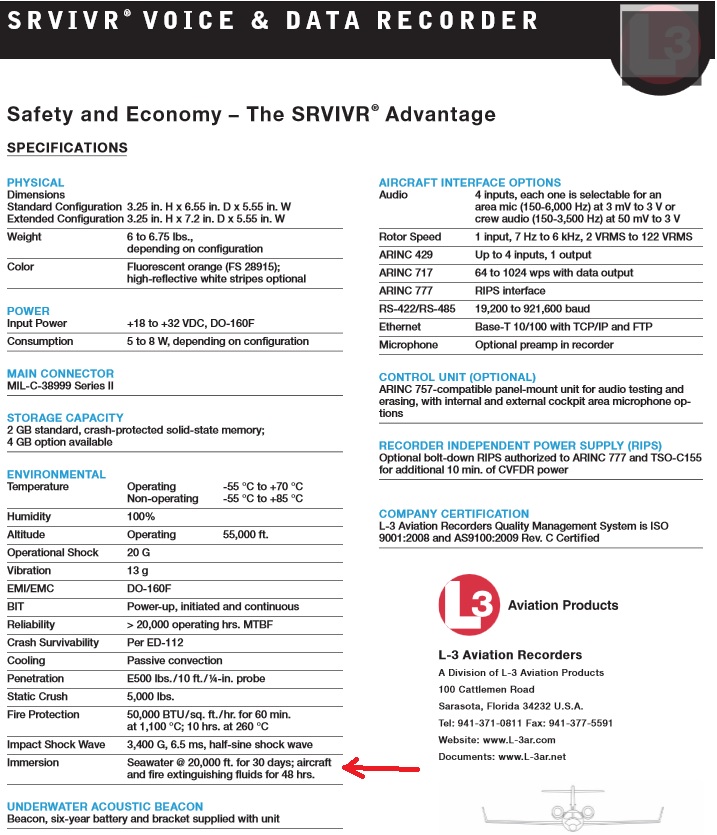

Ka-pow ... straight from the horse's data sheet:
http://www.l-3ar.com/pdf/datasheets/MKT068-AP_SRVIVR_12-12rev4.pdf
Skiver, you just got owned :laugh: and I usually don't say that!

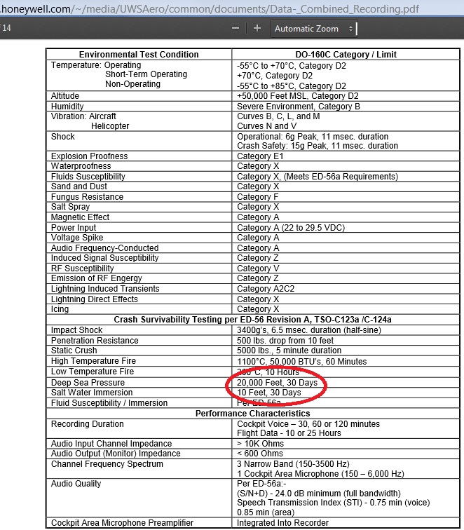

Apparently flight MH370 carries a Honeywell 'Black box', and 30 days is the standard:
http://aerospace.honeywell.com/~/media/UWSAero/common/documents/Data-_Combined_Recording.pdf
Am I reading it correctly that the black box would be useless if it did crash in salt water after 30 days in 10 feet of water? The area where those objects were found as an average depth of 3900 meters, way surpassing that limit.
unless I'm mistaken, I believe it's to do with salt water corroding parts inside, so partly yes, though bonalste might be a better person to ask, as he has civil aviation knowledge
(if you needed more covert, then I'd recommend McKay)
i think it means that the minimum is 10 feet (that's the test value), but it can sustain 20k for 30 days in deep sea pressure.
