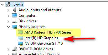

Example - here is mine showing my discrete card, but nothing more - but I for sure have onboard, since was just using it when my old card died ;)
If you have been messing with it for this long - what would be the big deal to pull the video card and test with just onboard ;)
edit:  Here I just did a show hidden and now see my old card, and the onboard.. the highlighted is my old card that died, and the HD is the onboard
;) Both your old card and iGPU are "HD"s lol 😛 BudMan meant the Intel HD 😛
