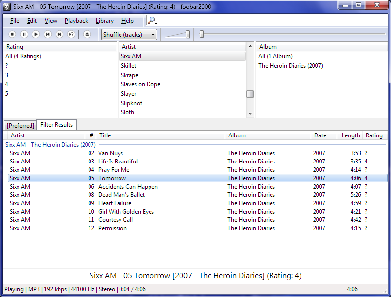

mine:
@xinox, you can use [] around your title formatting to hide anything that isn't set. for example, in your rating column you could use
[%rating%]
instead of seeing a "?", it will be blank. you might prefer the "?" but i thought i'd mention it. :p
now obviously you wouldn't want to use that in your filter panel as it would hide all your unrated music. but you could use this instead...
$if2(%rating%,Not set)
[%rating%]
