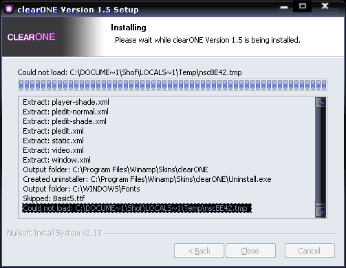

Shof Posted July 15, 2006 Share Posted July 15, 2006 Wont installl: Link to comment Share on other sites More sharing options...
