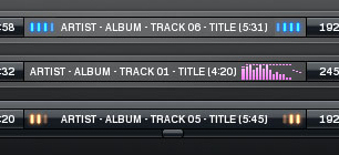

Is there an effect over the title area of these first two examples? I cant seem to reproduce that little part. Maybe just an illusion?
To me it looks like the piece of plastic that you would find on that area of a real piece of outboard gear. Like its a little foggy?
If its not really there, I think that would look pretty spiffy as an addition.

Is there an effect over the title area of these first two examples? I cant seem to reproduce that little part. Maybe just an illusion? To me it looks like the piece of plastic that you would find on that area of a real piece of outboard gear. Like its a little foggy? If its not really there, I think that would look pretty spiffy as an addition.
This is what the background looks like for the ClearBG style. Is this what you mean Ecat? There is a gradient highlight in the middle which disappears towards the ends.

Yea that must be it Axialix. I have it stretched out all the way across my the top of my desk so its not as effective as in you examples.
Is there an ini file or the graphic file itself that I could tweak to try and create more of the effect that Im talking about?

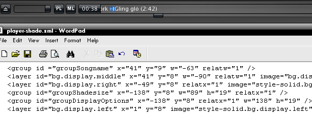

One other thing. It looks like the text is being painted or rendered above the bg-display-middle.png. Is there another tweak that would throw it behind it?
Or maybe a way to adjust the opacity if the font? Allthough I would imagine that would probably affect the counter and the KBPS too. But that might not be an all together bad thing.
Hope Im not bugging you with all of this. :D
No problem, glad to help Ecat. To get the text to appear behind the bg-display-middle, you'll have to rearrange a group in player.xml. Take this line:
<group id ="groupSongname" x="0" y="0" w="-63" relatw="1" />
and place it above this line:
<layer id="bg.display.middle" x="41" y="8" w="-90" relatw="1" image="bg.display.middle" ..... />
You'll now have to fix the x and y values for "groupSongname".
Alternatively, you can set the Songname alpha to 100 or any value you like by changing this line:
<text id="display.songname" display="SONGNAME" ...... align="left" alpha="100" />
And don't forget to also add the alpha tag to:
<text id="display.actioninfo" ...... />
This will not affect the Songticker (time) and KBPS.
Allright, Im getting closer. Adjusting the y axis is working fine but changing the value for x isnt having an effet on it. Ive tried positive and negative values and it doesnt move it at all.
Here what its looking like. The word hiding behind the ticker is Bj?rk.
Oh yea, you must have meant player-shade.xml. In case any one else is using this stuff.
