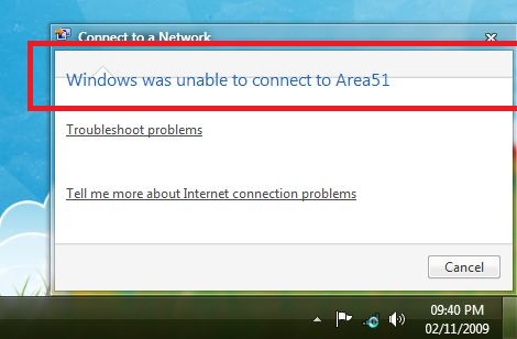

@ Deathknight74: Yeah, that was a hackish implementation that worked in most places for me but that one never did. I'll set it back to the regular look (without the arrow).
@ mike45: Yeah, that's the problem with Windows and some inconsistencies which of course do not show up on a default theme. You have people who inherit text colors from another place, and then you have Microsoft who decides to use the body text color for the AeroWizard titlebar (black again in my theme -- you may have seen this in the network setup), and then you have programs that render their own glow around the titlebar text.
Right now, the 'shadow/glow' behind the text in Explorer and most programs is an image.
I wish Microsoft would just render this part to conform with the text as it does in MS Paint.
Some of their programs seem to ignore the glow colors and such.
This is one reason why I'm going to release a black text on white glow option. To many inconsistencies with how Microsoft renders this area.
Two reasons which tie into each other :)
