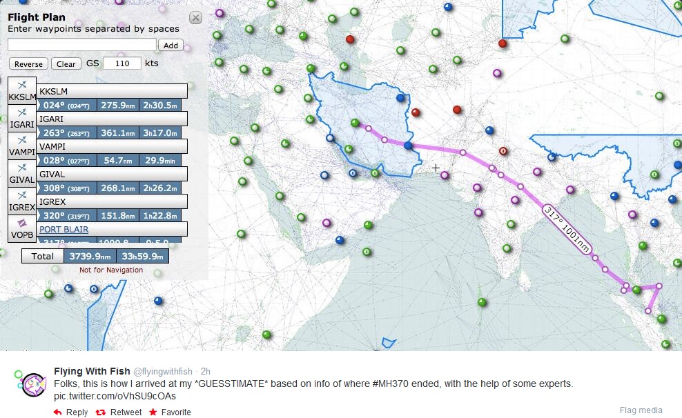

Google maps puts that last way point inside Iran, Isfahan specifically:
https://www.google.co.uk/maps/@24.3362325,70.9525826,4z
If it is to believed, surely the flight would have been picked up on radar by at least a few of the countries it flew over?
  • Like 1
Not necessarily, the radar over there isn't nearly as sophisticated as the radar systems we have in the west.  It's entirely possible that India, Pakistan et al would have completely missed it if they weren't looking for it.  Hell even Afghanistan probably missed it and there's US bases all over that country.
Plus if that trajectory is to be believed, you can clearly see that they very carefully avoided flying over Afghani airspace.
