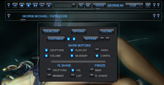

@chode ... how do you get the second window under the main window? and how do you get rid of the repeat and shuffle buttons on the right of the main window. I could do it with the beta but not this one. >_>
I just drag-and-dropped it there. Then I disabled a lot of the buttons under the CF windows second customize button.
Here's a screenshot of my settings:

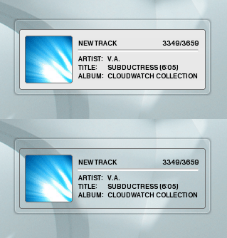

The text shadows have been fixed (yours too Barisko :)), but I haven't released the new version yet. I've got a small bug with a new Notifier animation mode that I'm trying to get rid of, but as soon as that's done I'll release it.

Finally, I do appreciate your comments, and you've given me a lot to think about. I'll leave you with a shot of the new notifier (opacity will be totally adjustable :)).

Here's a short changelog:
  • Text shadows option added to CF window.
  • Shadows removed completely from clear style.
  • New Roll Up/Down notifier animation added.
  • Notifier Opacity option added.
  • Notifier text rearranged to better fit bevel.
  • Fixed PL ClearBG Vis cpu usage (honestly, it's fixed this time), just only for the OFF mode. Still uses tons with the Vis ON and I can't figure out why. :(
  • Glass and ClearBG styles set as default.
:cool:
