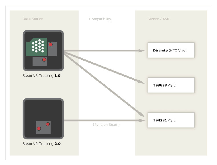

SteamVR Tracking 2.0 rids itself of the stationary LED array that, per Valve, drove manufacturing costs significantly higher. Instead, the new base stations rely on just the two spinning active laser emitters – which can now encode and transmit data within the laser beams. This allows the VR headset and the controller to learn about the source of a laser beam and significantly reduces interference between base stations.
With reduced interference, SteamVR Tracking 2.0 can now support more than two base stations, allowing users to create a larger VR play area – perhaps even spanning multiple rooms in a house. Since the new base stations rely on fewer components, they can be smaller, lighter, quieter, consume less power, and most importantly – cost less to manufacture.
Unfortunately, there is a slight issue: SteamVR Tracking 2.0 base stations are not backward compatible with older VR headsets like the HTC Vive. However, the newer headsets – like one being developed by LG – can work with the older base stations, minus the new features.
